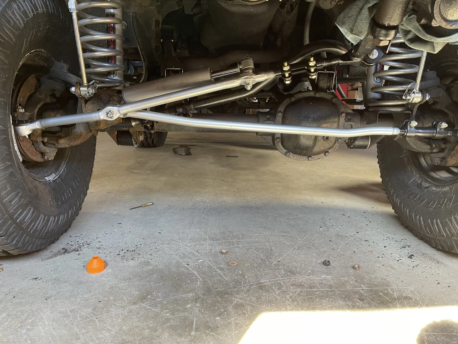

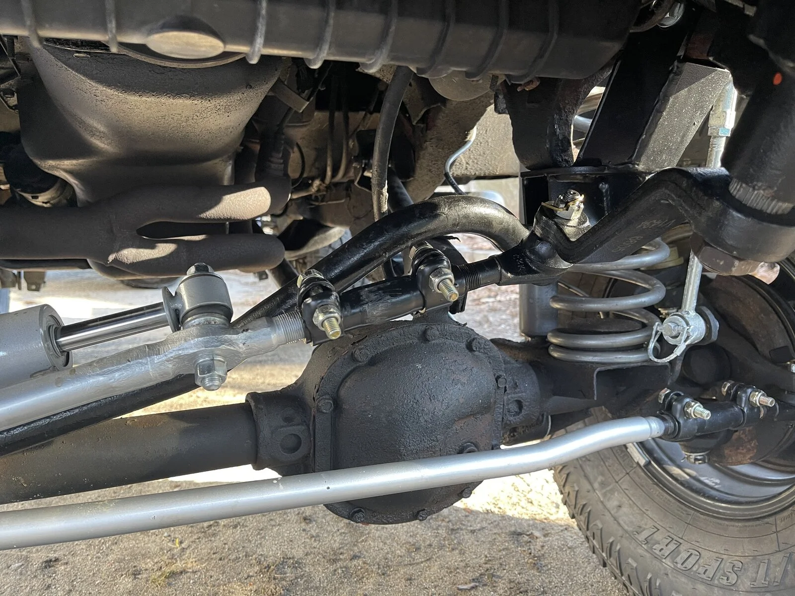

Ok I have a lifted tj and a wandering issue. I have a brand new rc adjustable front trac bar but when I do a dry steer test it moves left to right about 1/4 inch??.., it’s got rubber bushings but they are new.. the other side connects to the drop bracket. I have a 6 inch lift in my Jeep so I run a drop pitman with the drop bracket. It’s drives good and I like it but this wandering has got me stumped..

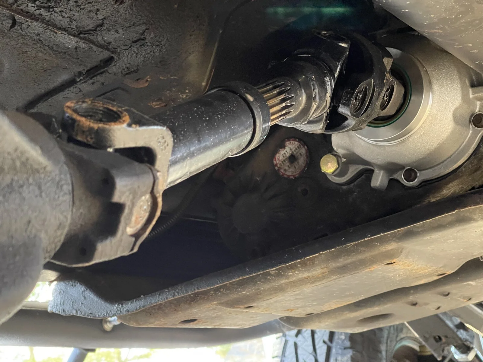

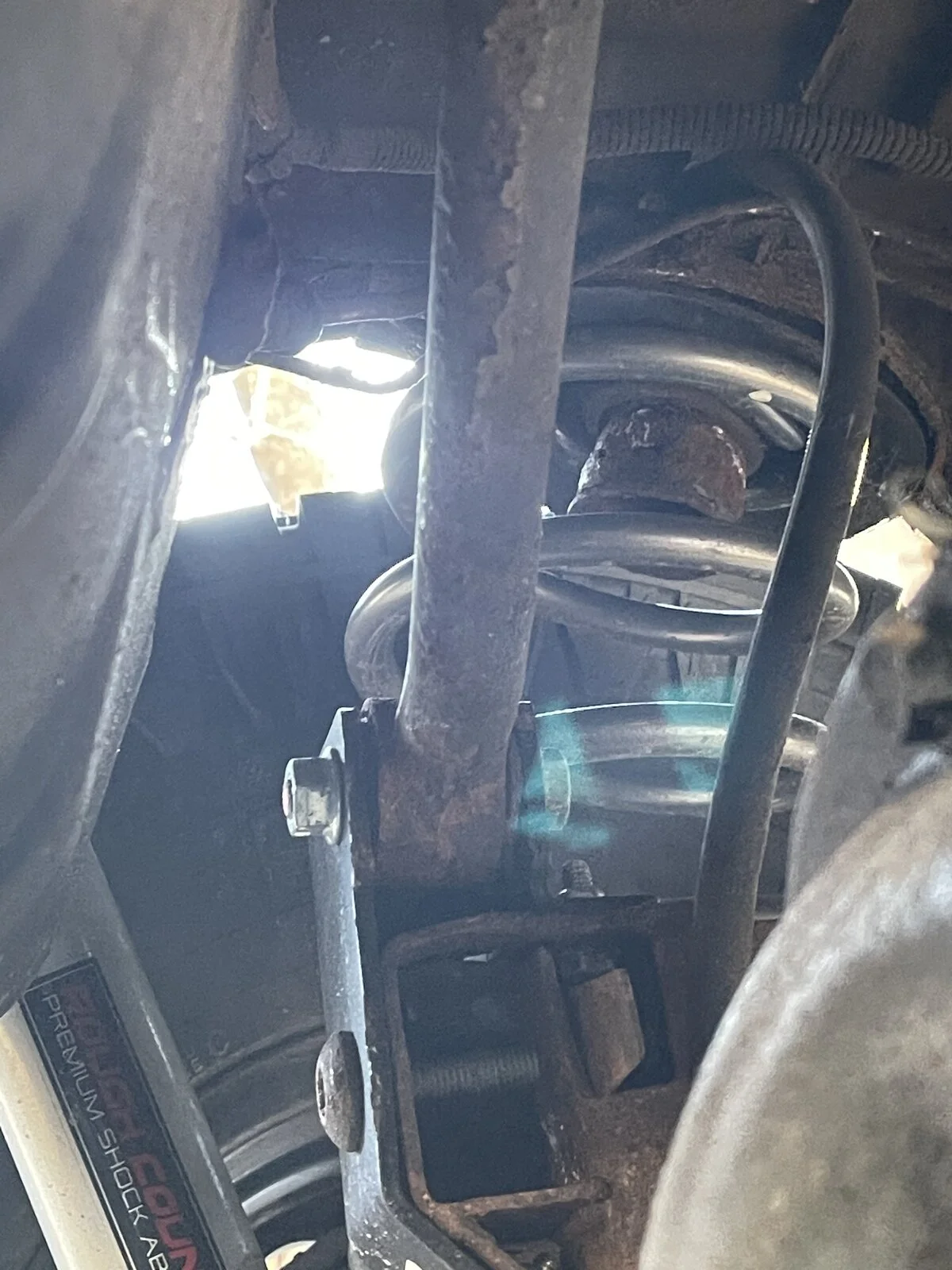

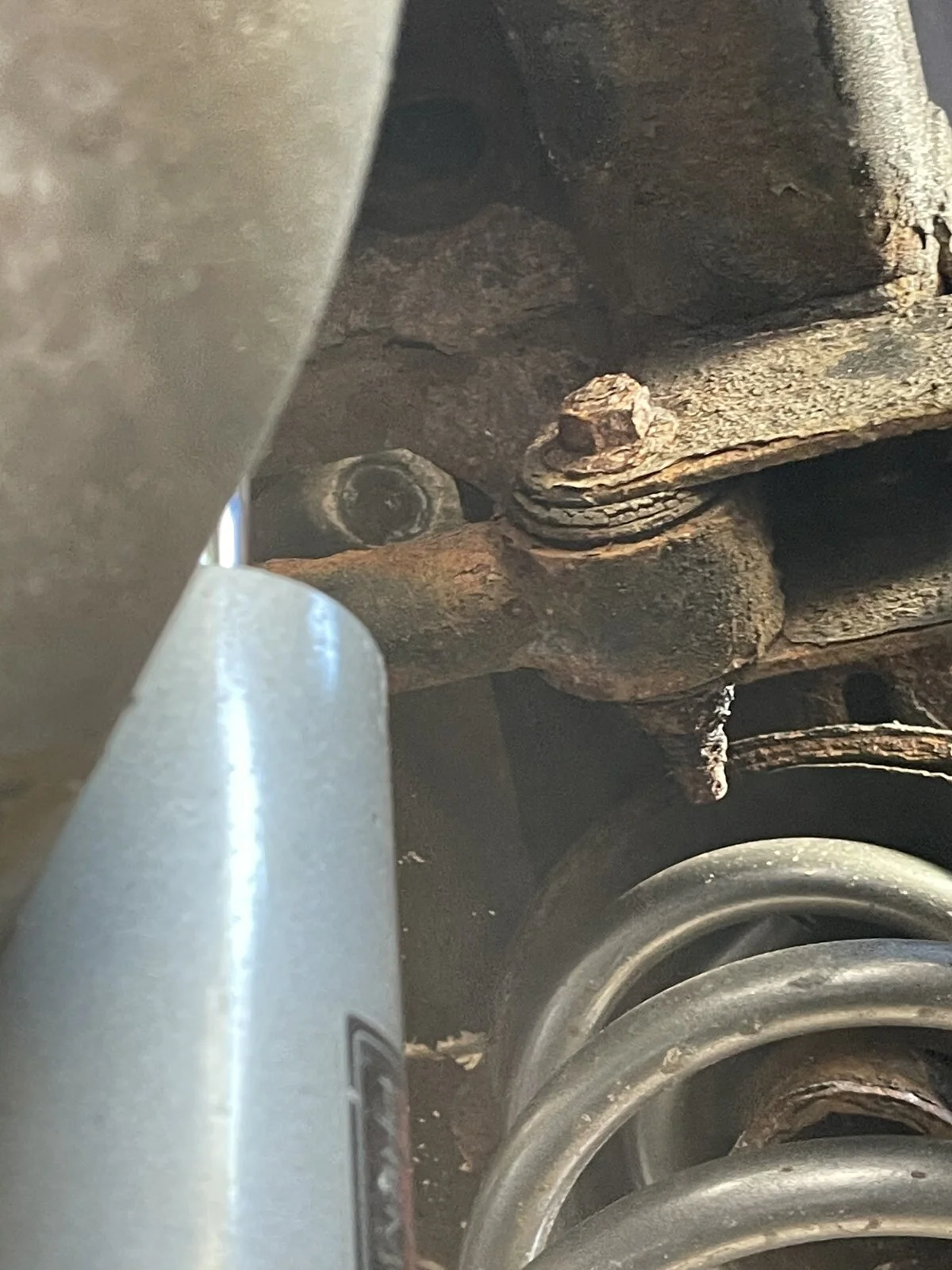

rear TB looks beat the frame end bushing is toast, so the other end is too probably........ is that bar adjustable?
those bushings being bad might account for some of the fishtailing or loose rear you describe.

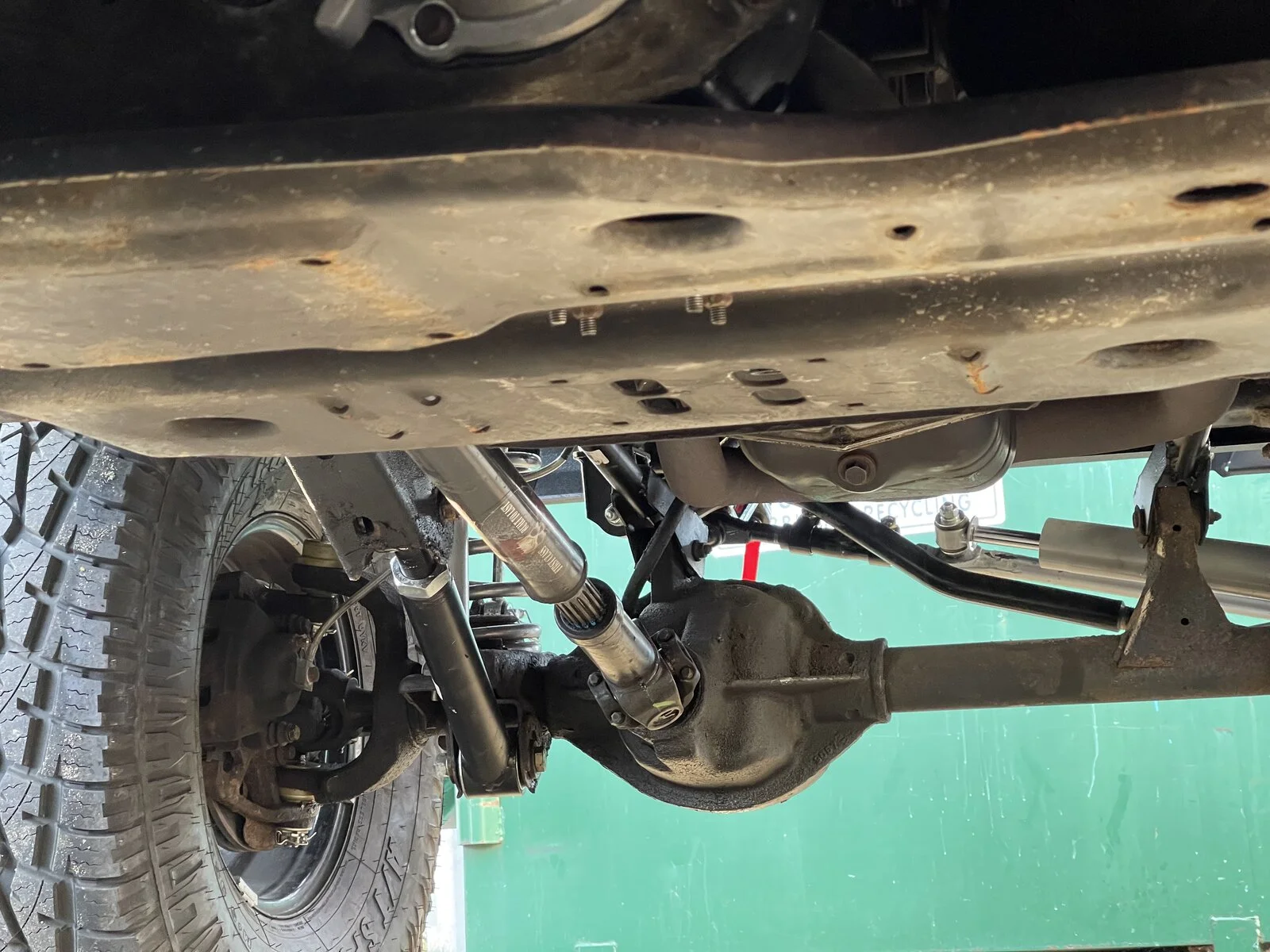

It looks like that axle is rotated backwards with that perspective.
Like the bottom pf the springs are aft of the tops. Combined with 6* of caster I’d sugest rolling the pinion up some to start with
Yea these pics were in my phone kus I’m at work now. Since then I’ve had it alighned so the springs are straight now but I’m definitely gonna take a video around 5 pm today to show u where I’m at.. I really appreciate the help . Thanks to everyone.. I’ll post up the video later..
