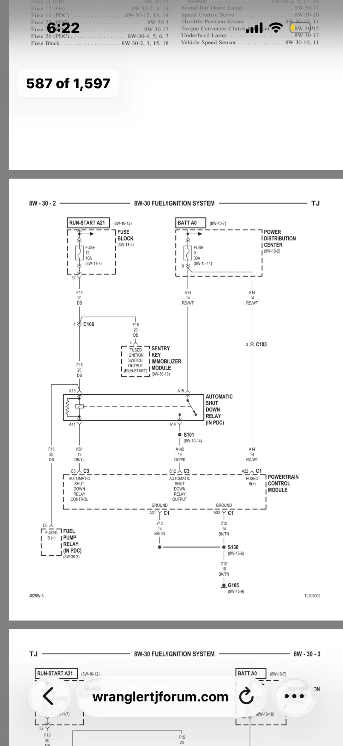

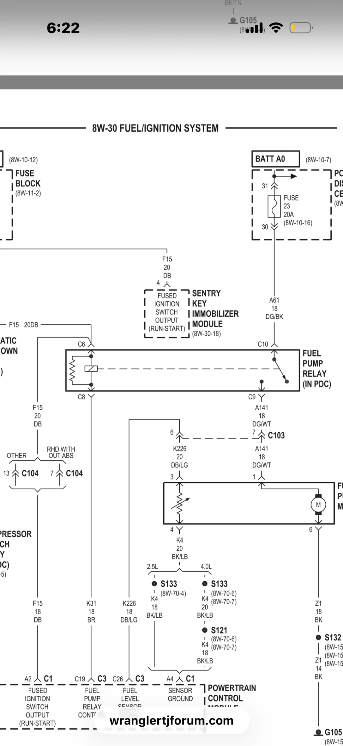

I’ve fallen down the rabbit hole of a small issue that’s not so easy to find to begin the story I was driving along the highway the jeep dies and I immediately run through my fuses and relays swapping them out but no luck my mind instantly jumps to fuel pump considering it had no pressure in the rail… I replace the fuel pump still no power to the pump when ignition is switched on thankfully for @macleanflood we have been slowly diagnosing the issue thankfully his expertise has came in very handy as I’m still a young grasshopper basically at this point we sent 12v into old pump only to find it still works immediately after that we sent 12v into the new pump for a few seconds finding out it works as well ! The jeep even started up for a second which is cool to see !
Now we are working on jumping the fuel pump from the relay another input would be great thanks !
Just wanted to update everyone after a small bit more of trouble shooting I think me and @macleanflood have discovered the issue it was nice having him on the phone guiding me through the maze haha but I thought I would list the things that helped me figure out the issue AGAIN 2002 WRANGLER YOUR YEAR MIGHT NOT APPLY

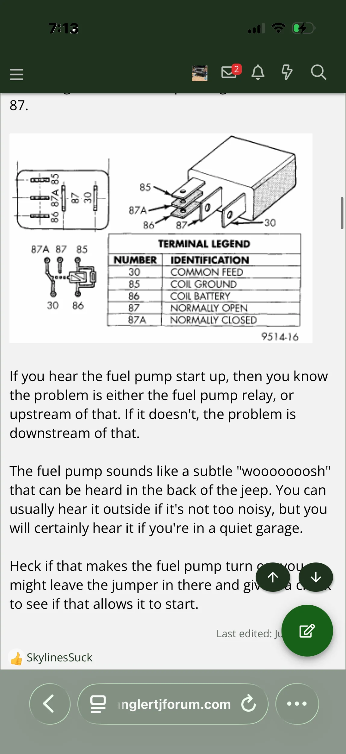

3. If all this fails jump the fuel pump using the relay pin 30 and pin 87 I’ll post a picture for anyone wondering
4. If the fuel pump kicks on you know your problem is upstream vice versa if it doesn’t you know it’s downstream now you have narrowed down your problem hopefully this helps !
