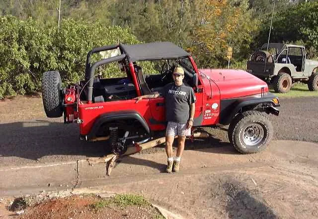

That climb is typical of events that can cause Dana 35 breakages, especially if there was any axle bounce going on. It's simply not a robust axle, its smallish diameter 27 spline axle shaft likely snapped right at where it enters the differential's side gears which is at the base of the splines.
