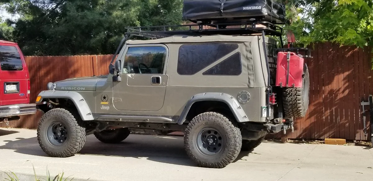

BTW - just last week I let slip under my nose, a pristine '06 LJR (in my favorite color: Light Khaki Metallic) with 89K miles, 3" quality lift, ARB front and rear bumbers, quality winch, nice LED auxiliary lights, and truly in near-mint condition (dealer was asking $21K). It sold very quickly. I wasn't in Search Mode yet, and couldn't pull the trigger. Oh the agony....:cry:.
