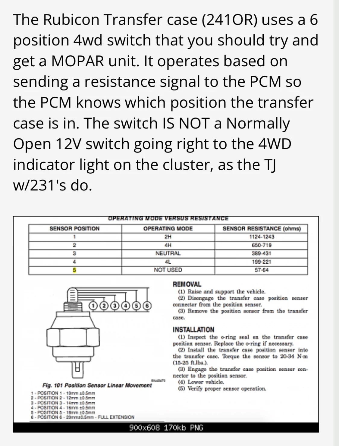

Ok just pulled the new switch back out and bench tested. According to the attached diagram, the switch I have has the correct ohm readings in all of the positions. I put back in and ran a range of tests from just a few turns to all the way torqued down with no light. :(
Last thing I can test is the wire and plug that attaches to the switch. Are you sure I can just jump the two leads together and I should see the 4WD light come on when the ignition is in the ON position?

So I’m catching what you’re saying about IS NOT normally open 12V. When I tested the switch fully extended (pin all the way out) it registered 0 ohms. I ordered another switch from rock auto that specifically says it’s for the RocTrac and it’s Mopar.
