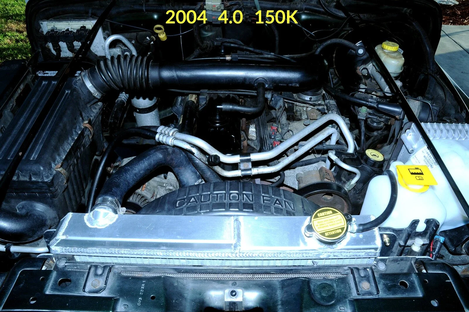

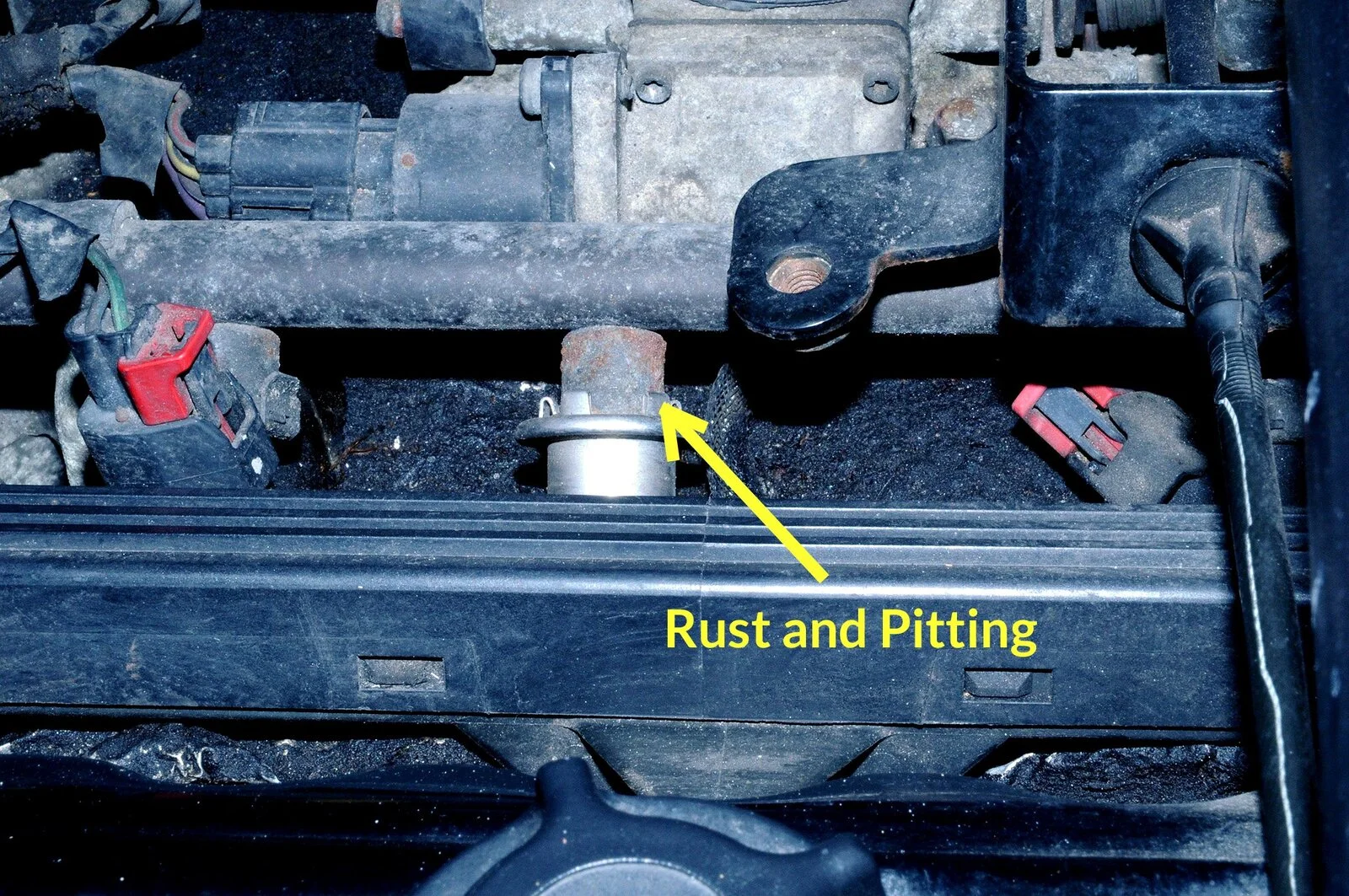

Hi Gang
I have a 2004 Wrangler 4.0 - I've read a commom problem can be RUSTED Injector Rail Inlets (as seen here in a wide view).
Or here in a Close Up:
Is it safe/wise to brush a light coat of Rust Buster directly onto the outside surface of the port section? The corrosion includes 'Pitting' as well .......
Thank You
I'd probably remove it before using any rust converter or other harsh chemicals that may compromise your o rings or injectors.or just get another rail from outside of the salt belt. Buy a set of new orings for the install.

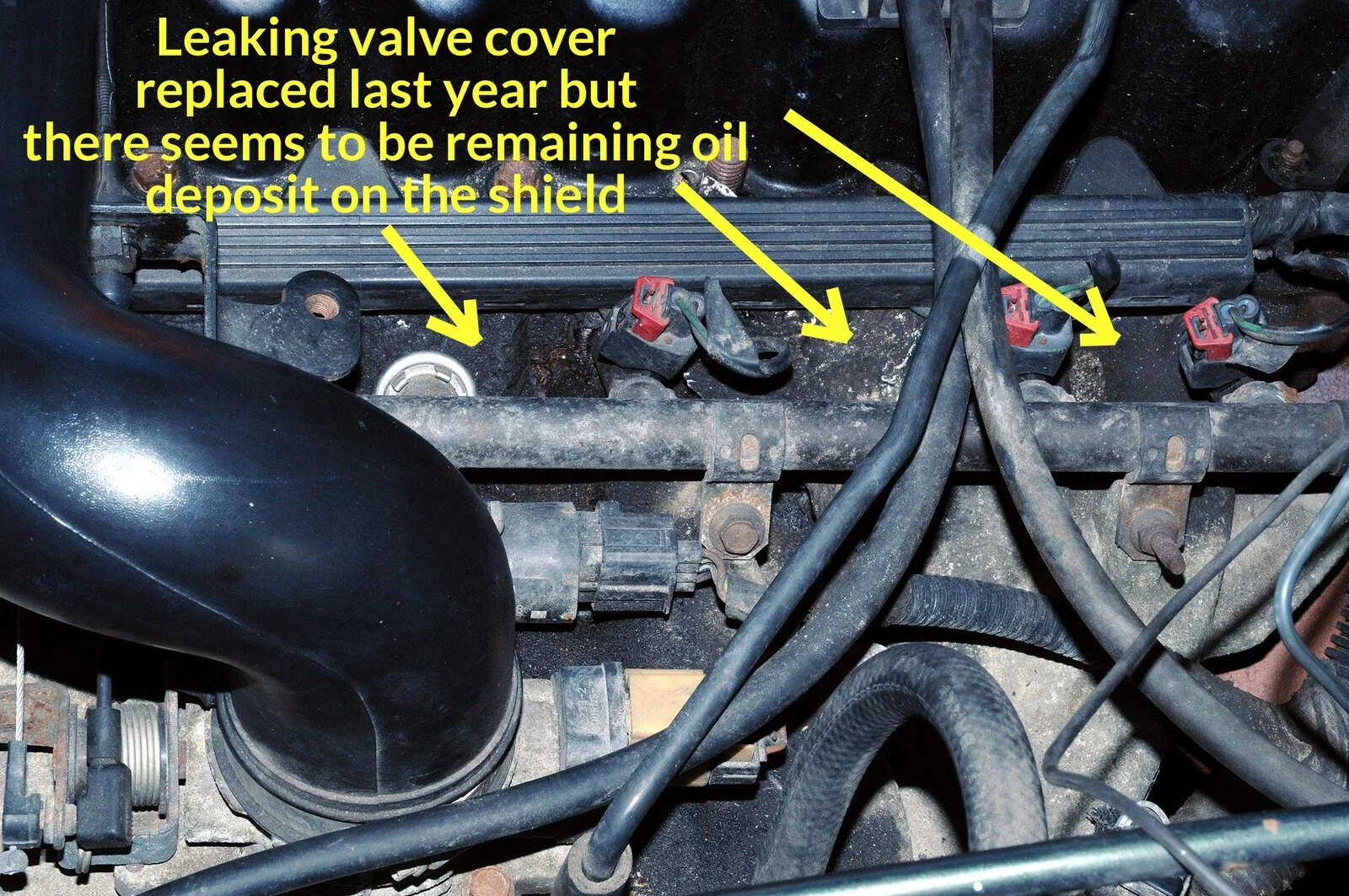

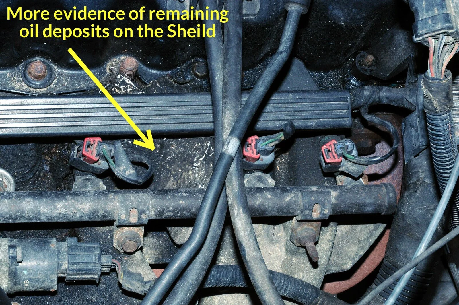

Thanks for your patience - was able to snap ACTUAL photos of my own Jeep showing the SHIELDS need replacement (oil deposit from older leak). Valve cover and gasket were since replaced. While I'm at it perhaps (still) replace injector rail with NEW injectors? I've read (when looking to save $$ its preferable to buy an OEM Rail used), rather than Chinese or Imported on Ebay ... True? However cleaning used injectors is another issue? Here's a USED OEM Rail (with injectors). And here's a CROWN Rail
Thanks Again! :)
