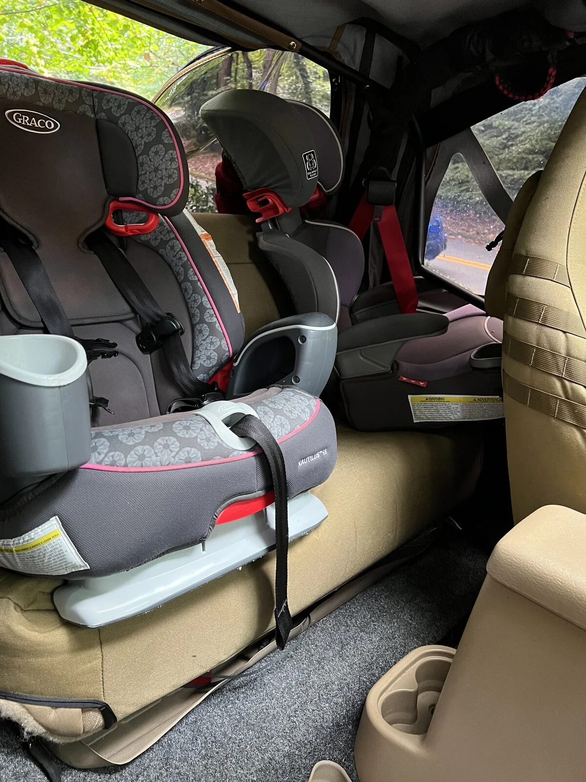

https://www.seatbeltplanet.com/ Is what I had when this happened. I walked away and the car seats didn’t move.

They really are a great US based shop. When I replaced the jeep above I placed another order. For those of us with kids in car seats, they will custom add the KISSE retractor on the rear belts which gives you the locking ratchet mechanism not found on the OEM.
