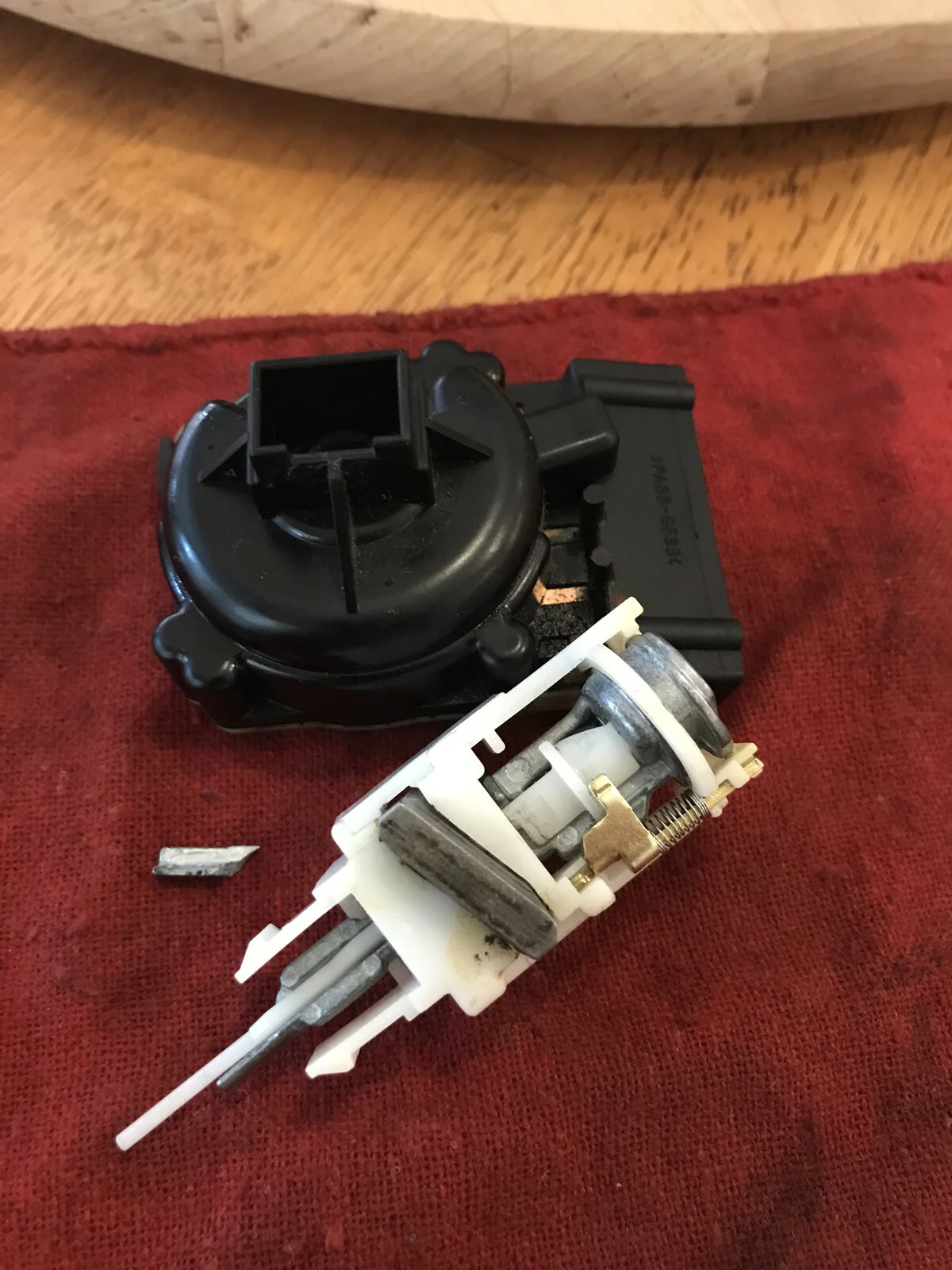

I'm thinking it's down to the "ignition switch" on this TJ. Here's the kicker....literally Sunday morning I put in a new Ignition switch in my son's 2008 JK that is still here (he can't have it at West Point). I finish and walk to move my TJ....and when I get the Nothing! It's like the MFer's are jealous that I work on one.
