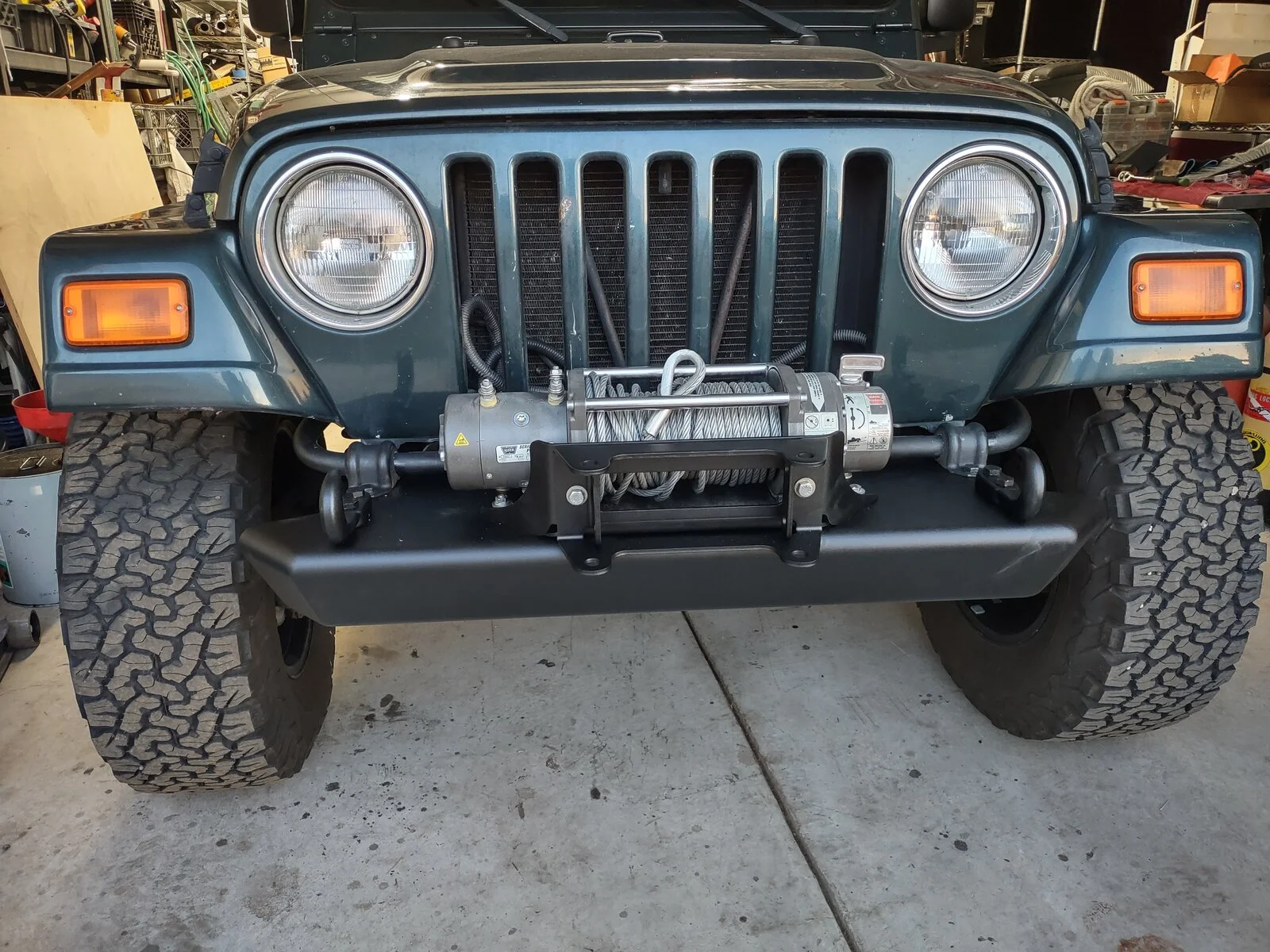

Got the Savvy Bumper that came with 'Hers' LJ Powder coated and installed tonight...looks rather nice
