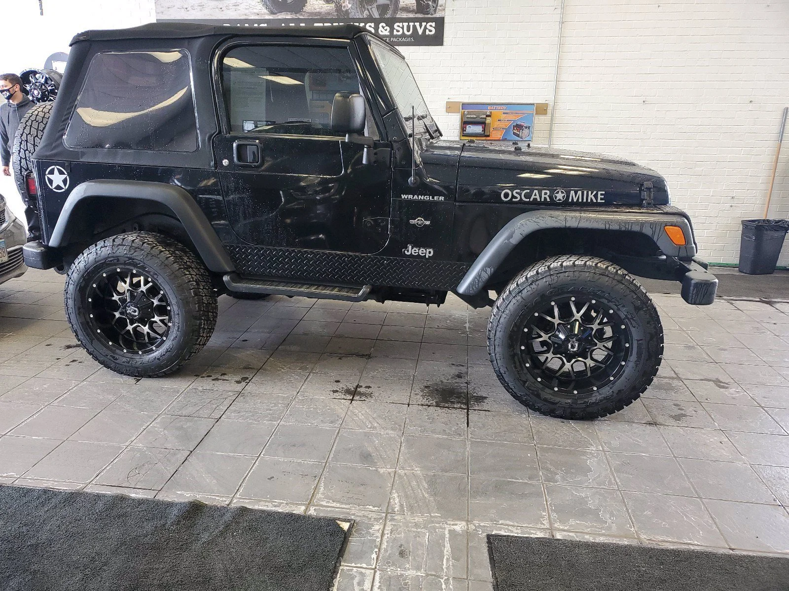

I have attached a photo of the Jeep.

Meh. That's not an 'edition'. That's a TJ with " OSCAR MIKE" stickers on it. Also the axles are off, see how far in they are? Threw a lift on it without the right control arms. They're probably off left to right as well.
I see what you mean about the axles. I was told it had a 3" lift (apparently not a good one). I think I will walk away from this deal.

I mean if it's solid otherwise & a good deal I certainly wouldn't let that dissuade you... Control arms & trackbars aren't the end of the world. But given the fact that it's from a dealer & they're trying to day it's a special edition I'd imagine they're asking top dollar. What's the listing price anyway?
