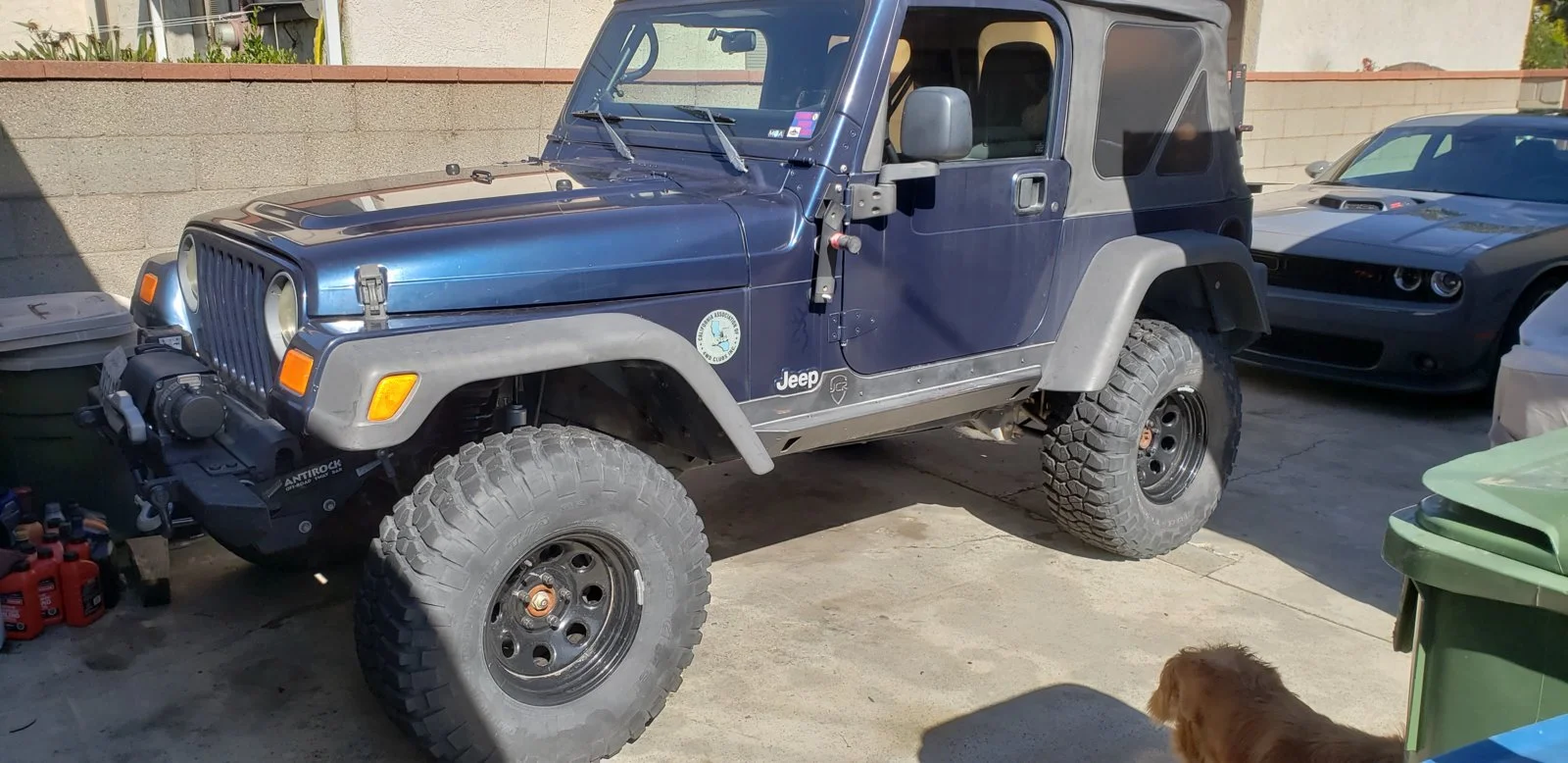

2005 Rocky Mountain Edition TJ. Patriot Blue.
Belly Up / Tummy Tuck. 111,000 miles, 4.0, Auto Trans, Super Short SYE, Tom Woods rear driveshaft, Currie and Rokmen adjustable control arms, Dana 44 rear with Detroit Trutrac, Dana 30 front with Detroit Locker and RCV axles. PSC Steering box. RockHard 4x4 Full Cage and tire carrier. 4.56 ring and pinion. Warm Synthetic line M8000S winch. Terraflex Trans and engine skid. Cobra CB, Firestick Antenae. Trans Cooler. JCR Rock Rails. REG is paid, won't pass California smog check due to "O2 sensors not ready".

Don't know if it matters but we just fixed one with the same issue. The TSB had been done, O2 sensors replaced, yada yada, the usual drill. We did some fairly specific AB parts swapping and figured out the PCM was bad. Customer got one from Rock Auto, we downloaded the software into it and it's good to go. If you need some help with it, we don't mind. If that isn't why you're selling it, disregard.

2 years ago to pass smog I replaced all four 02 sensors with NTK. Then paid a cert smog repair facility $350 to diagnose it. They replaced the canister / purge valve and it passed.
This year i had 'not ready' and did the service rewire in the power dist box. That 'not ready' went away but now getting 'not ready' 02 sensors.
If I replace all 4 sensors.... $100
If I replace the cats ( which test OK)...$600 to $1,000.
If it's PCM computer.... $400 to $1,000 if I can find one.
