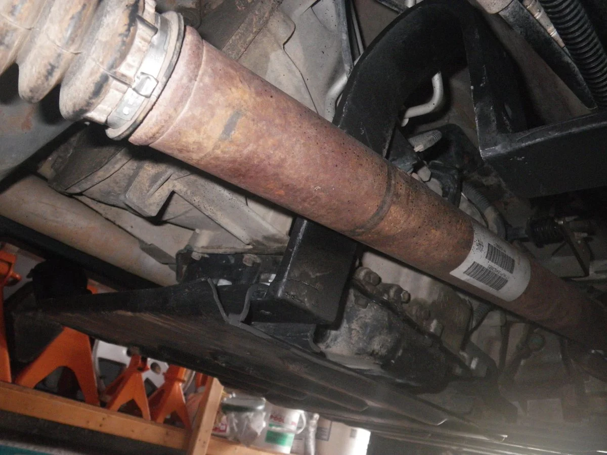

Here's how I modified my original trans.skid.
Thats the same area that mine was rubbing,too bad i got upset with the way the shop hacked mine and took it off threw it away.
