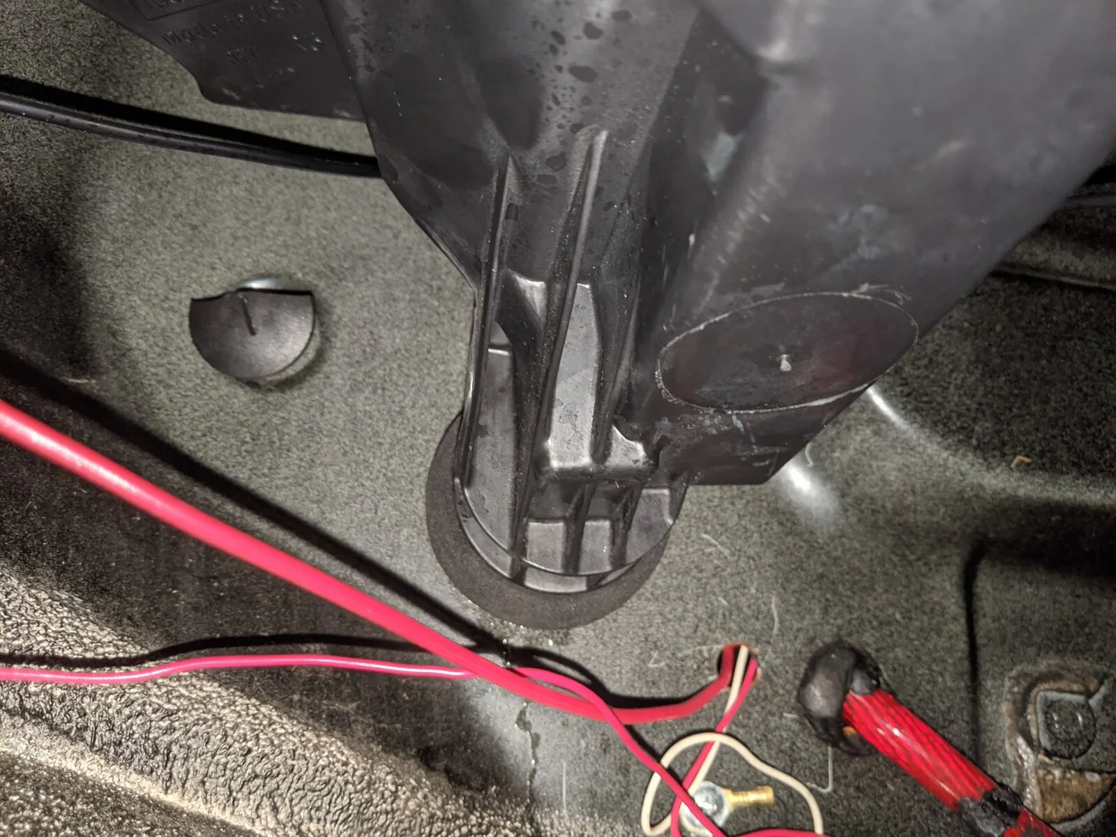

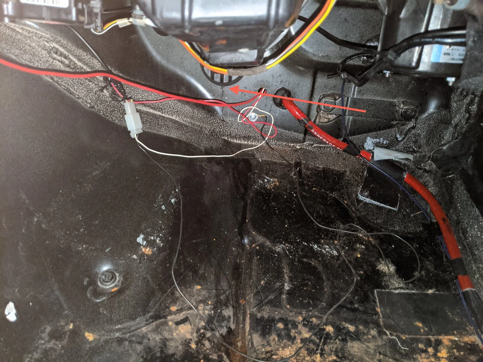

We had a good amount of rain most of today and so far I'm dryer. I found one remaining leak coming from the firewall between the engine and passenger side. Here is a wide shot:
And here is closer up on the opening and parts going through.
I *think* is part of the HVAC system but I'm really not sure of where the water is getting in. If the water was coming through the engine bay I'd expect to see drips from the unsealed hole to the right in the above picture. Note that the car has not been driven today so no splashes are involved with these leaks. Two weeks ago I did clean out the cowl drain and noticed that there is a gap between the metal and the cowl drain itself. Water drained through both openings after I cleaned it out. It did not *look* like water was going anywhere problematic when I was testing.
Any suggestions on where to go next?
Water in the passenger footwell is a common plague.
Pull the cowl off and see if there is any trash in the HVAC intake. Usually something causes the drain to get plugged and the water runs behind the firewall.
Usually that fixes it.
I think I found the source of the water. The wiring for the side lights and lightbar were jammed underneath the engine hood rubber weatherstrip which created a nice path for water to drain right down the firewall.
