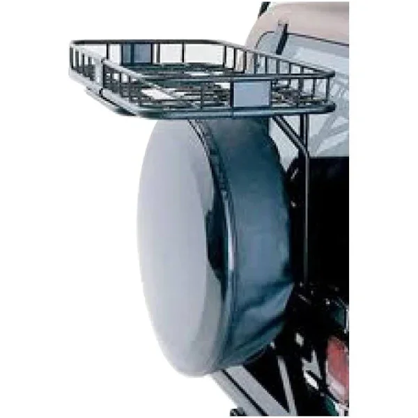

Here is a pic of a generic one online. If you don't have the clearance of the windshield it should be as simple as your front support legs having a slight bend before the start of the windshield your rear support legs can be at a straight 90. Forgive the crude paint..... The two legs would be joined by a support leg and can be jointed at the stock bumper or to the bottom of the tire carrier. if at the bumper a cotter pin setup would be used to disconnect to open the trunk.
