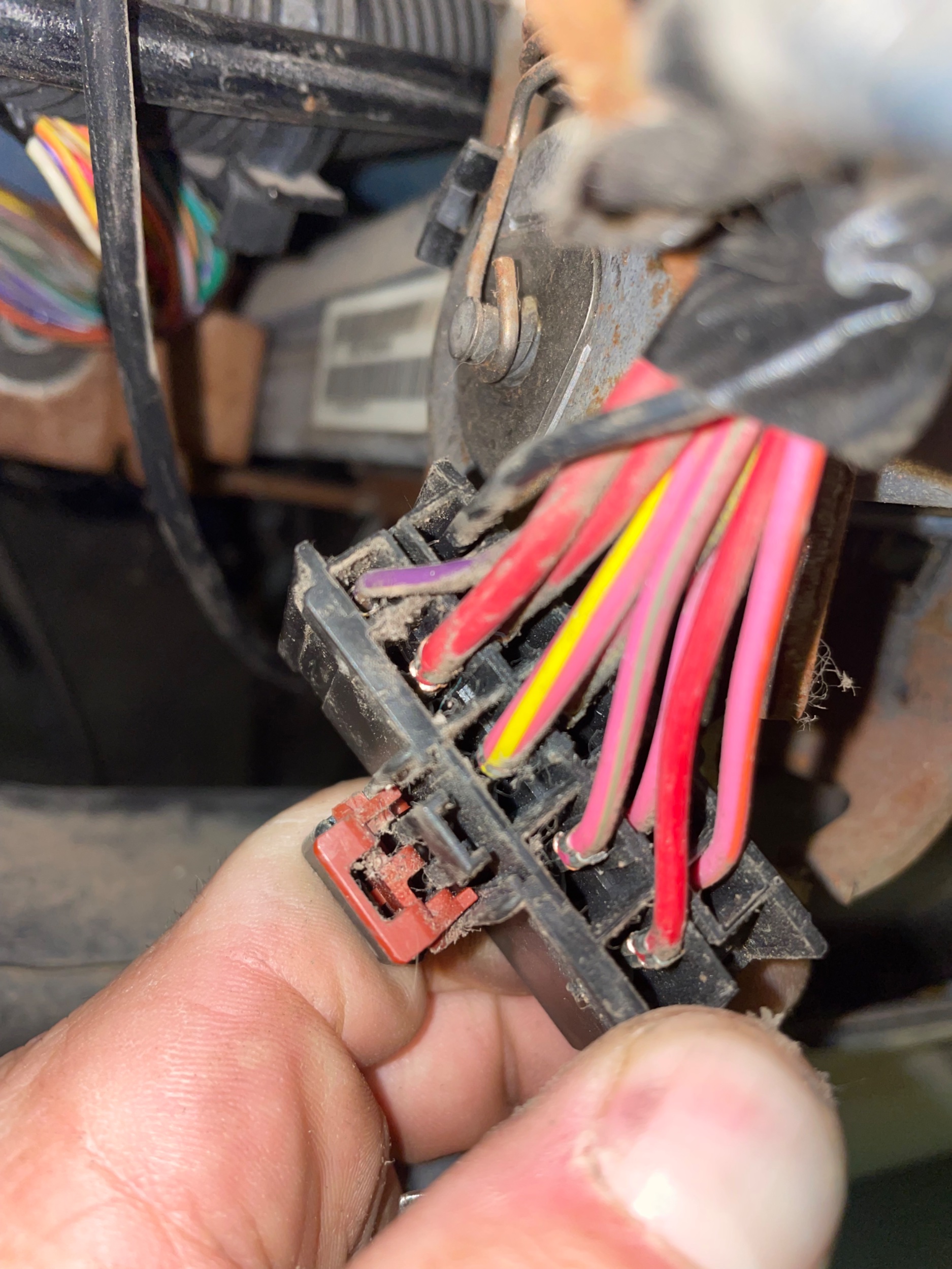

Im doing a tdi swap and need help. I have a wiring harness from fast forward. Trying to connect it to the instrument cluster on a 2005 wrangler SE. I attached a photo of the main ignition plug. Wondering which wire is the +12v, ACC1, ACC2, starter(+). Also need to know which wires going to the cluster are the alternator light, VSS, check engine light, tach output, coolant temp, and oil pressure. Any help would be greatly appreciated.
It doesn't quite work that way. The cluster is on the network bus. There is no tach wire for example it's done as a signal with other items like the vss on the same wire.
