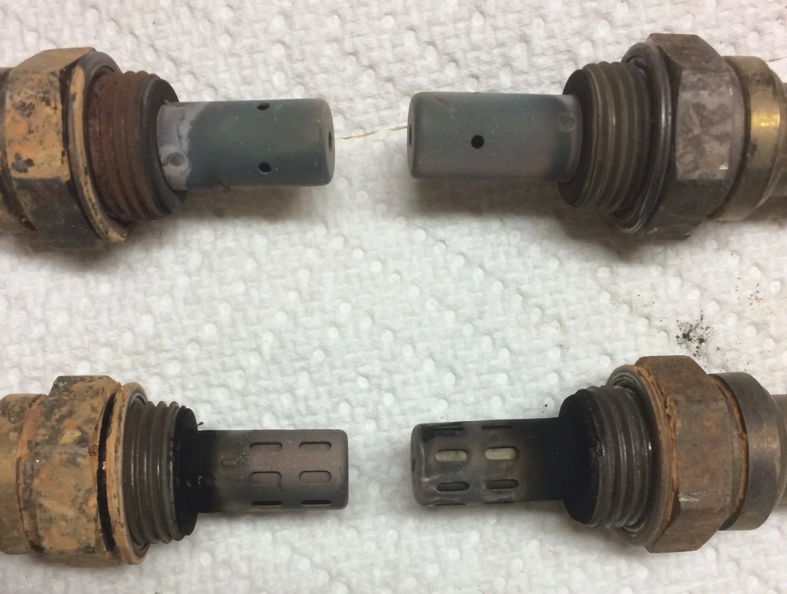

Pictures of the old O2 sensors below. Let me know if it looks like typical wear or if I should start a go fund me account for new cats.
If she's running good she's good.
