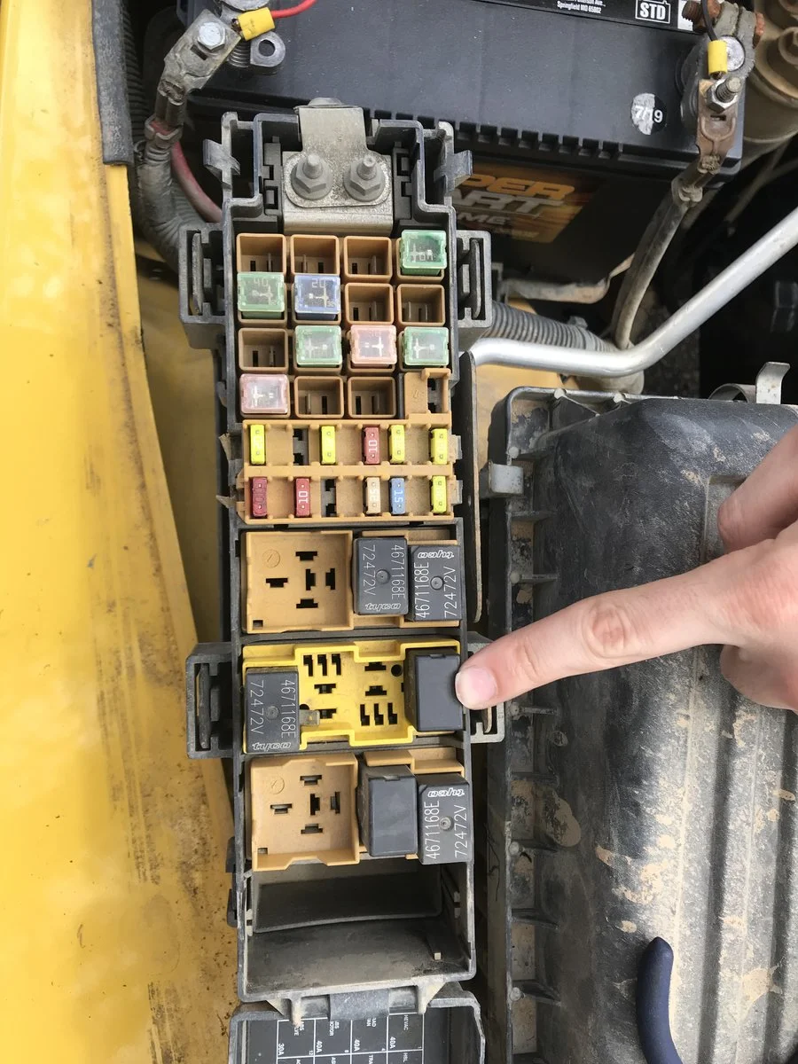

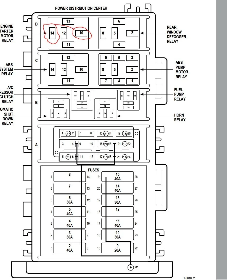

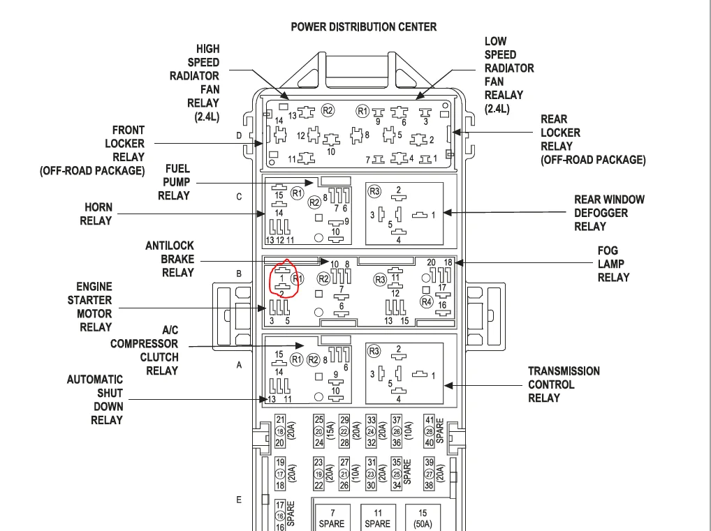

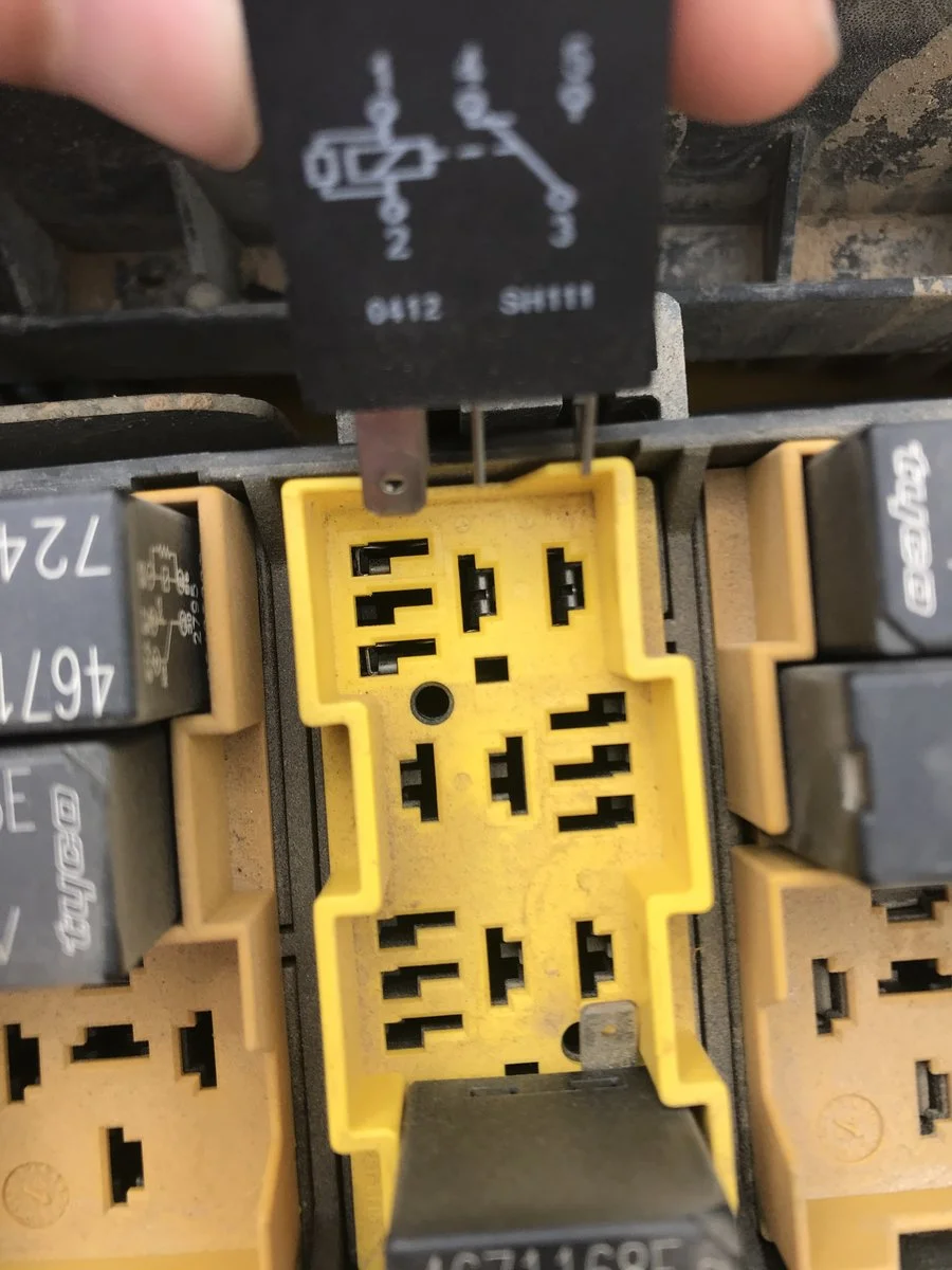

The battery is fresh and the starter is good. I can still push start it, and all the other electronics work. When you turn the key to “start” power drains from the dash (as expected) and there is a single click from behind the glove box, but it will not start. Overriding the clutch switch with a fuse had no affect.
Any ideas on what might be wrong, or how to diagnose this would be greatly appreciated.
