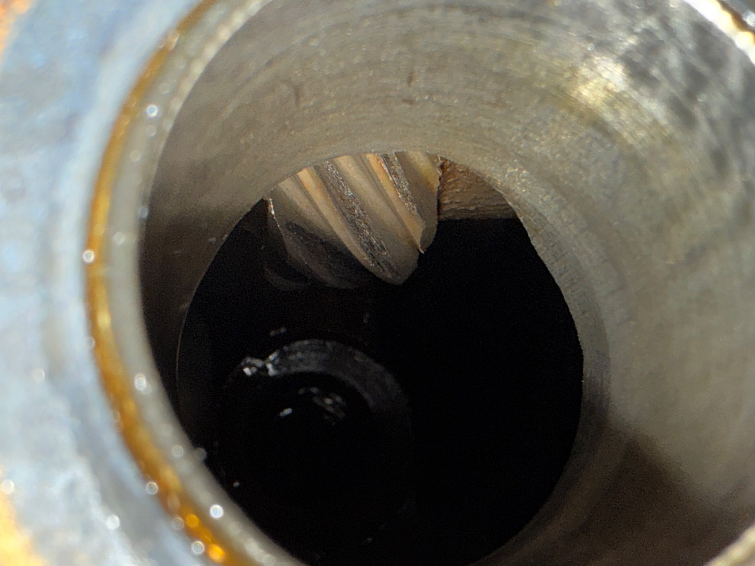

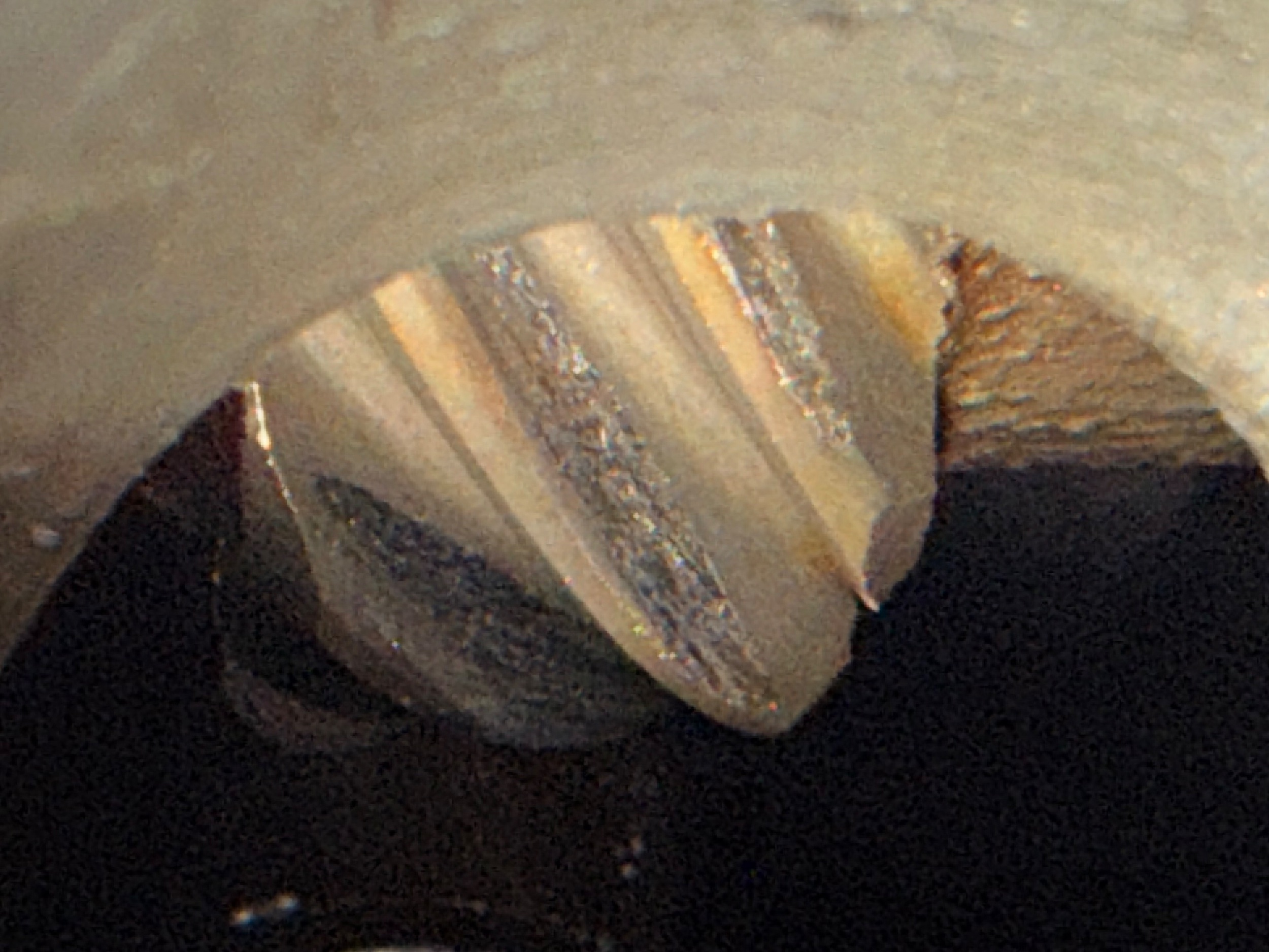

3. I’m getting a p0016 code after driving for about an hour. A few times it’s stuttered at around 3400 RPM’s. I replaced the OPDA twice now, things were lined up perfectly I’m pretty sure). mainly because I had an extra crown unit on the shelf. I still have the Mopar CPS sensor on there.
These are the photos of my cam gear:

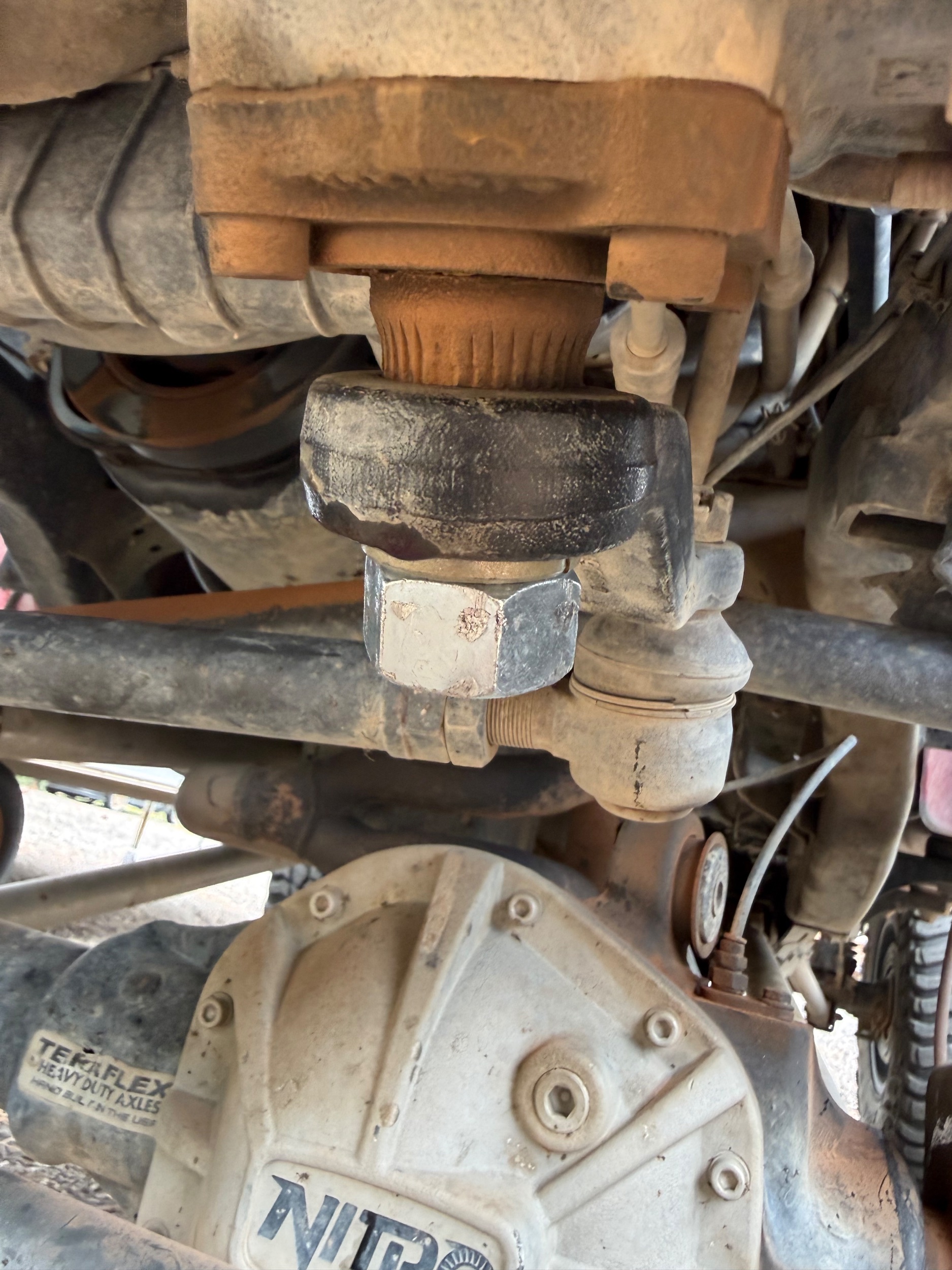

In the meantime, $3.69 fixed my steering. Turns out all the slop I just thought was normal, was in fact, not. Having my pitman arm torqued down properly has completely changed the handling of the Jeep. I’m shocked how many times I drove this thing 7+ hours without considering that bolt might be loose.
I used red locktite and put a paint marker on it, after this picture.
