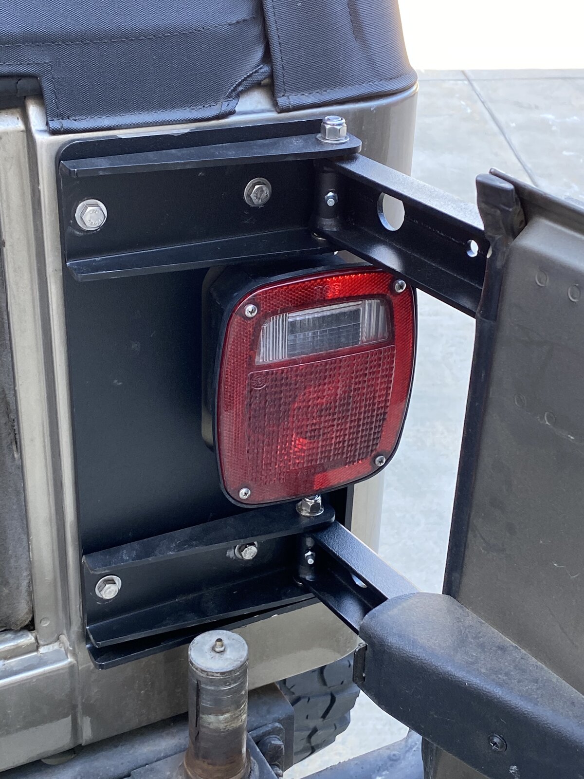

Got the P0421 code after changing the plugs...cat started glowing red hot. Threw a cocktail of Lucas fuel system cleaner and Cataclean in and have run a couple tanks of premium through it, and knock on wood the CEL turned off. Also added the MorRyde tailgate reinforcement kit that my lady got me for Xmas and it solved the issue of the crappy tire carrier. Just need a new bumper to complete the rear!
