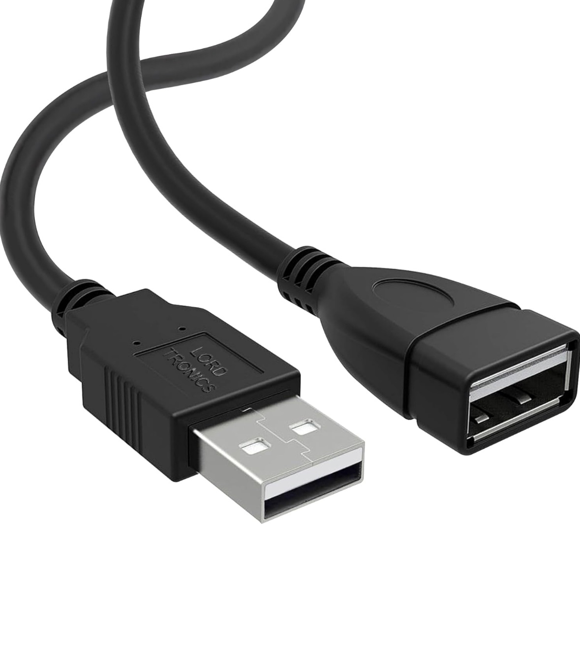

I have a 2nd oem cigarette lighter housing that I want to wire up behind the dash to power my Wolfbox video mirror/camera. Can I just splice into the existing wires and wire directly or will this adversely limit current or voltage or some other thing I don’t want limited. Once installed it will be completely out of sight however as the WolfBox power supply has a USB outlet I will also like to add a generic cable to be used “in case”

One issue to note with USB outlets is the amount of volts you need. Let's say you need 3 to run your equipment....many USB outlets put out 1 volt. You will need to check.
