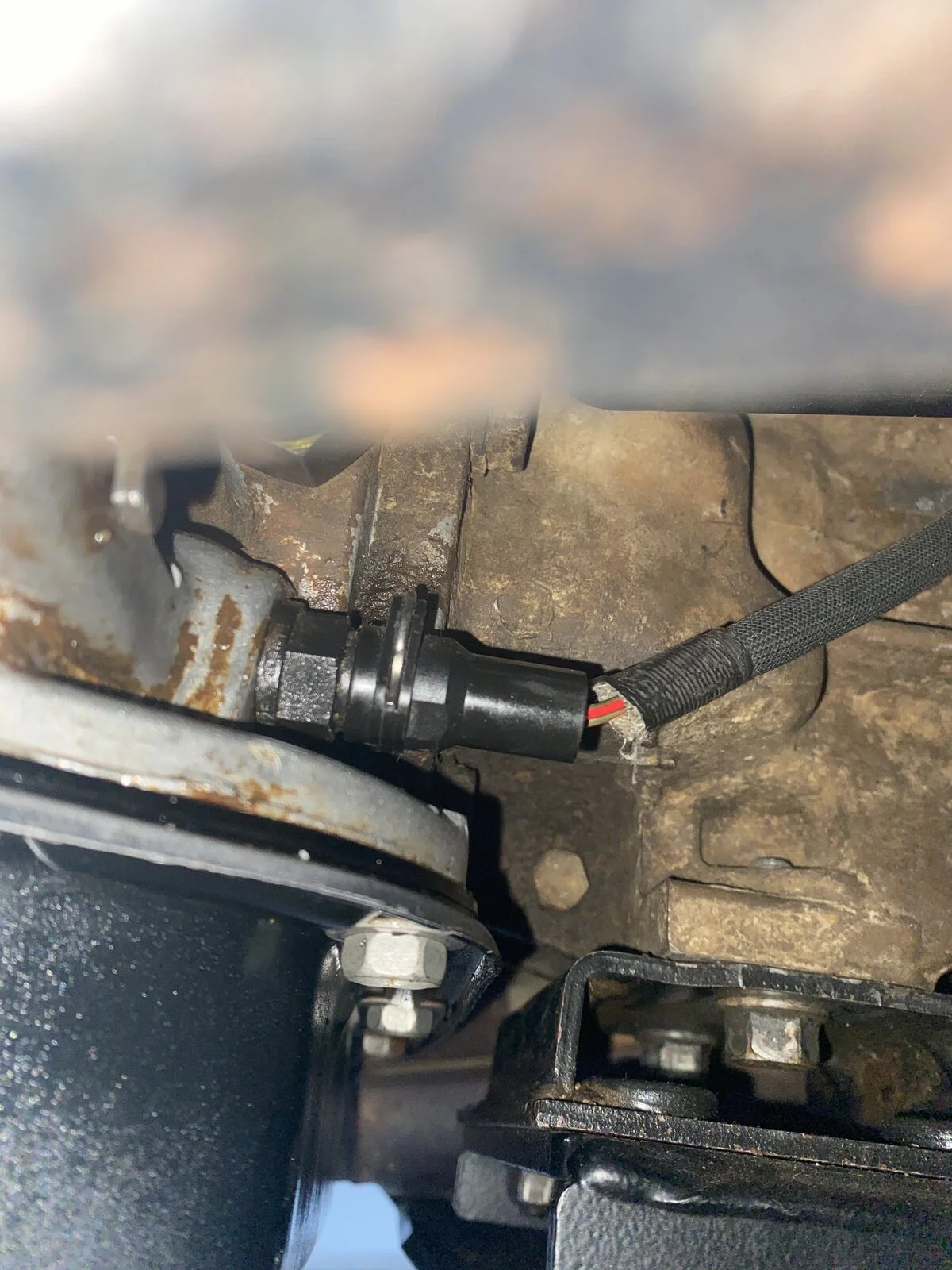

Well I went out and disconnected the TCC . The transmission went through 1, 2 and 3rd and never did the torque converter lock up. Then reconnected the TCC and the torque converter did lock back up.When the torque converter locks up it almost feels like a 4th gear is engaging and the rpms drop 100-150 or so depending on your speed.

Good, that localizes the issue to something electronic. The speedometer may need to be calibrated since the PCM uses your speed to calculate when to lock it up, or perhaps your PCM is going bad.Well I went out and disconnected the TCC . The transmission went through 1, 2 and 3rd and never did the torque converter lock up. Then reconnected the TCC and the torque converter did lock back up.
How would you Calibrate the speedometer?Good, that localizes the issue to something electronic. The speedometer may need to be calibrated since the PCM uses your speed to calculate when to lock it up, or perhaps your PCM is going bad.
If you didn't install a SSSYE and are still running the stock speedometer gear.... http://www.4x4xplor.com/speedo.htmlHow would you Calibrate the speedometer?
Speedohealer it isIf you didn't install a SSSYE and are still running the stock speedometer gear.... http://www.4x4xplor.com/speedo.html
If you're not still running the factory speedometer gear you'll need to install a Speedohealer to calibrate it.
