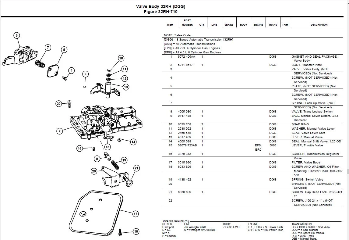

I have an '02 Wrangler Sport, 4.0 with a 32RH transmission. I've been looking for a valve body but I have no clue where to start as I can't find a part number on it. I've looked on ebay for a replacement but all those numbers look foreign to me. Would a A904 TF6 valve body work with my transmission or is that only for a 30rh? Any help would be greatly appreciated.
Thanks for the info! It kinda led me in circles but through sheer will power of going down the rabbit hole, I think I finally found it. I'll definitely follow up and post if it worked of not for future generations. Lol
