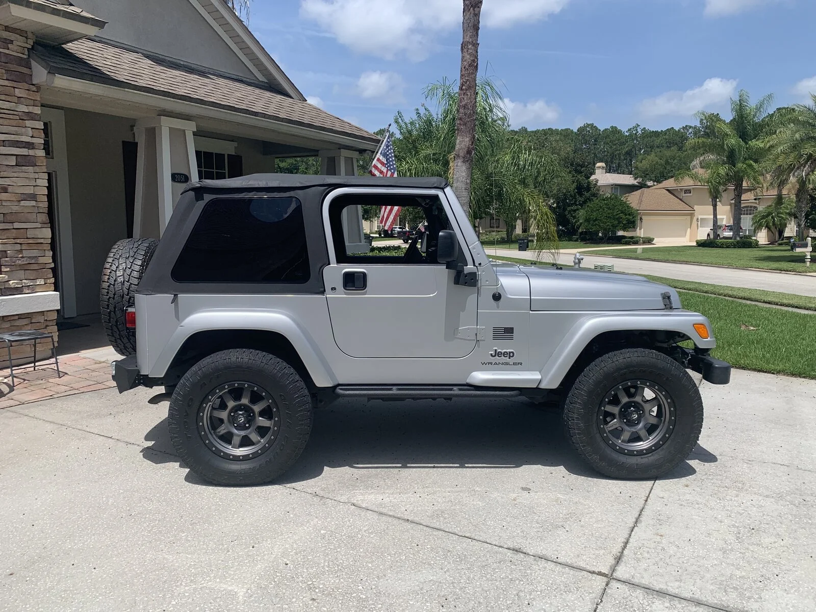

I have a 2005 LJ, it was completely stock as of last September 2019. The vehicle was completely original, with very low miles. Summer driven only.
I have installed 33s with a 2.5” lift (OME coils and rancho shocks), adjustable trackbars. The Jeeps handling has not changed at all. All my suspension components are tight and almost new due to low miles.
What does this mean? Most times people install large tires which then show the true colours of the Jeep and vulnerable components. In other words, if your suspension, bushings, etc are all up to par it won’t feel really different.
One thing that did change was gas mileage went down.
