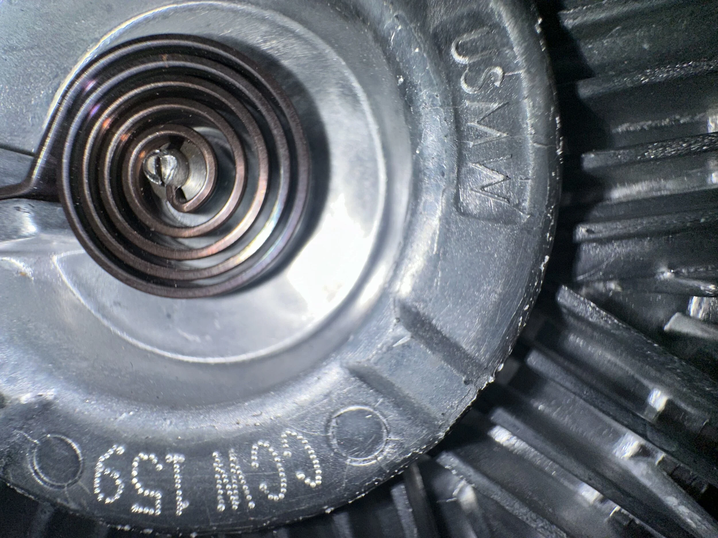

Not sure if I’m extremely unlucky or if Hayden’s are garbage now… today I decided to check out if I could get one at the local AutoZone that would provide the 2791 severe duty while hopefully being a better quality part. I crossed it with duralast 922791 and was pleasantly surprised to see made in USA stamped into the fan clutch and a large zinc coated main nut, it was also marked usmw “us motor works”I’m feeling hopeful that this one will last. After install it quickly disengaged and seem to work well time will tell if it’s quality part and oem equivalent.

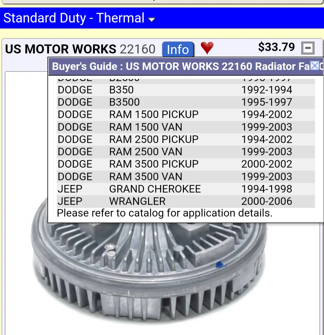

Amazon says the 22160 is not a fit for 2006. Is Amazon incorrect?
Rockauto suggested it and it fit my '06.

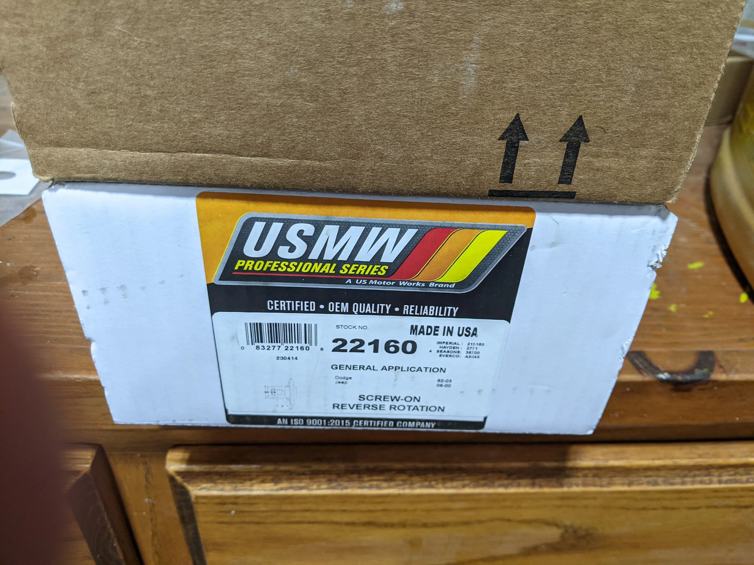

I haven't driven mine yet but the US Motor Works I installed appeared to be good quality and definitely spins more easily than Hayden. I have the older 4 bolt style mounting. I picked up a NOS Mopar from Collins Bros the other day, so eventually I will do comparisons between it and USMW. I did not like Hayden at all, it felt locked up super hard all the time. Ridiculous amounts of noise and I could feel the drag in the acceleration.

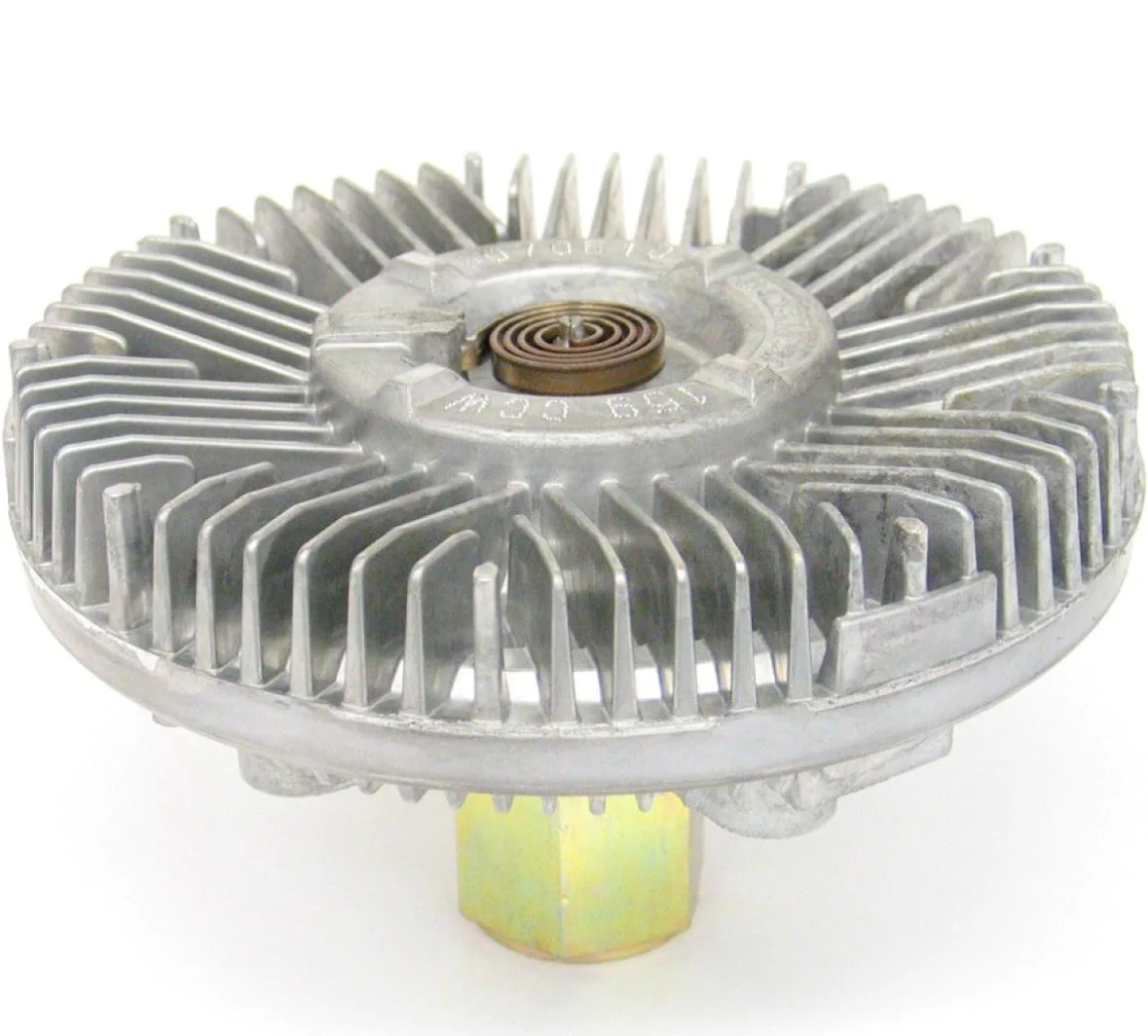

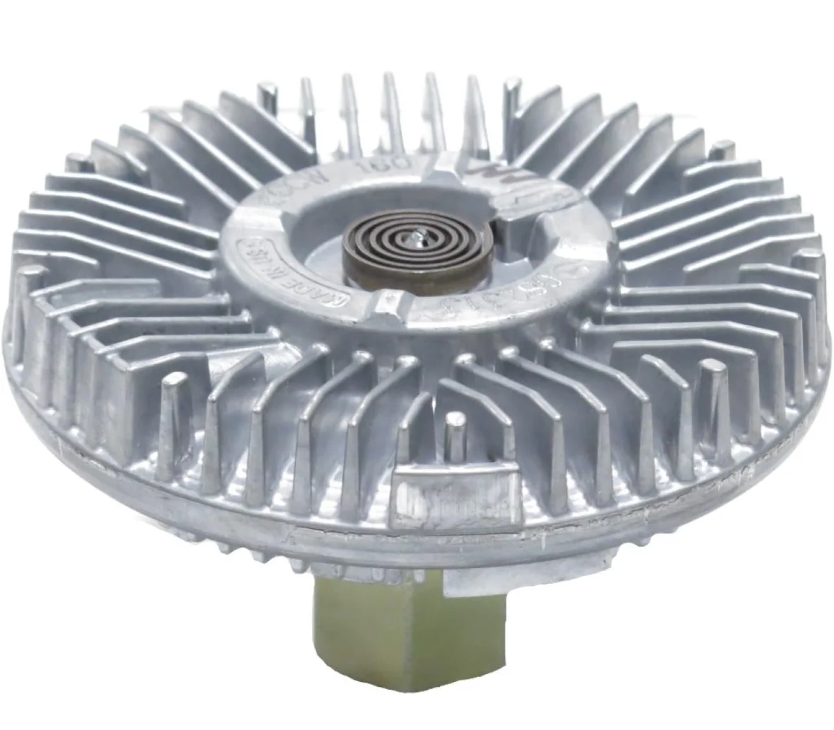

So I was curious what the part # was on my clutch from auto zone turns out it is usmw 22159 after doing some digging it appears to be the severe duty option for our jeeps. so 22160=2771 while 22159=2791 for the Hayden equivalents it also it compatible with larger 2500 and 3500 trucks. It my not be listed as a direct replacement but I can confirm it fit and works perfectly similarly to the 2791 option with the exception of the usmw actually functioning properly 🤣
22159 notice it appears to be slightly larger in diameter
22160 appears slightly smaller
