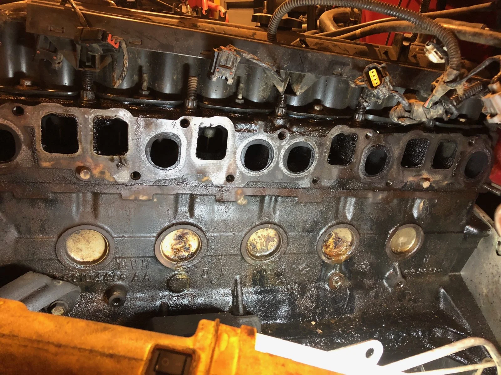

I have pulled the intake and exhaust off to replace the freeze plugs, As you can see they are leaking. I popped 3 of them out and for the life of me cannot get the new ones back in. I got one in that is adjacent to the motor mount. I used a huge prybar and a socket to get it started then hammered it in the rest of the way, but I cannot get any of the other ones started I got two blood blisters trying to start them with a socket. After a couple hours and multiple tries, I am coming here to see of there is someone that has a trick.
My problem is there is not enough room between the block and the steering to get a good swing. I looked up videos and all I could find was cherokees. and one video suggested putting the plug in the freezer of which I tried, but it didn't make any difference. Another video showed a guy just pushing it in with his fingers to get it started, but there is no way that is happening. Maybe I don't have the finger strength, I don't know but I could not get it started by hand.
Running out of ideas, would sure love to hear some success stories about now....

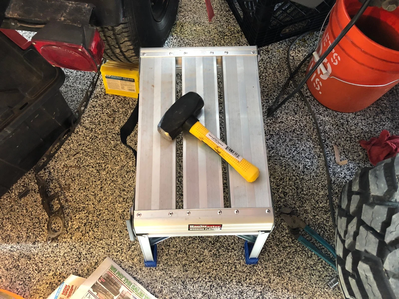

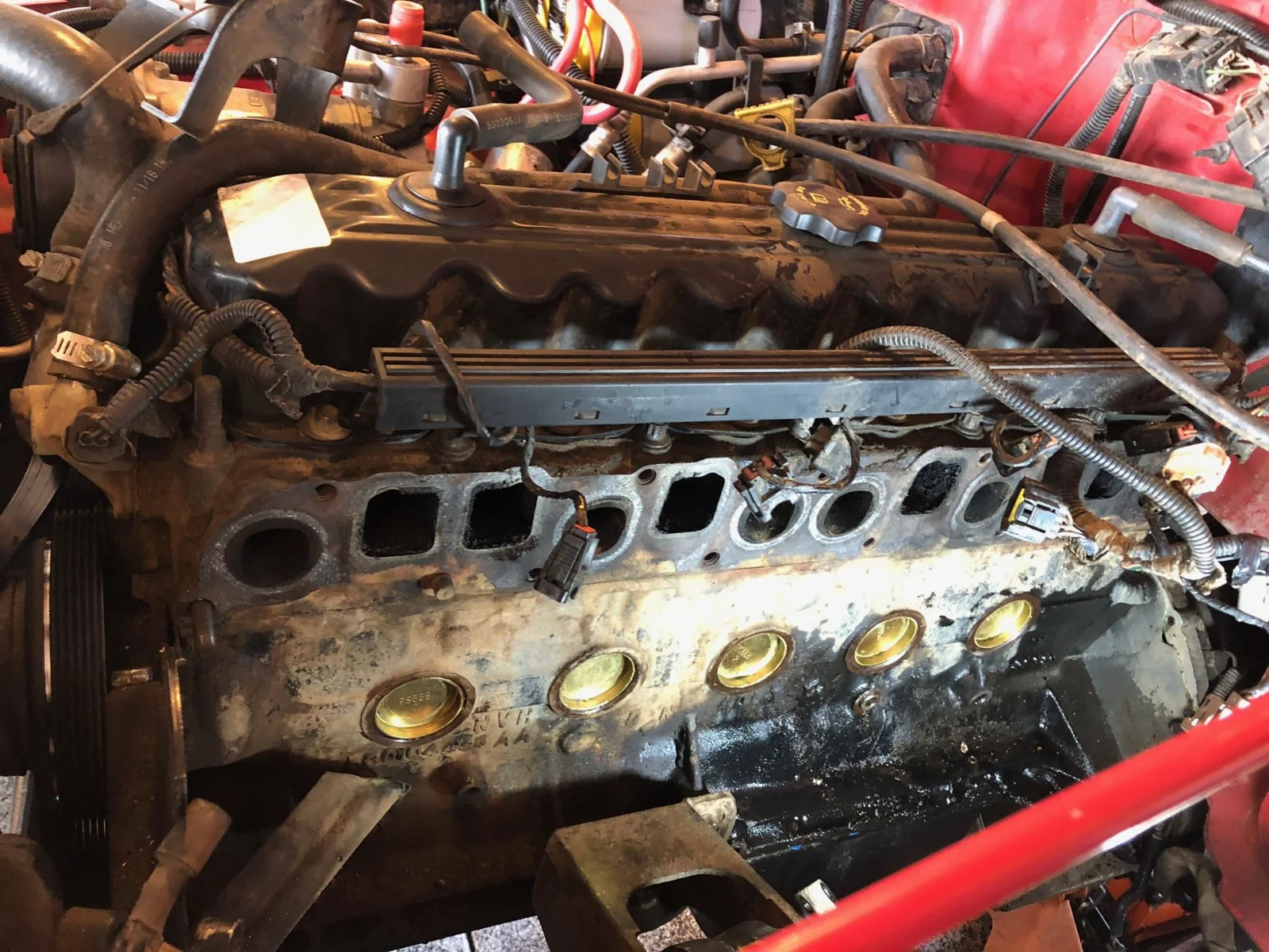

Update, I think all of the advice here was solid.
I think giving up and getting some sleep was really the answer to tell you the truth but here is how I resolved this and how my day went.
I woke up and watched an episode of Chasing Monsters on Netfilx. It is a fun show about a dude running around trying to catch the monster fish. If you like fishing shows and you have Netflix, I highly recommend it. Then I got ready and headed out to NAPA to buy a freeze plug tool, but they didn't have one, so I went to a few more places and nobody had one. I ended up at Harbor freight and I bought a baby 4lb sledge and a stepping stool and came home and gave another crack at it. The baby sledge is awesome, twice the pound with half the swing. Just what the dr ordered. So if you are in the same predicament as me, this is how I solved it.
Reactions: Squatch
Great news! Glad you got it. I have that same step from HF, love that step and use it a lot, now I just need to pick up the baby 4lb sledge and I'm ready. Hope I don't need it. Good Job!
