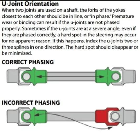

I also found this - see the part about u-joint indexing.
Can one of you folks try this? @Ranger_b0b? Still think there is merit to this idea, but not sure if this is applicable for us completely.
You wouldn't want to do this. They are talking about steering here, which is low speed (VERY low speed). If you operated a driveshaft at a severe enough angle that you were getting "hard spots" in it, it would self destruct in short order. Those hard spots are where the yoke ears are starting to interfere with each other!
Reactions: psrivats
Ah ok. Makes sense. I'll keep reading and see if there is anyone out there who has had this problem resolved, ever.
