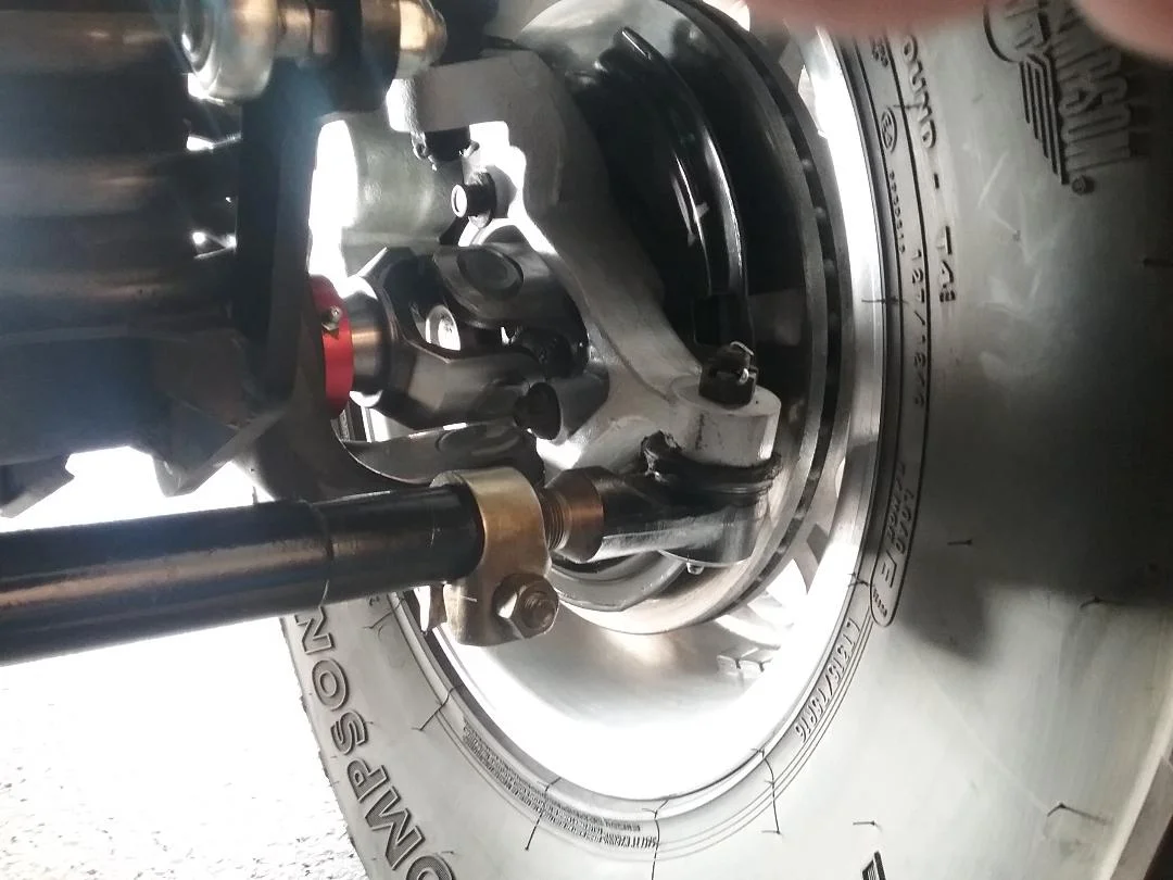

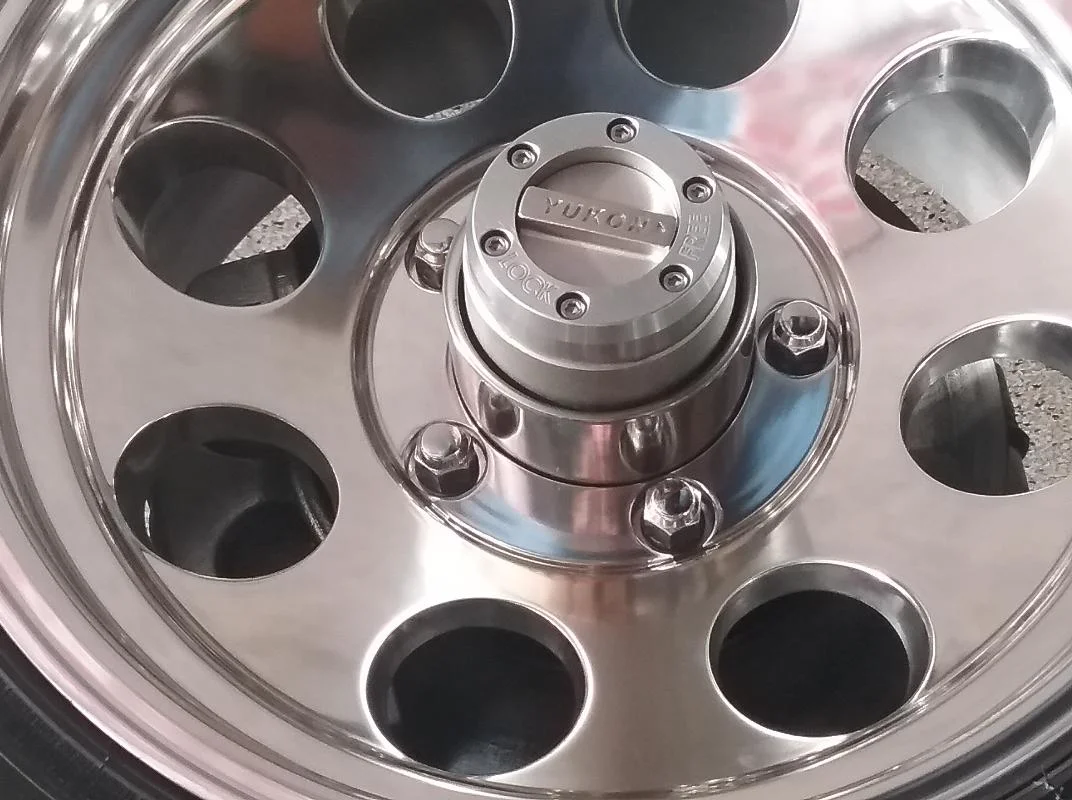

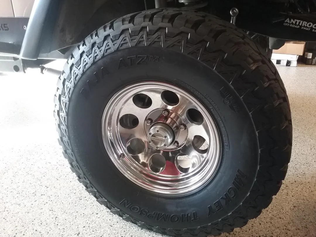

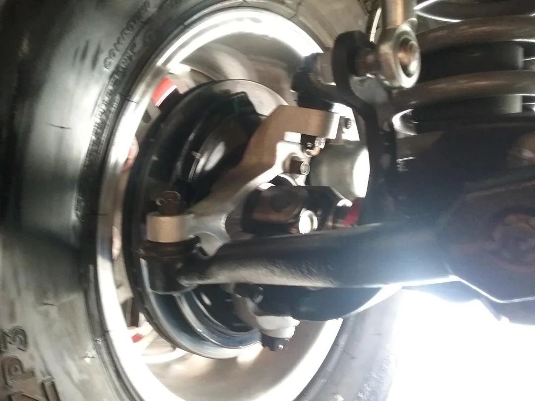

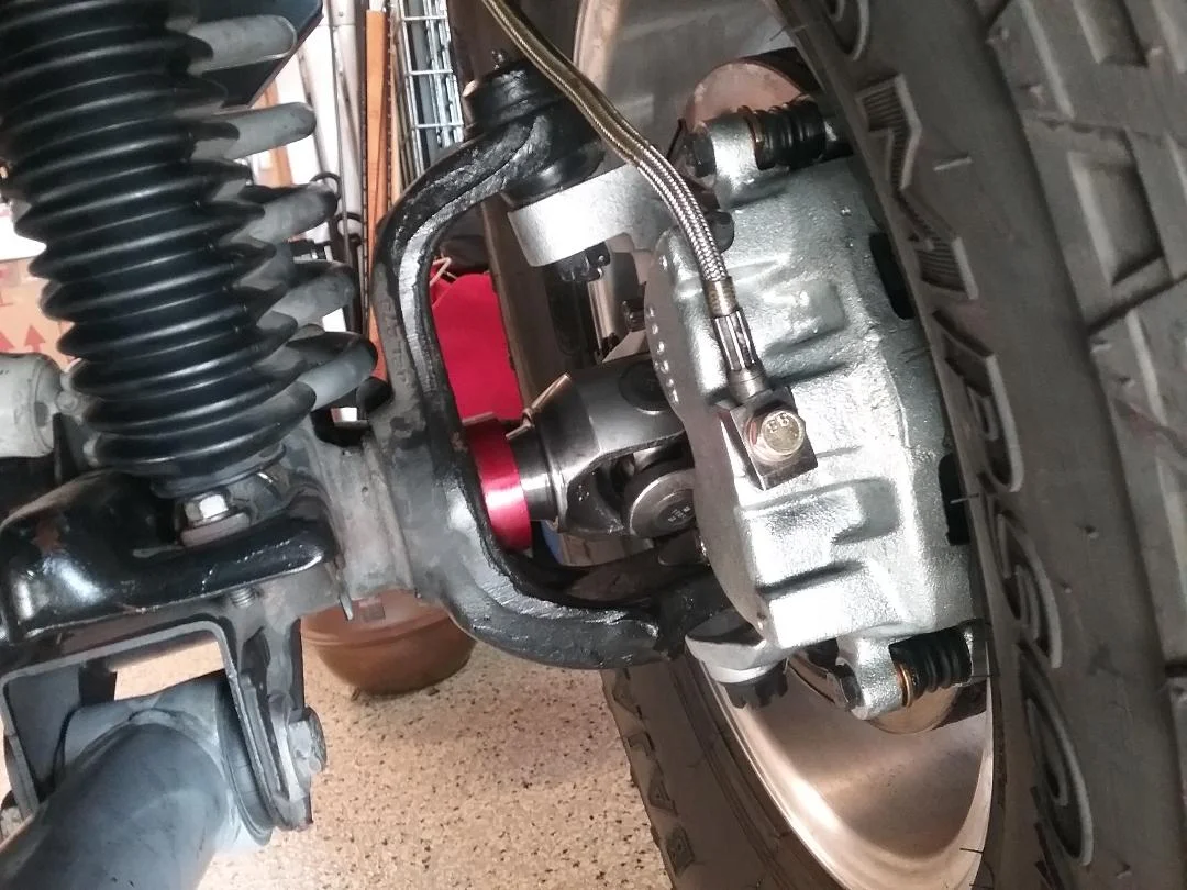

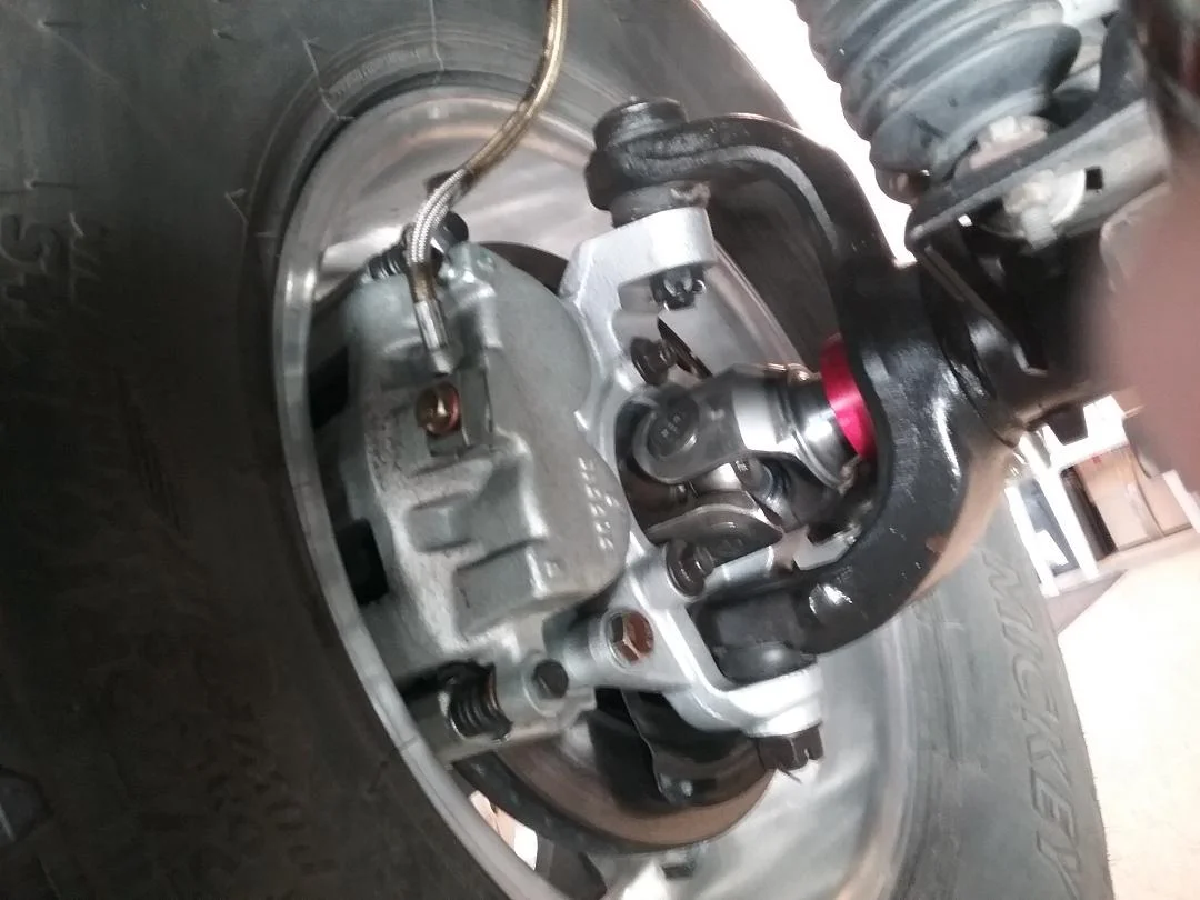

I am pleased to report that the hub conversion has been completed without complication and the vibrations that commenced after my re-gear to 5.36 are now completely gone.
See this thread: https://wranglertjforum.com/threads/install-report-yukon-ya-wu-08-manual-hub-conversion-kit-and-vanco-16”-big-brake-kit.18025/
That work looks so professional , I would love to see the entire Jeep . Love the wheels too.
