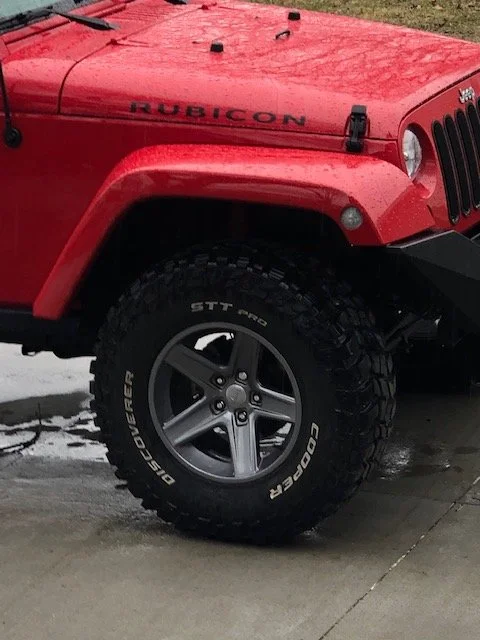

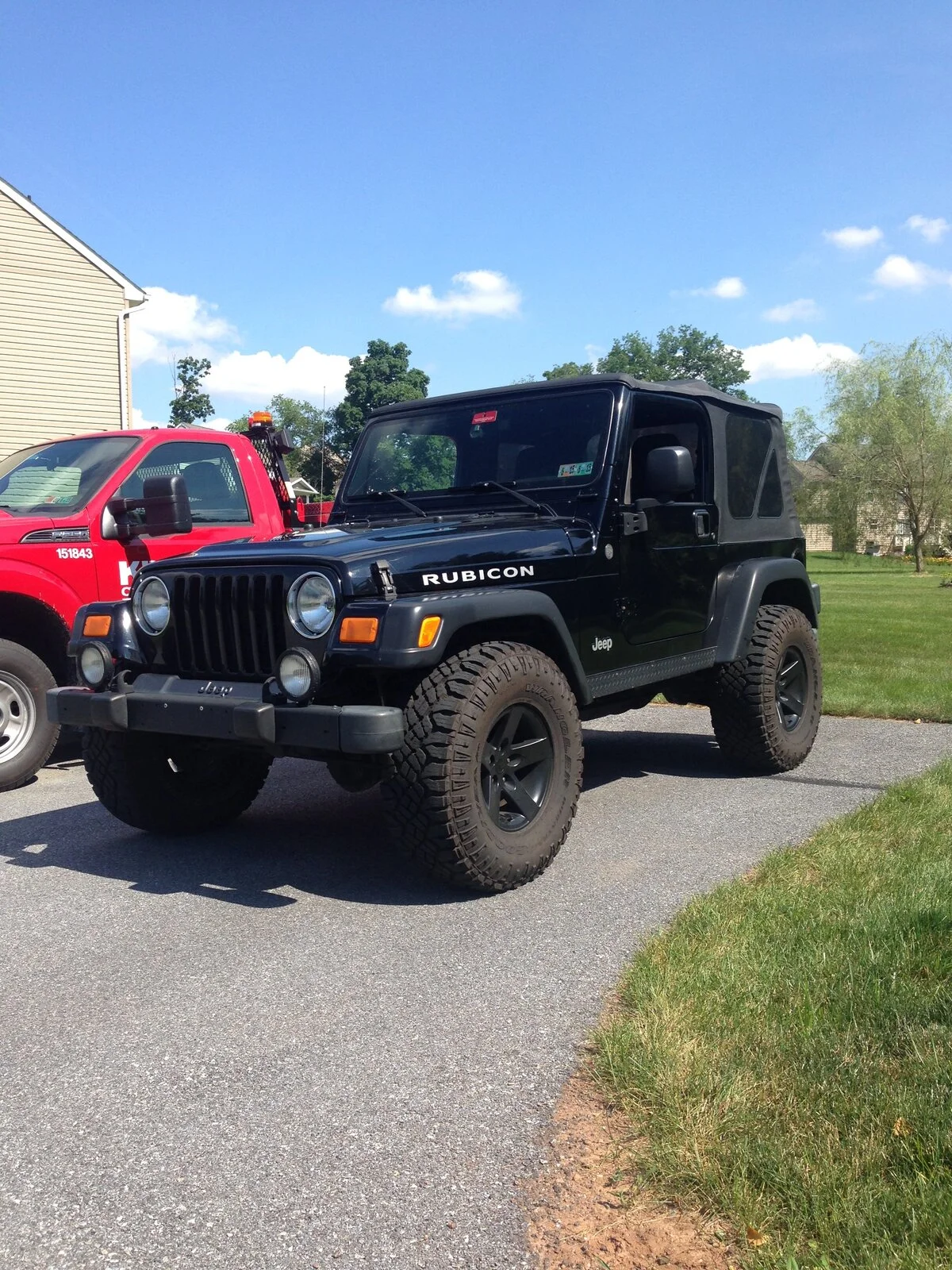

For reference, this is a 12.50 on a 9” wide wheel with 3.75” of BS. Rubicon flairs.

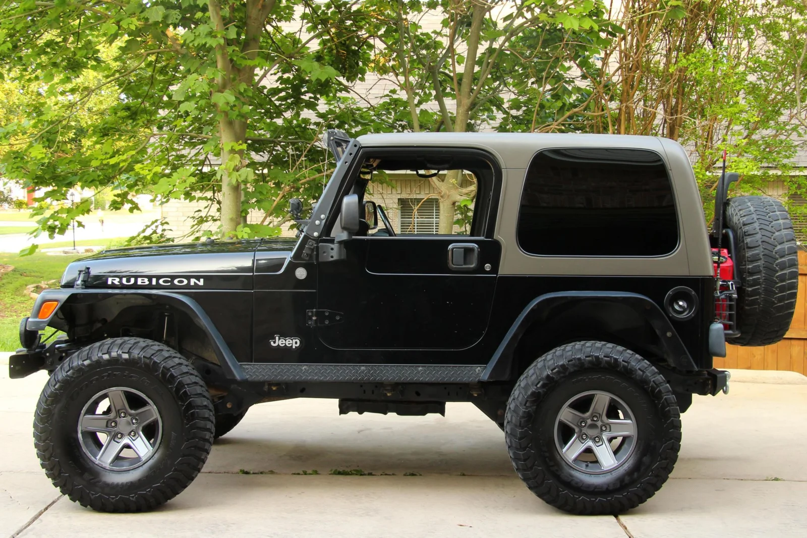

I'm running 4.63" BS with 35x12.5". I had to adjust my steering stops with a few washers but I still feel I have a good turning radius. They are very tucked with only a little tire poke with Rubicon flares.
I'd definitely go with either 3.75 or 4" backspacing. And since you live in SoCal as I do too and you're surrounded by trails with big rocks on them, get wheels you won't mind them getting rock rash or worse on them.
