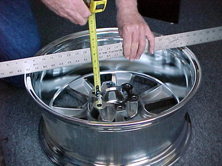

This is how backspace is measured, the yellow tape measure is measuring the backspace dimension which is the distance between the inner-most edge of the wheel and the wheel's mounting flange.
