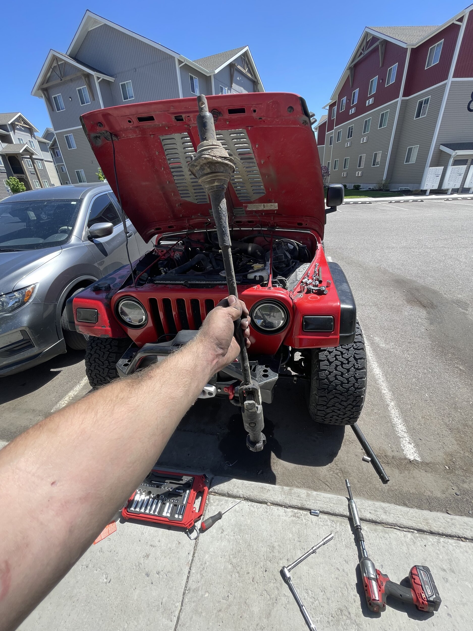

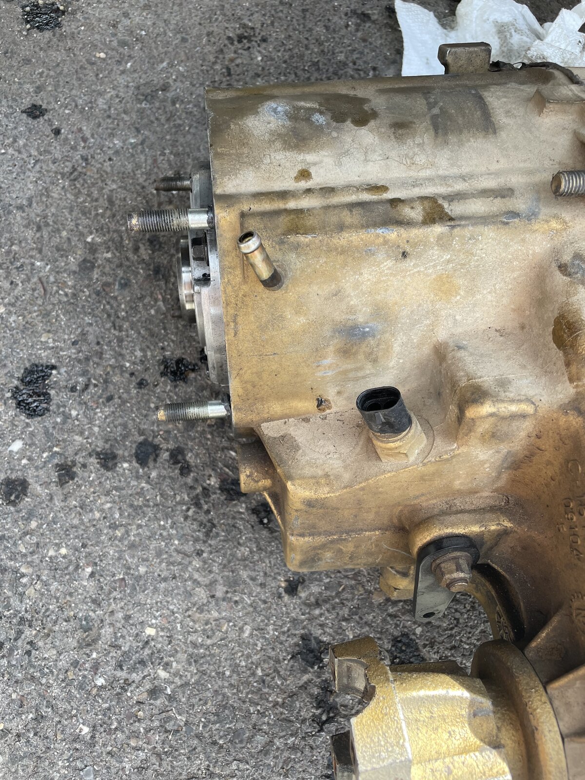

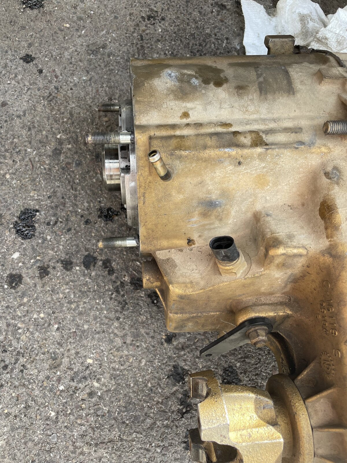

Well my transfer case is fixed. Didn’t have a snap ring on the input shaft so in 4low when running the planetary gears it would just slide inward of the case disengaging the whole gear and only would the shifter fork going back to 2h would it push it back in. That shaft also would move so much that the trans output seal would touch nothing so it was just dumping oil out the back when it happened. Also smashed my shock so bad it turned into a maraca.
Both have been fixed and took a great trip to Kilgore idaho camping. 5th gear is impressive now where 50-70mph it’s usable even going up hills and the elevation. With the gears I’m also getting over 20 miles to gallon. Somewhere in 20-25 miles to the gallon. I’ll have to trip it next time but impressive non the less.

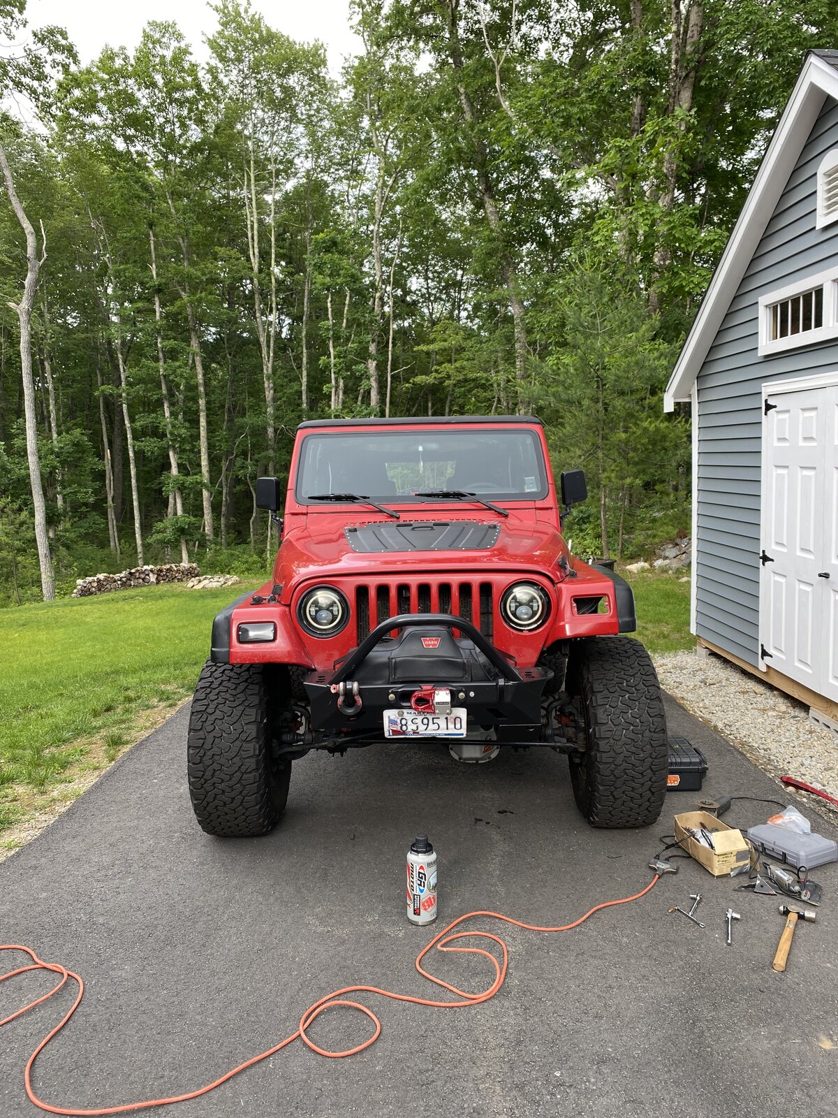

I went ahead and did a Thor cowl intake, as well as I got this square tank for my washer resivoir on Amazon that’s smaller. I didn’t try to see if the stock airbox would fit so I can’t say for that but my buddy got ps highlines and is still using stock washer fluid box so that might be possible but could be the shape of his inner fenders allowing that. I also moved the fuse box just farther inward with just a new drill hole and bolt.
Yes for the shaping around the fender I did crack my paint a bit. My driver side fender is oem while my passanger is some Chinese crap I’ve repainted my self and the oem doesn’t look too bad in my opinion but if you look you can see the cracking on the front face where the bend is really harsh. For my Chinese fender I have paint chipping everywhere with the spot I also smacked it so it hides the paint chipping from the bend but doing the highlines on that crap fender definitely cracked the paint more.
If you’re really good at bending metal and can take you’re time it’ll look fine but for my self with that poo fender this was just a temporary solution to get my tires from trying to rip my flares off when I articulate and it does it very well. I have zero regrets considering it costed basically nothing to do but I will also say that these are temporary till I can afford some genright aluminum.

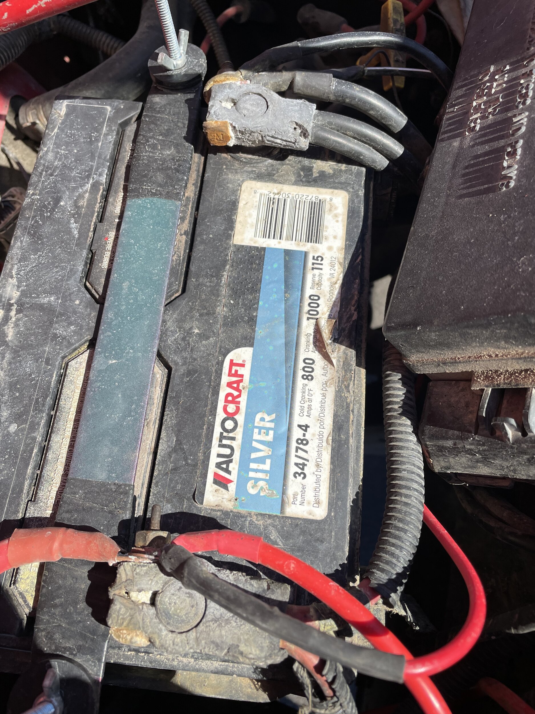

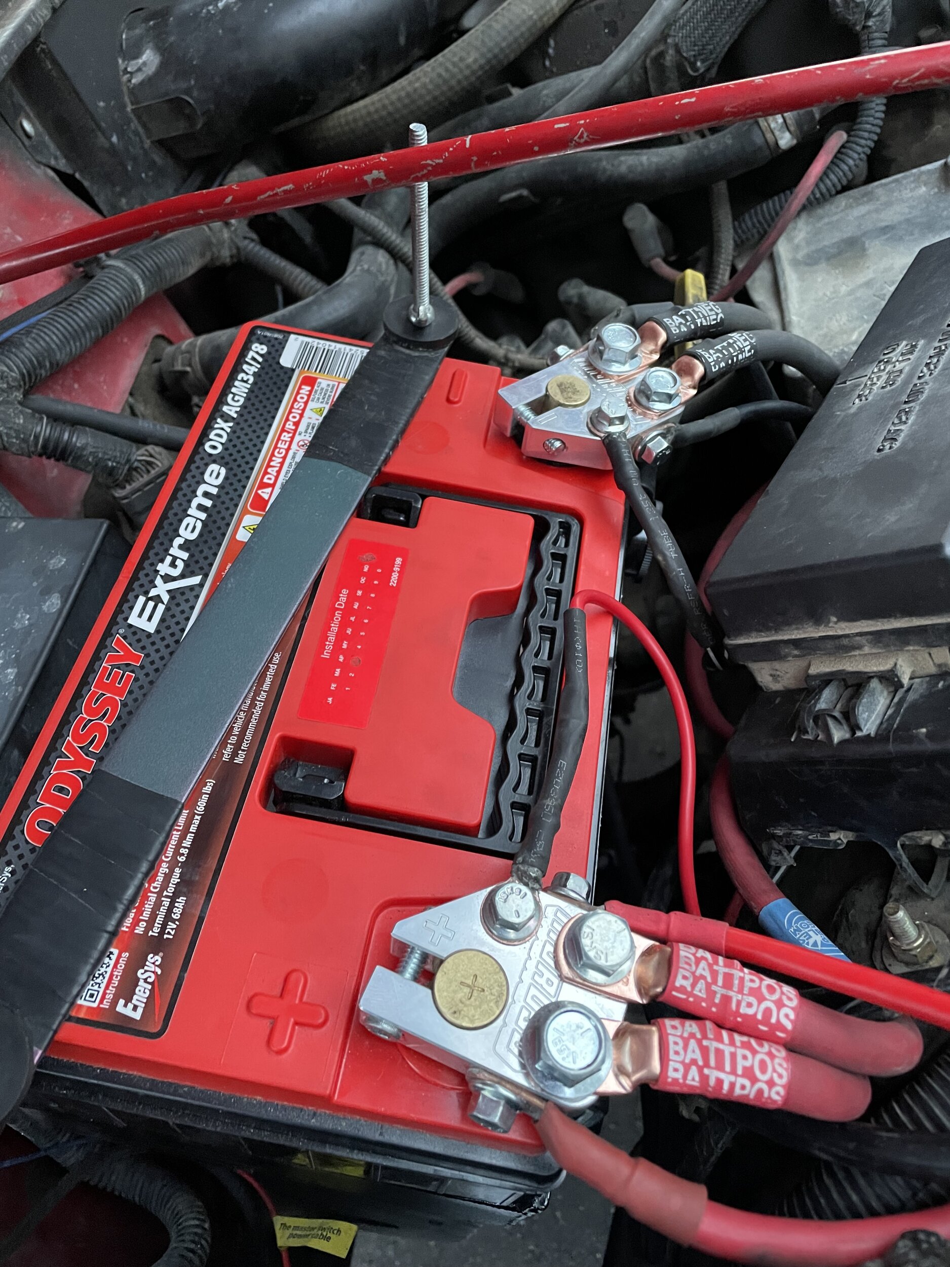

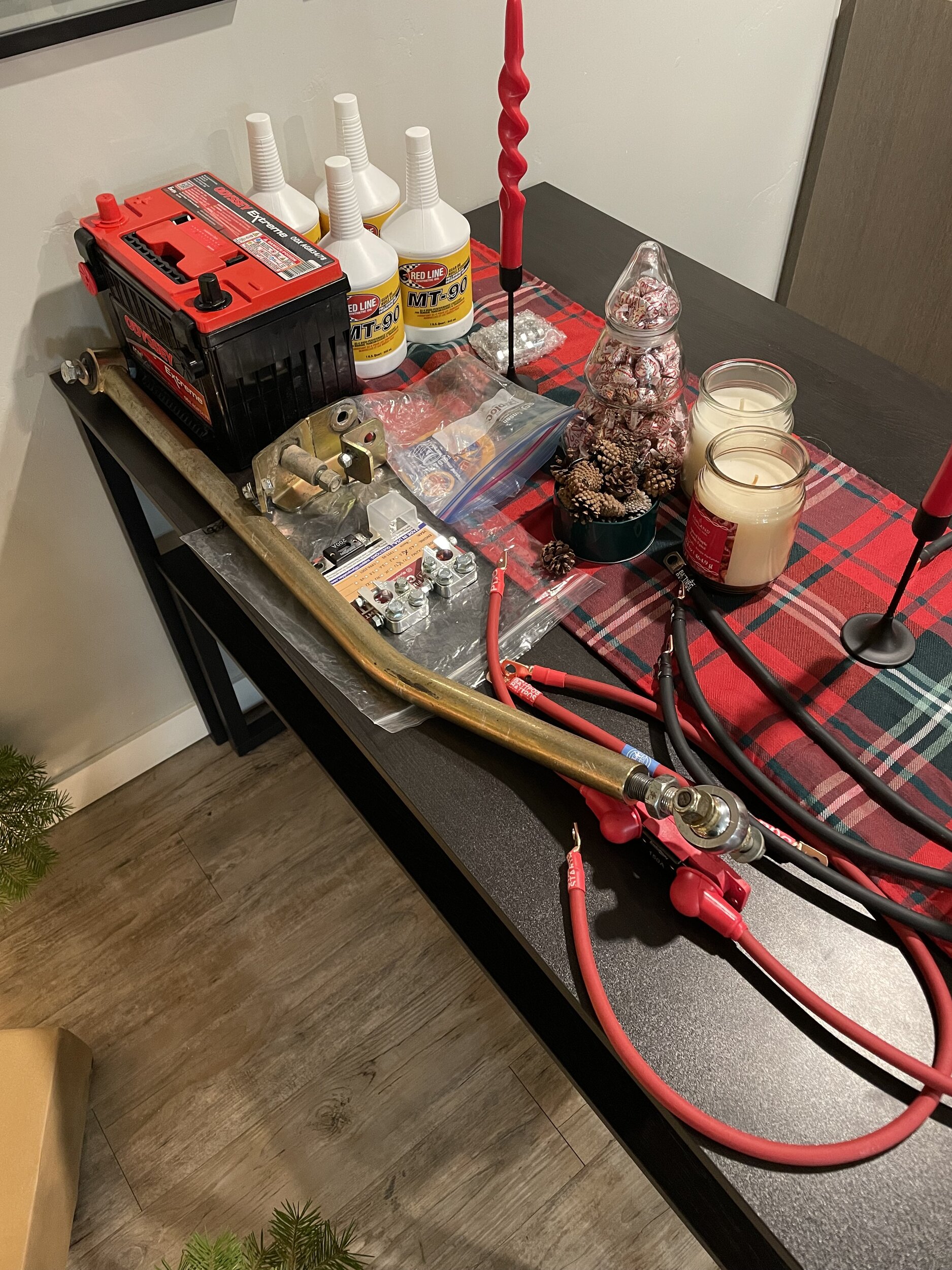

Now as far as the Jeep stuff it came down to doing a genright battery tray, new battery, battery terminals, battery cables and a new metal cloak rear track bar that my dad got me off marketplace since used parts in eastern idaho are non existent. Then also did motor oil which isn’t anything to even mention but did put redline mt-90 in the trans again since this is a junkyard trans a shop put in while I was stuck in Arizona getting my axles and I have no idea what fluid they used. The redline smoothed things up more than I was expecting.
The battery I had was a cheap random brand lead acid which i was already wanted to get rid of bc of the genright mounts the battery at an angle and i was worried that would kill it as well as my winch wasn’t working which i had a hunch it might have been my stock terminals with a crappy mounting and corrosion so i decided to not just to do the battery but terminal connectors which also forced me to do after market cables from JeepCables.
Had to trim the genright tray for the odyssey battery which I was mad bc it fit fine for my old battery and I even powder coated it. The rest of the tray was an easy install and seems to be really nice but will see how much abuse it holds to before I have to brace it off the fender or another spot on the fire wall.
The jeep cables and terminals were super nice to organize all my connections and currently every connection has its own bolt on the terminal connector and with some cleaning the ends off my winch works again. Install was super straightforward for that so nothing to mention about that.

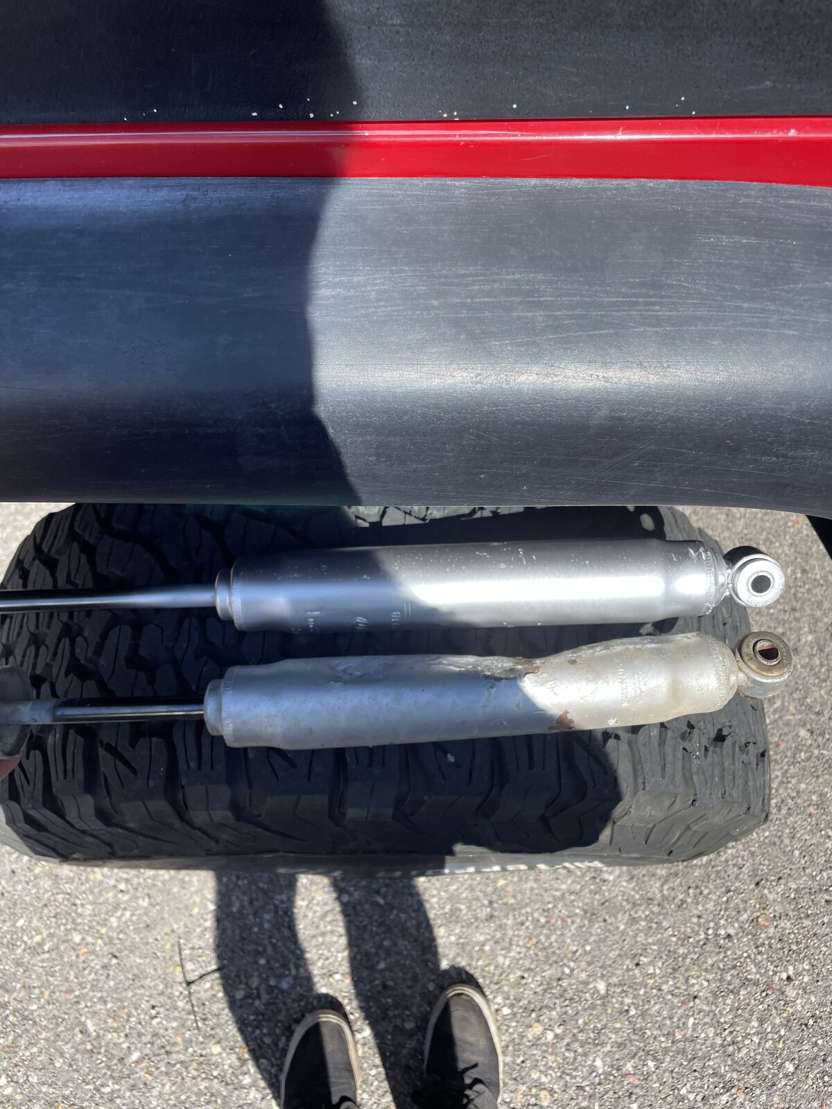

This past few weekends were a blast working on the Jeep. Firstly I completely mangled my exhaust wheeling which also smashed my rear passenger shock yet again ( I think this is my 4th rear passanger bc I’ve smashed it on rocks). Had to cut up my exhaust to make it useable for the time being.

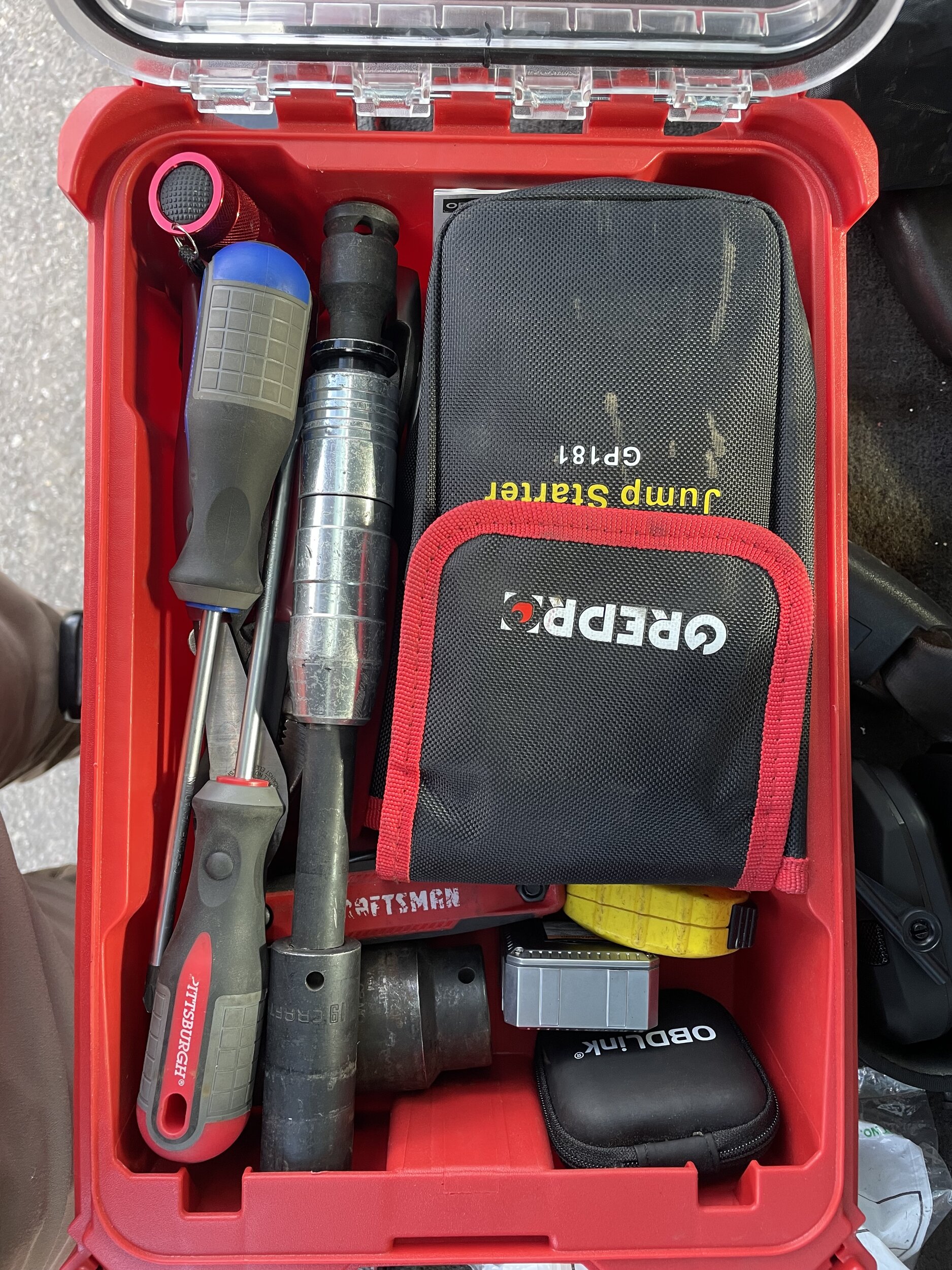

Then I was able to finish my tailgate packout tool set up. I won’t say too much but here a link to why I did it and how it worked but I’ll post a few pics here. Here the link to the packout https://wranglertjforum.com/threads/diy-daily-tools-organization-system.78392/

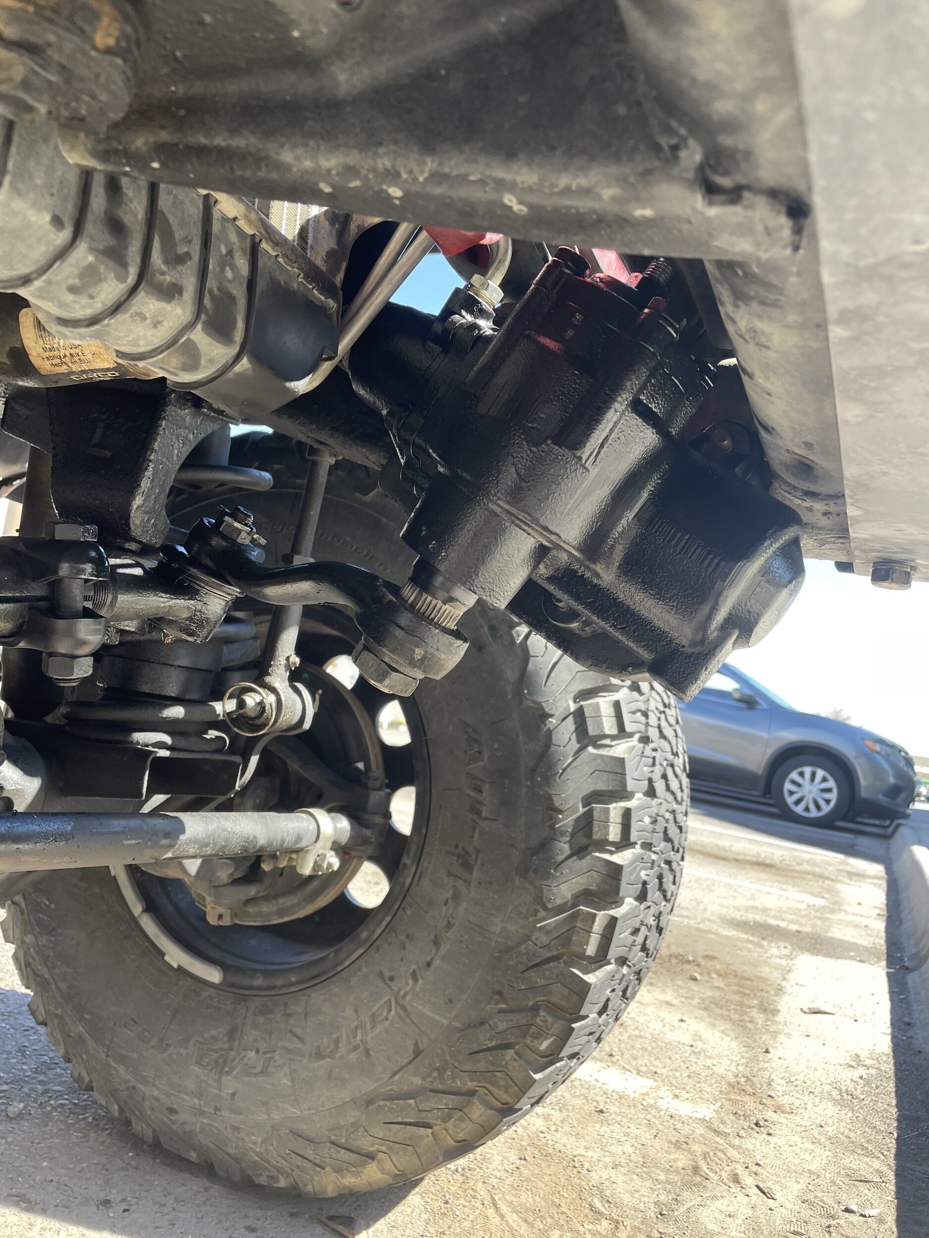

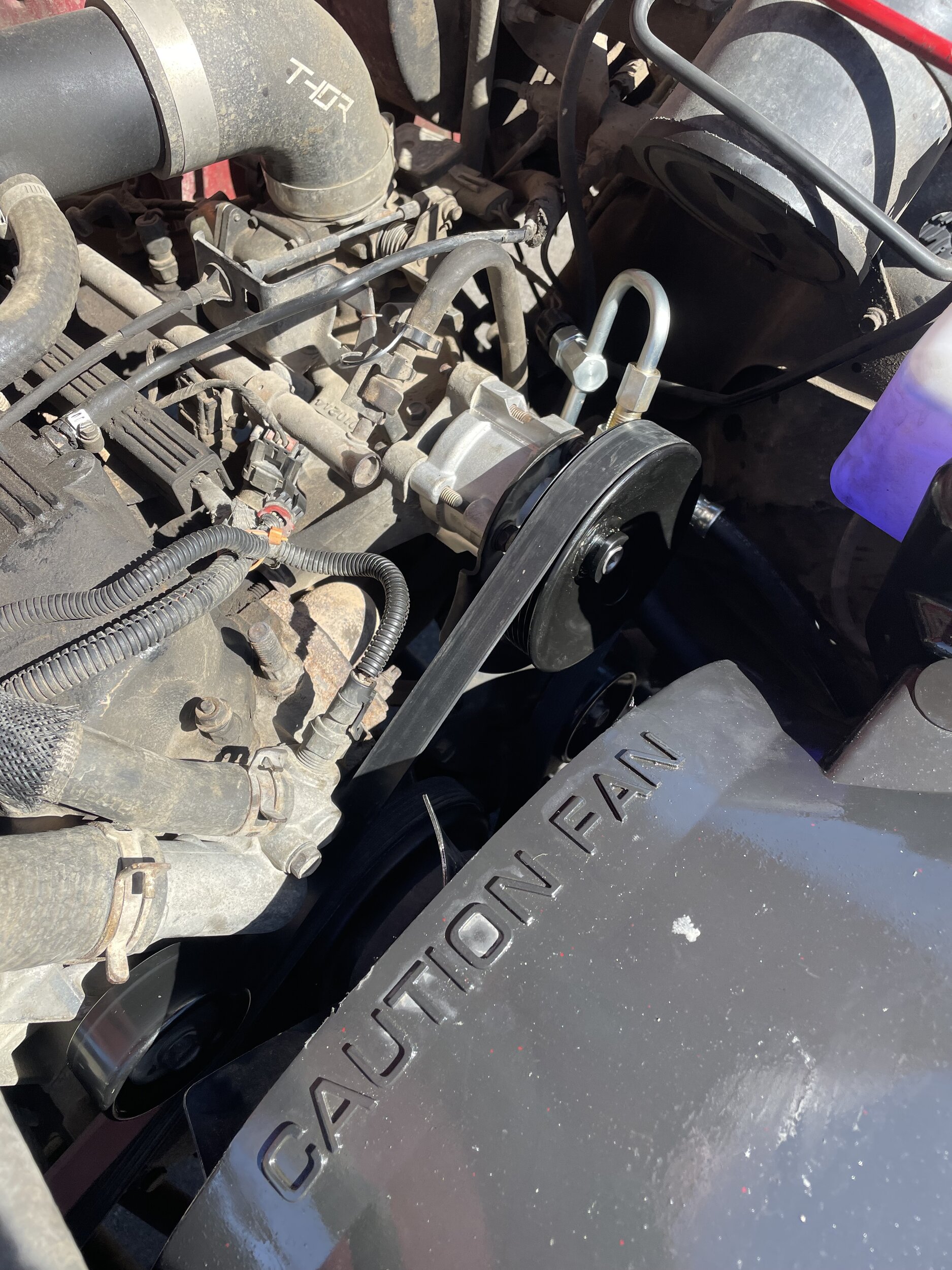

This weekend was all power steering and rock sliders. My power steering box was leaking for a bit and I’ve noticed since it began to leak it got really loose so it was either do a full PSC (Blaine’s cooler but prob would hold off on the assist since I’m only on 33s) as amazing as that kit is the pump, resi, cooler and big bore box would cost close to 3k. For now I did the new lares box off rock auto for 300 and an Edelman pump and lines. Huge improvement over the 200k mile leaky box and pump I had.

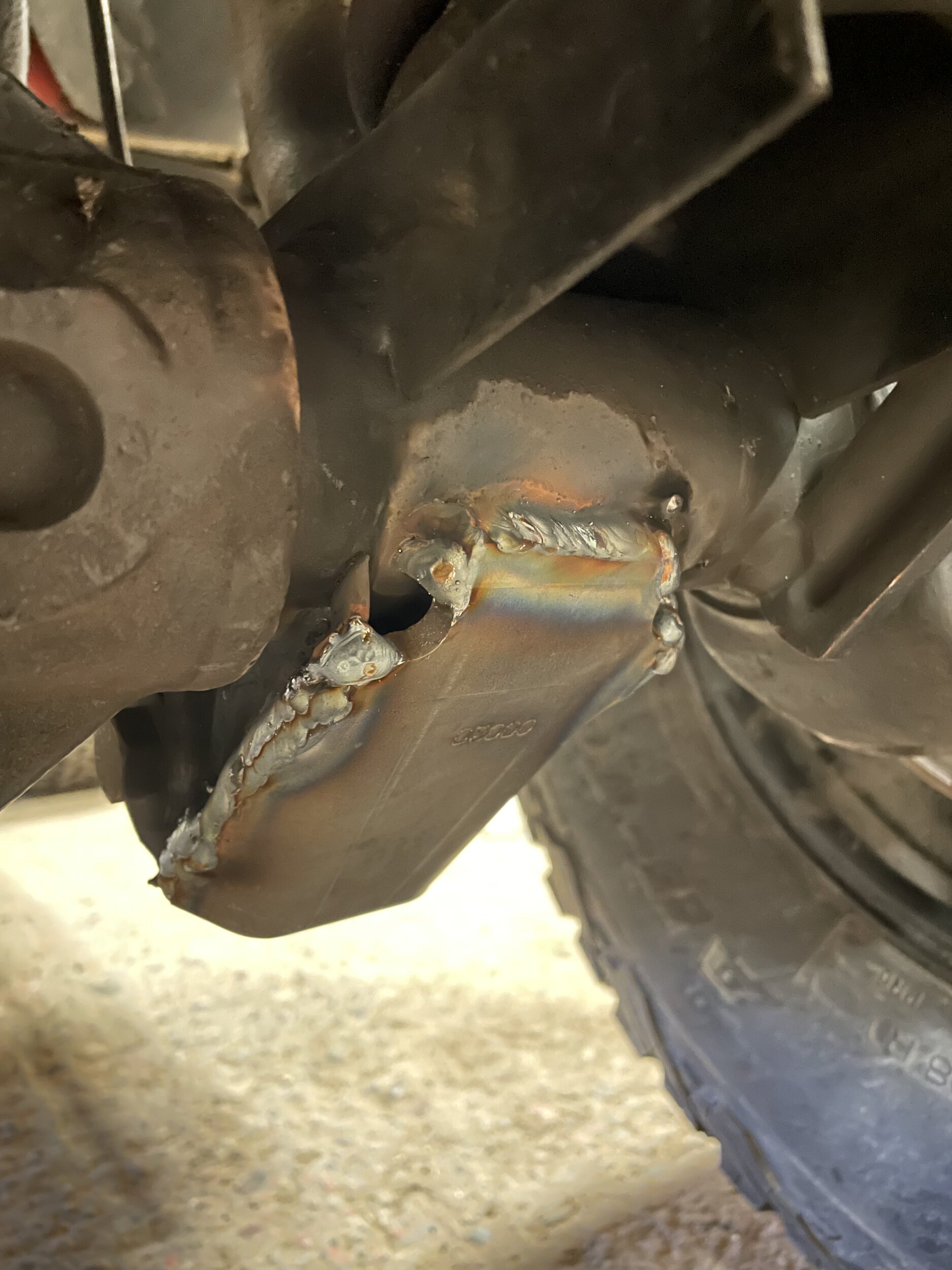

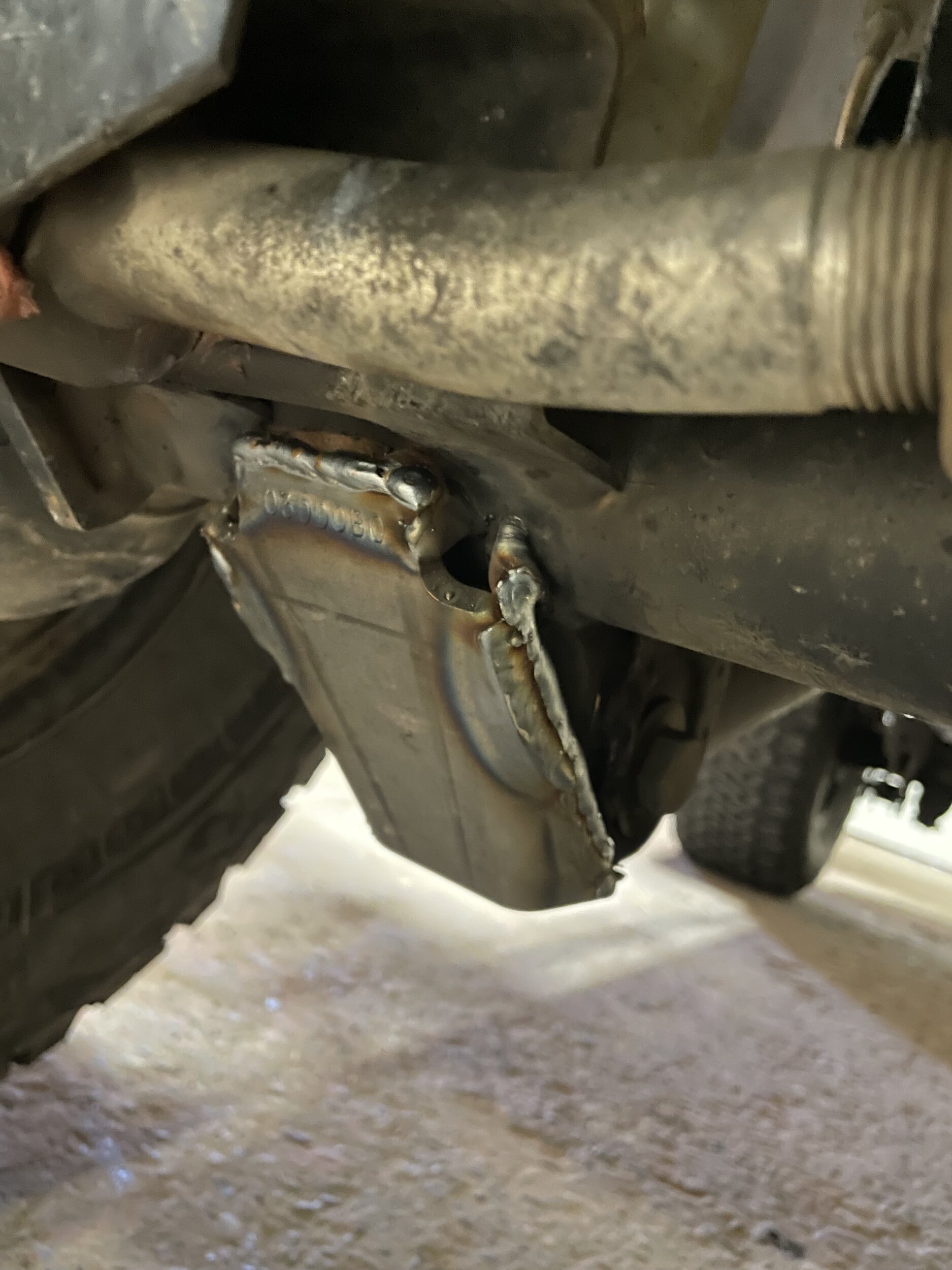

Forgot I also welded in some Currie mini skids. Tried to do a double pass on them after they cooled and the second pass made it look like poo. I’m no welder but I like to try and do a good job at everything I can but a lot to improve here still. Was trying to not to go too slow I burn through the original bracket but not sure if I was too fast. Any tips are appreciated.
Not bad. Overhead welding at an angle while laying on your back is not easy. With that, it looks like you might be moving too fast. Your first weld was probably very convex so the second pass just piled on top.
The trick to making multiple pass welds is to make sure you prep the previous weld with a grinder. I like to make a little groove down the middle of my weld path. This gives me a visual line to follow & gives the weld better penetration.
@AirborneTexasRanger has been good at picking apart welds. He might have some tips for you!
It's what I do best 🤪
That makes a lot of sense, thank you. Did I really need a second pass on those in the first place?

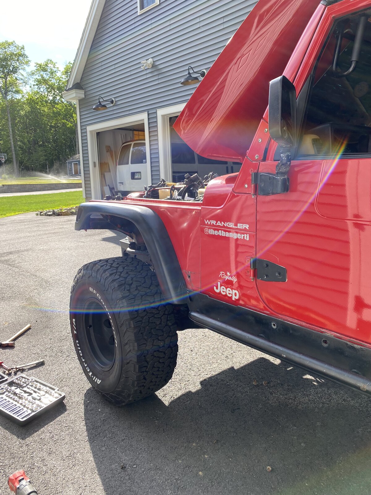

Added new late model mirrors on the full doors. The original ones were cracked around the housing so I was unable to tighten the adjustment. Every time the doors closed they would move so I just got tired of it. While I was there I adjusted the door hinges as they seemed to have moved just a bit making it little hard to close.

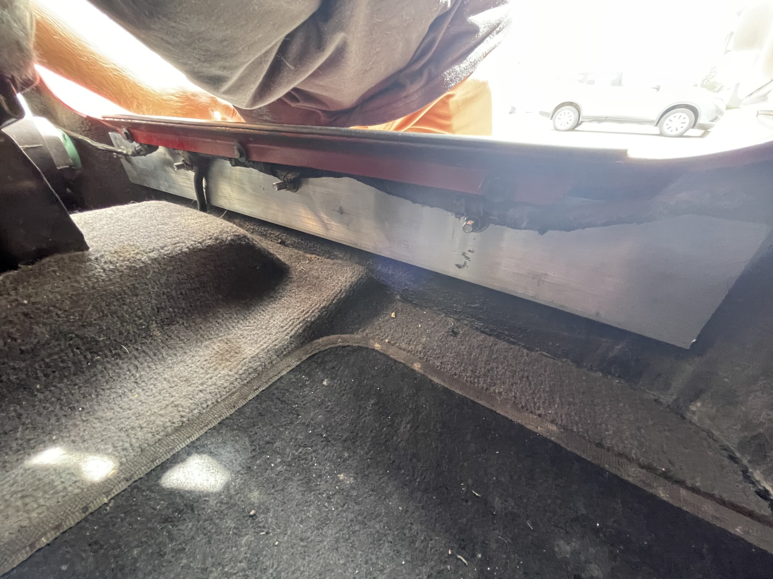

Then I made the backing plate out of 3/8 3in wide by 30in long 6061 flat bar which was cut down to 29in to fit. Set up, marked for holes, then drilled. Pretty easy to do and it was very apparent to see the benefit of such a large and thick surface area as you could see the whole tub and slider pull together and make almost no gap between the 2 rather than it pulling only a section of tub. I could have fit a 4in wide flat bar but was unable to find some. I also see how the savvy have another row of bolts below the top edge making it i believe 8 bolts through the tub and backing plate which is super cool to see so many points but I think the reinforcements made to these will serve me well.
It was fun to get looks from my neighbors in the apartment complex watch me vacuum up my aluminum shavings that were all in the grass from cutting and drilling.

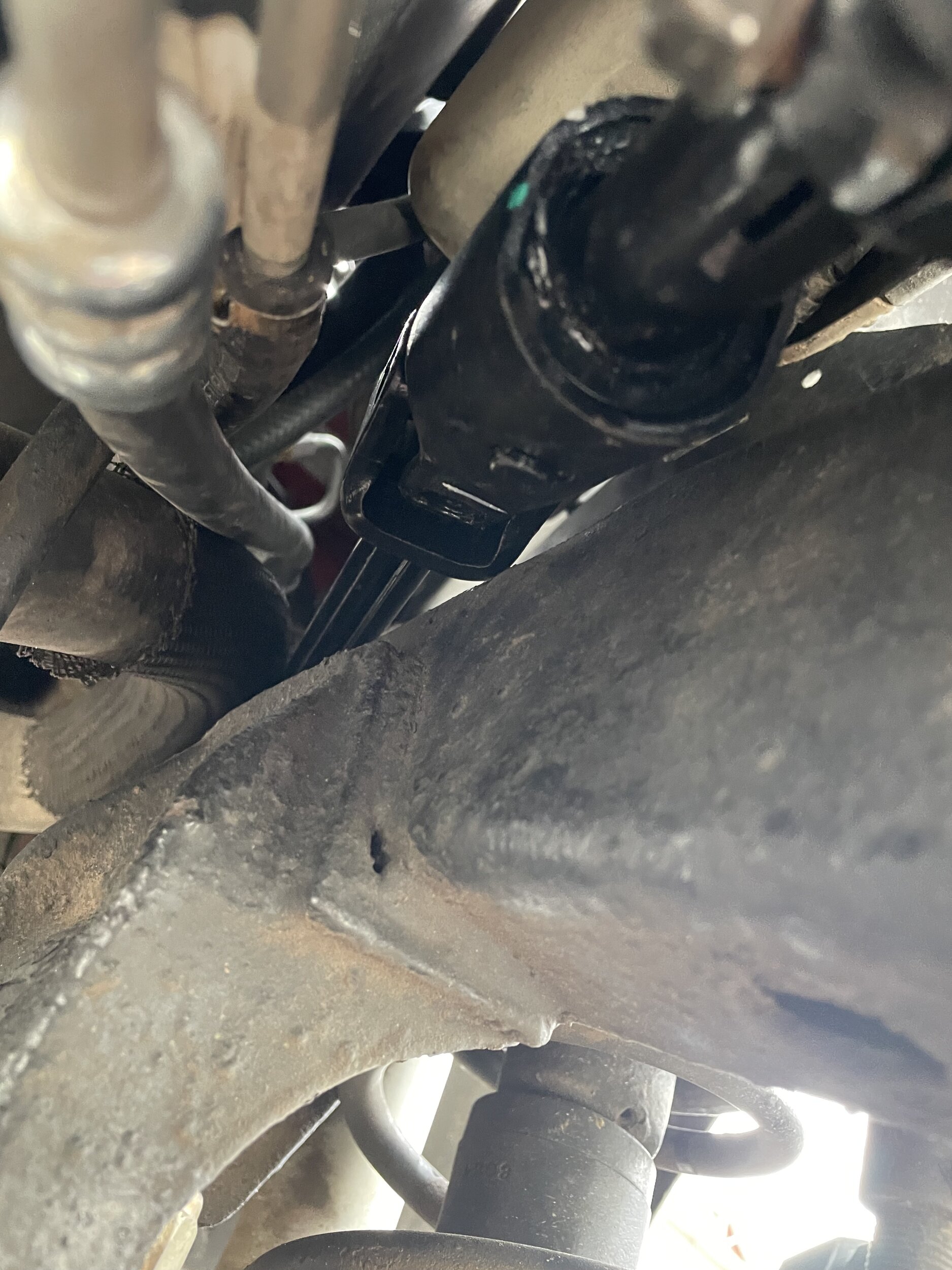

Also swapped out the lower steering shaft yesterday. Pretty easy but would have been a lot easier if it did it at the same time as the steering box so I didn’t have to remove the mounting bracket that holds the bearing. Way tighter now so I really have zero steering wheel movement that isn’t moving the jeep too so it’s pretty sick but I have a slight issue and I’m not totally sure how to solve it.
The u joint section just above the the steering box will just barely hit the frame when turning. I only swapped the steering shaft and didn’t change anything else so I’m confused as to why it’s doing it with this replacement and not the oem one I had in. They look identical. It’s just enough of a touch that if I let the caster center the wheel after a tight turn it’ll get stuck just enough that it will stop but any finger pressure moves it but it’s annoying to feel resistance when turning. Do I let it self clearance? Do I pull it out and angle grind where it’s hitting? I really don’t want to pull it out again if I don’t have too. I loosened all connections moved them and retighten, but it still hits just a bit.
