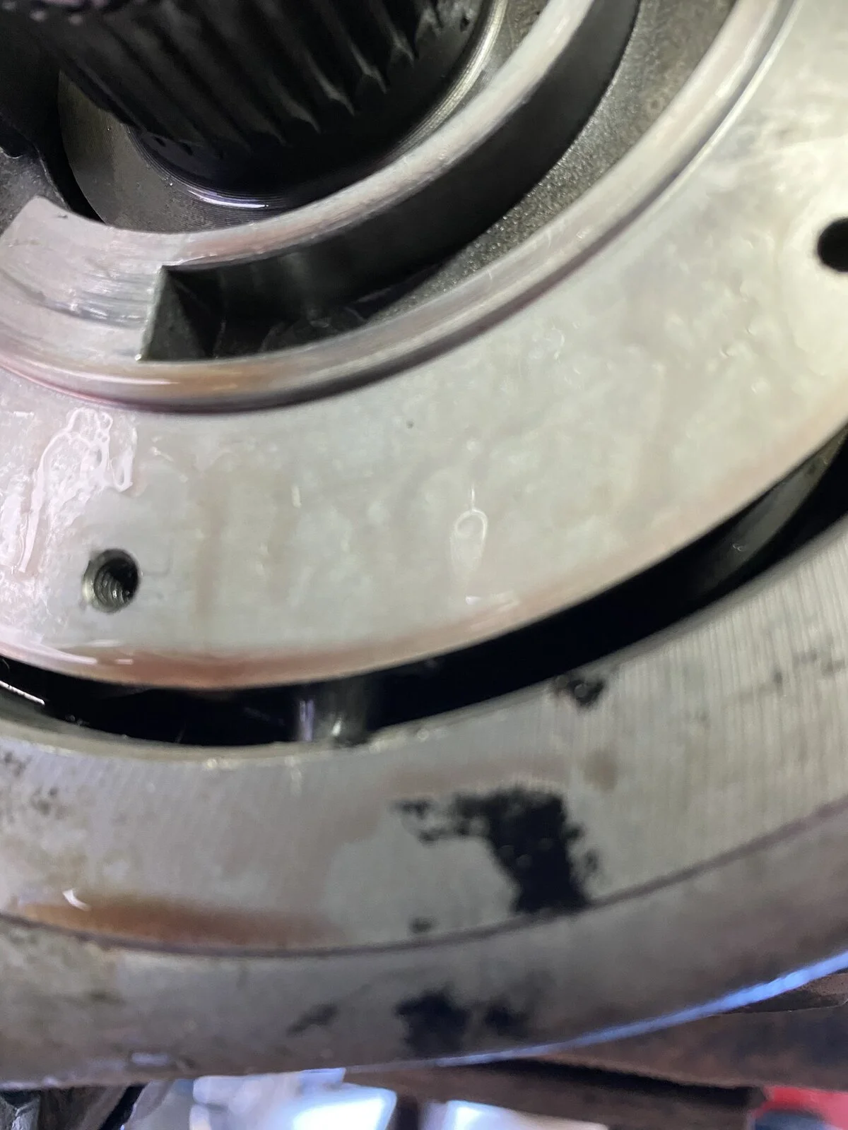

Hi Jerry, question for you…
I’m pretty much done with my sye install and I’ve ran into the same ordeal as qslim posted. My concern is the transfer case oil line tube to the pump. I’ll just quote qslim’s post as it sums up my same issue. Your opinion or anyone else’s would be great! Thanks in advance!

I worked a little on my SYE today, got the back half of the case back on and as I was giving it a look over later I noticed the oil feed tube going to the oil pump - looks like it dropped down out of the pump a little bit? I think the flange of the tube isn’t up against the pump. The tube is still there & I don’t see the o-ring so I assume it is too (it was definitely in there when I assembled it). Is this how they normally sit or am I taking this thing back apart?

Hard to tell from your picture, if it did fall out, you can take a flat head and carefully pry it back up until you feel the o ring seat.
