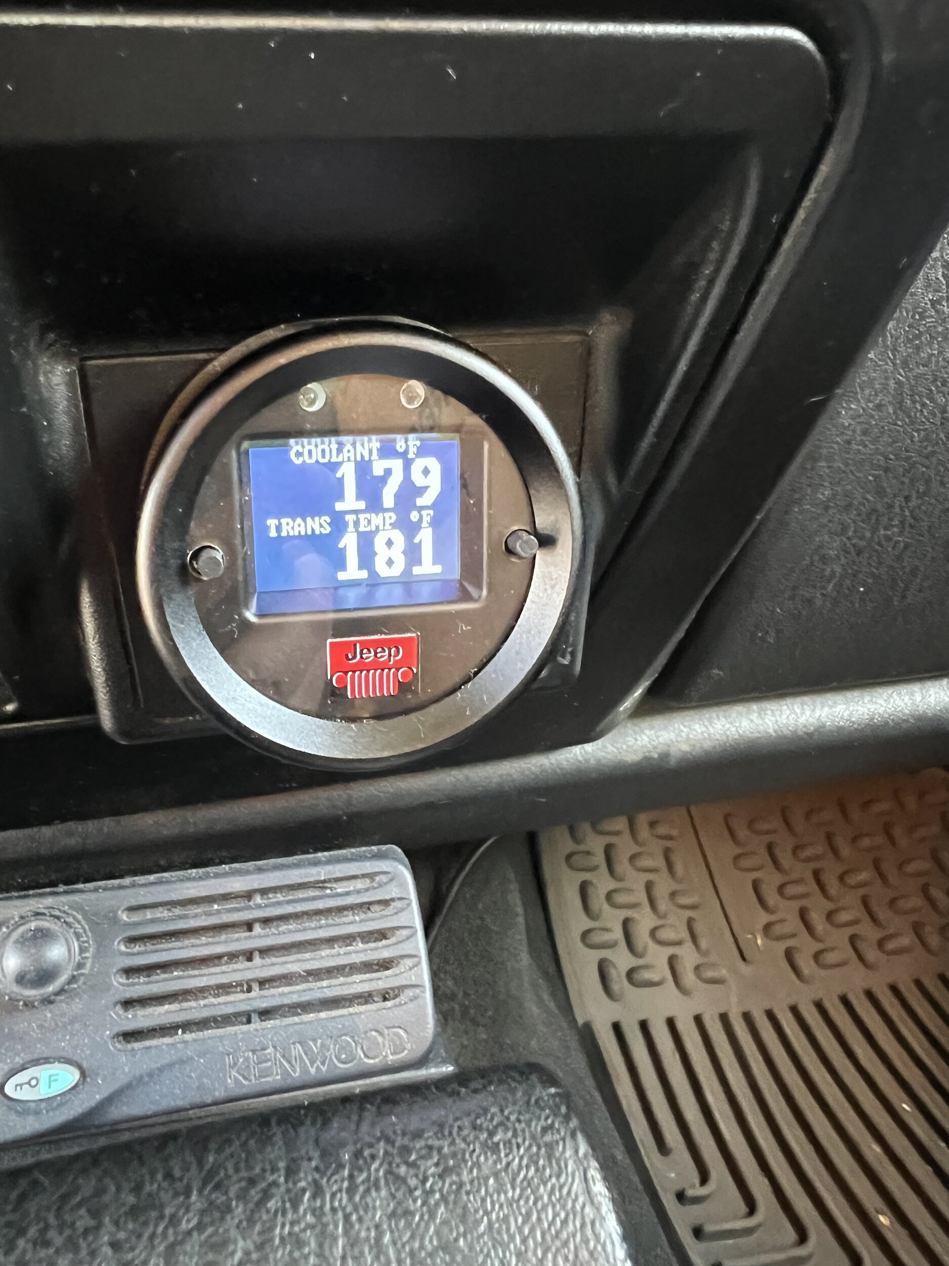

Installed the 150* thermo switch this evening when ambient temps were around 95*.
The fan turned on when my temp gauge read 165*.
The fan kept the temps mostly in the 170s and the hottest I saw was 184*. I realize temps will be higher under more load on a hot day, but these results are much better than constantly seeing over 200* like I had been.
Edit: The switch appears to close when the pan reads 165* and opens when the pan reads 150*. It’s been pretty consistent so far.

The fan doesn’t keep the trans from getting to 170-180, but so far it helps keep the temps from climbing to 200* under load.

Drove around in the heat and sun today. Ambient temps were 100* but felt much hotter in the desert sun.
Normal local driving in light boost and many stops had me between 168-175.
My idle after spirited pulls in boost had me in the 180s. If I drove around rather than idle the temp dropped back to the mid 170s.
After parking the temps hit 190, dropped to 188, then went back to 190 where it held until I turned off the vehicle about 30 seconds later.

Wanted to update how the temps have been with the 150* switch while desert temps have been around 100 degrees.
The switch has turned the fan on when the trans temp is between 150* and 158* if the transmission hasn’t been worked hard. This has helped keep the temp in the 160s longer by coming on sooner, and the fan hasn’t had any issues with running often.
The switch always turns the fan on no later than when the trans temps reaches 165-167 which I’m very happy with.
Regarding max temps overall, I’ve yet to see the temps get past 192* and that was only for a split second idling before I shut off the vehicle.
My reported trans temps usually fall between 174-185 once I’ve been driving for a while and on the throttle pretty good. I’m pretty happy with things.
