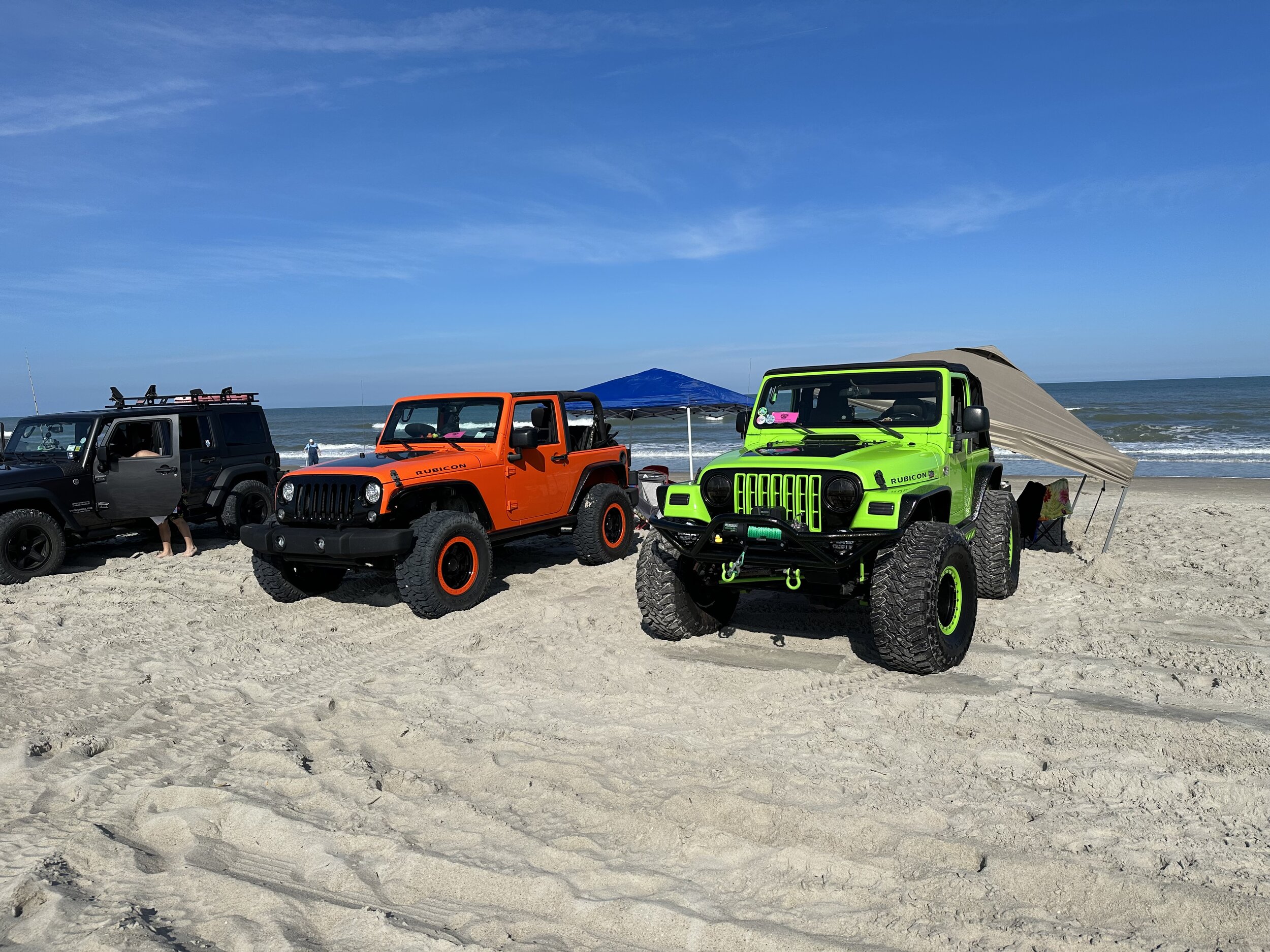

The Jeep in question is the green TJ, next to my orange JK
