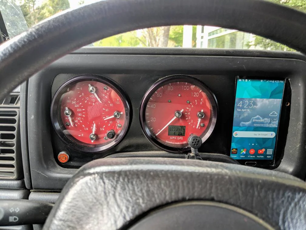

Still thinking through stock vs aftermarket gauges, what are your drawbacks of aftermarket gauges besides the cost?
You'll have to keep Jeep's ECU to make the stock gauge cluster work. Even with that you'll run into issues with RPM gauge. After all the adapters and other stuff to make it work, it might just be the same cost as aftermarket gauges.
I have nothing bad to say about my SpeedHut gauges. I even made Galaxy S5 phone as part of the gauge cluster.
I get caught up on the small details. What did you do for turn signals, high beams, check engine light, e brake light, low fuel light, 4wd light?
  • Turn signals, high beams ... all wired into Chevy's fuse box and part of custom gauges.
  • Check engine light ... from Chevy's ECU
  • Low fuel light ... part of custom gauges
  • No need for e-brake and 4wd light
Makes sense. Does your check engine light have an actual light on your dash?
Yup .. it is required to be in working condition to pass the emissions test.
Exactly that one ...

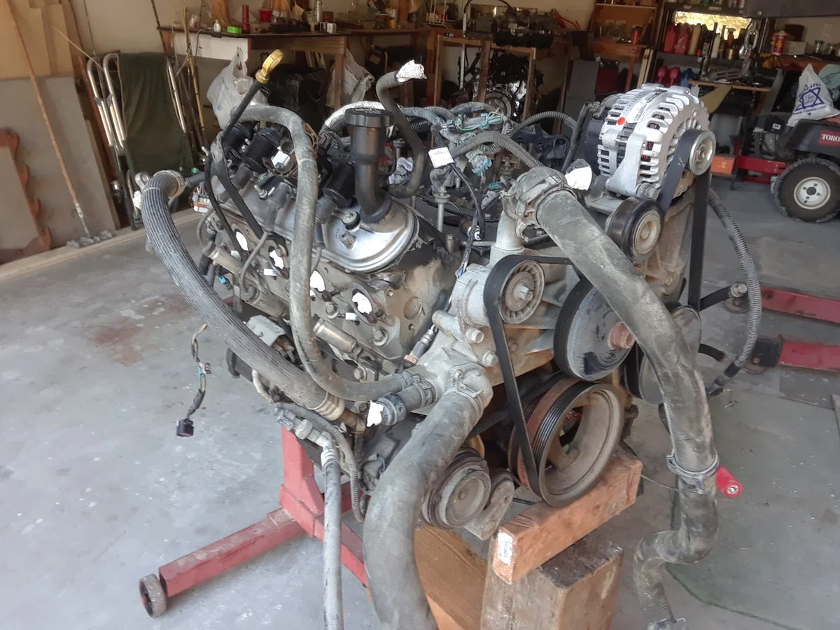

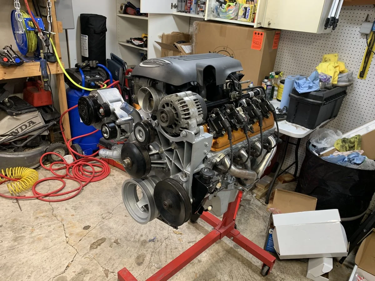

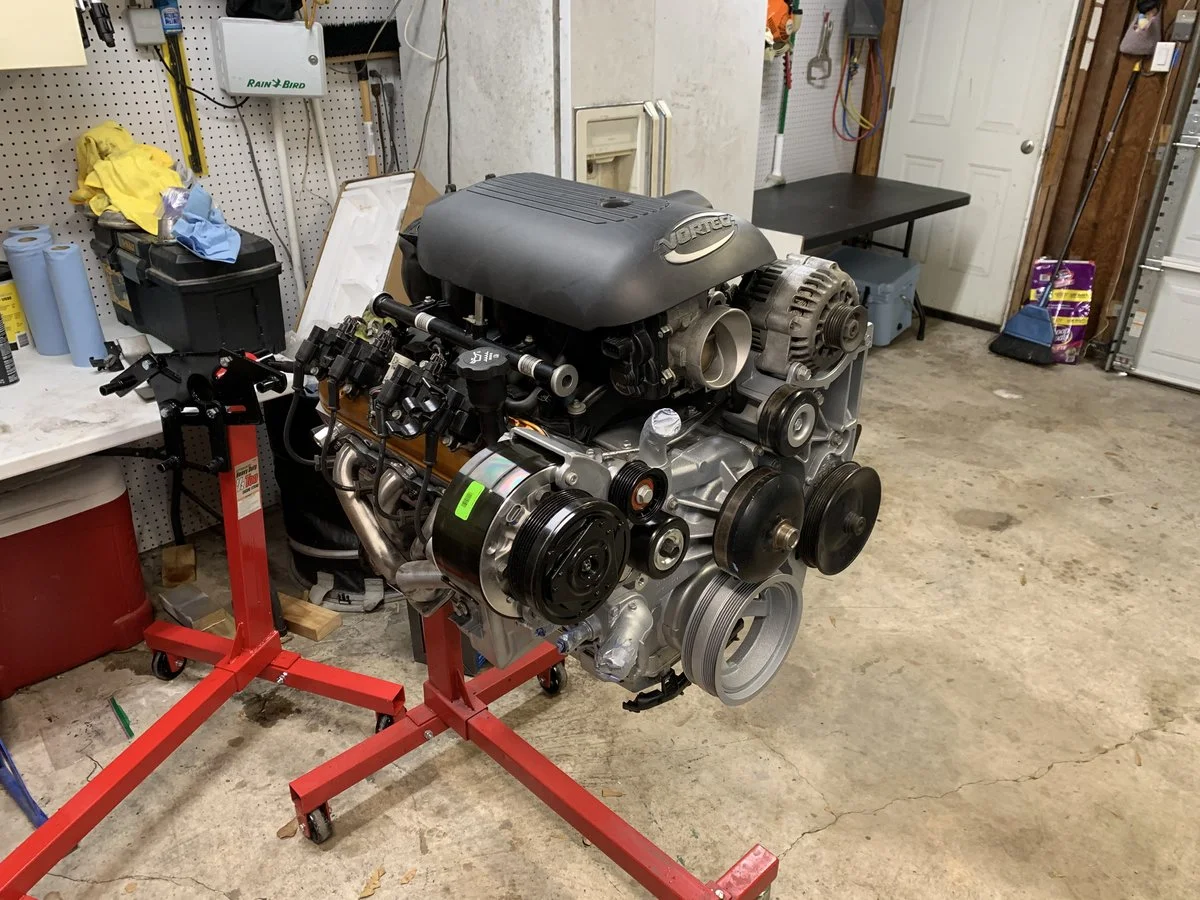

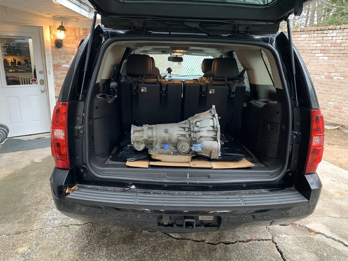

Here’s the latest. I started a build thread post but unfortunately I started on a different forum not really thinking. I’ll share updates here but still run the full post elsewhere. Getting ready to pull 4.0 and tranny is going to get rebuilt (with upgrades to weak points).
