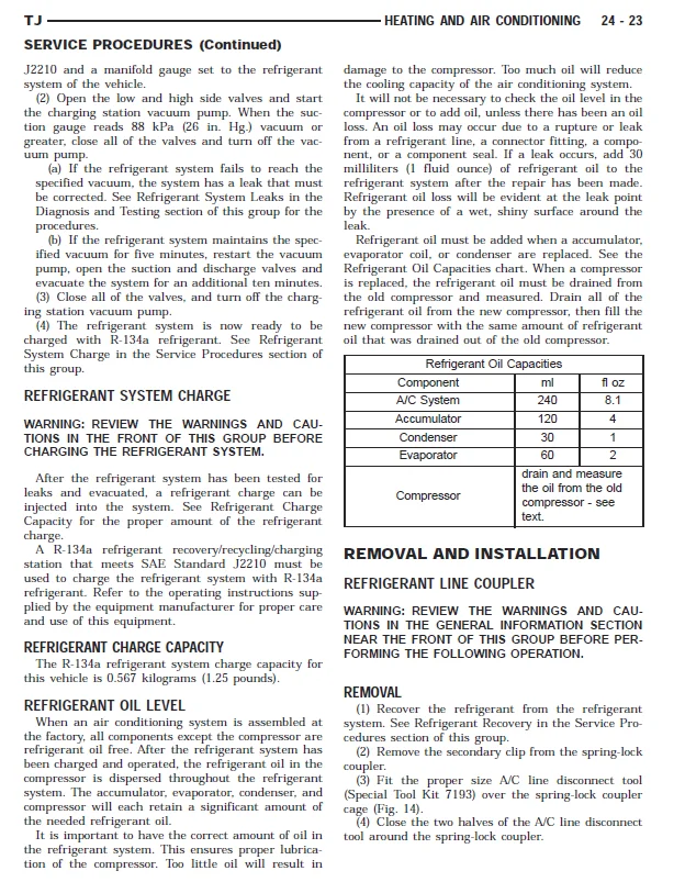

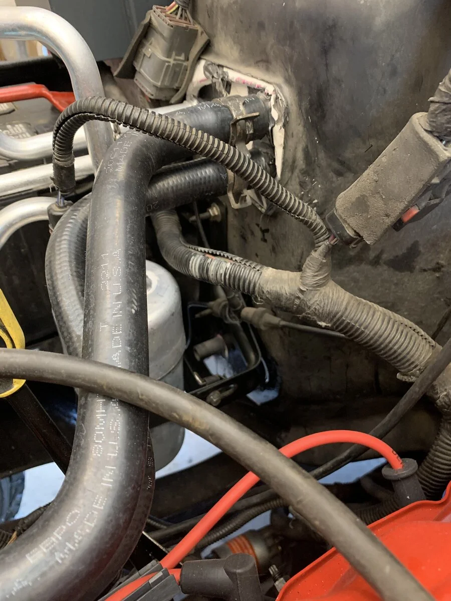

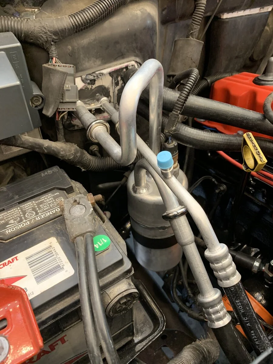

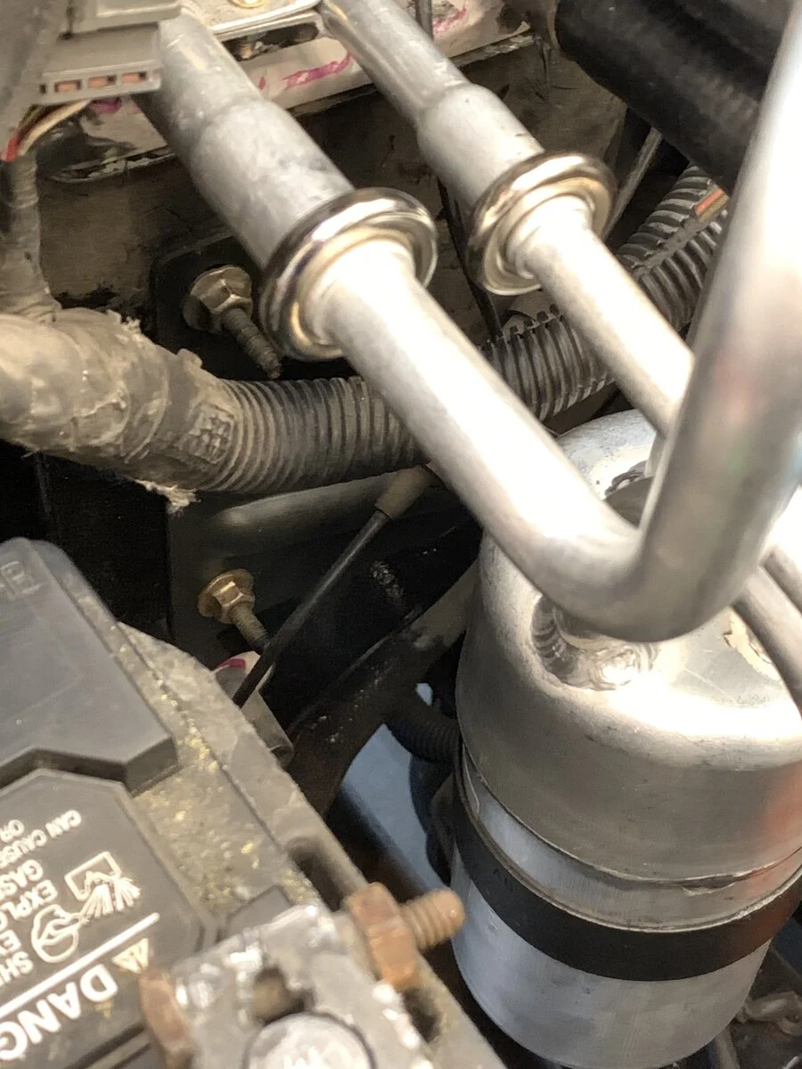

Hi All, I'm Matt and this is my first post. My TJ has factory air, but was not working when I got it. And from the looks of the system it has not ran for awhile. The interior control box was jacked (bought a used one) and the compressor was frozen. The engine was running with a non-ac serpentine belt. I'm sure I will find more issues as this project progresses so I will give a history of what I know and where im at. (I do have a question lol)
I purchased a new compressor kit with a new accumulator, suction line, oil, etc. Before I started taking the old system out I hooked up my guages to check for refrigerant. There was none. For kicks I pulled a vacuum down to 29 inHG and it held fine. I also pressurized the system to about 60psi and that also held. I was really just making sure the condenser was not punctured or anything.
The old compressor is out and it has zero oil in it. The old accumulator also has no oil in it. This is no doubt why the compressor froze. I understand there could be oil in the condenser, but this seems unlikely now and I know that the total system takes 8oz of oil. Soooooo.....
How much oil should I be adding to the system? 8oz? Are there any other procedures I should do before putting the new components in in regards to the oil capacity?
Thanks, Matt
