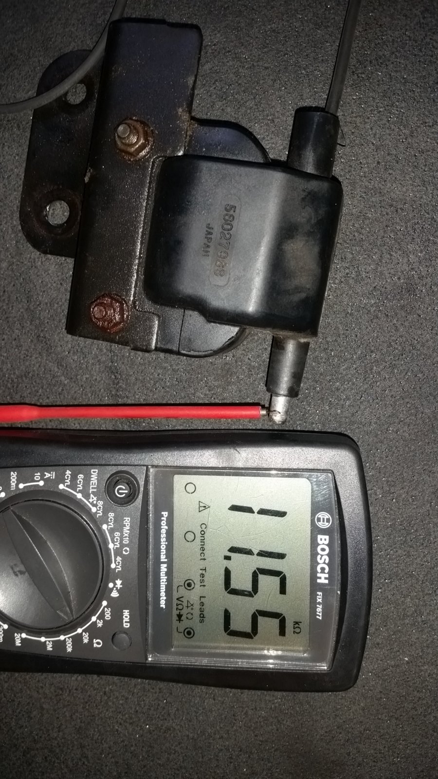

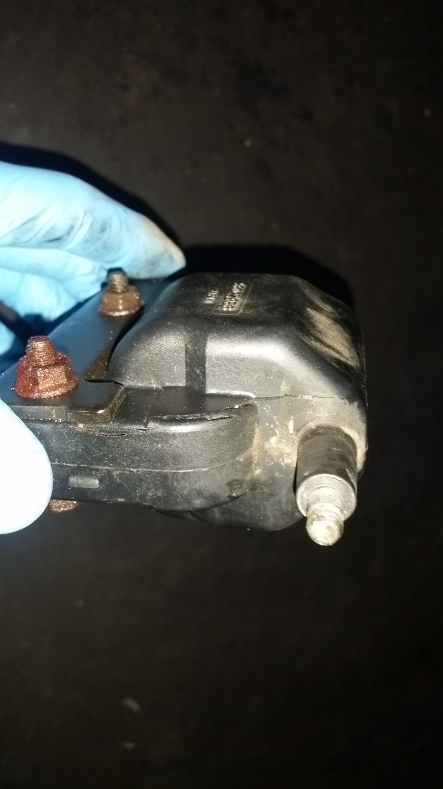

I pulled the king lead off of the distributor, connected a spark tester, connected test leads to the starter terminals, turned the key to ON, and while watching the spark tester I touched the ends of the test leads together, cranking the engine. Spark was present and seemed "reasonably" strong, jumping the large gap in my spark tester. This seemed to tell me that the crankshaft and camshaft position sensors were working.

When I pulled the new plugs to check compression, they were wet with fuel, so perhaps the spark is weak or intermittent. Could I have damaged the coil by spilling some water or coolant on it? That is my next line of inquiry.
