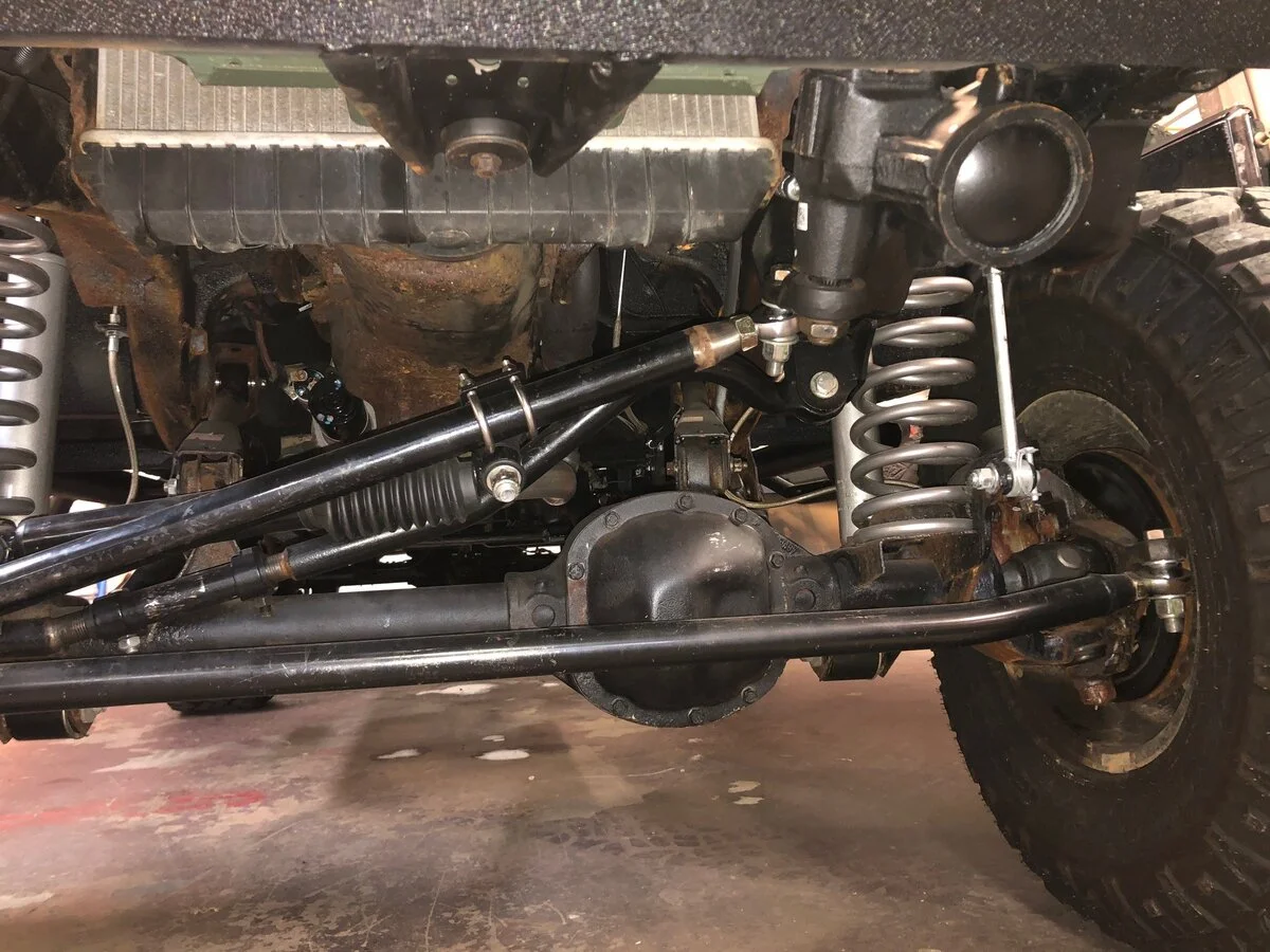

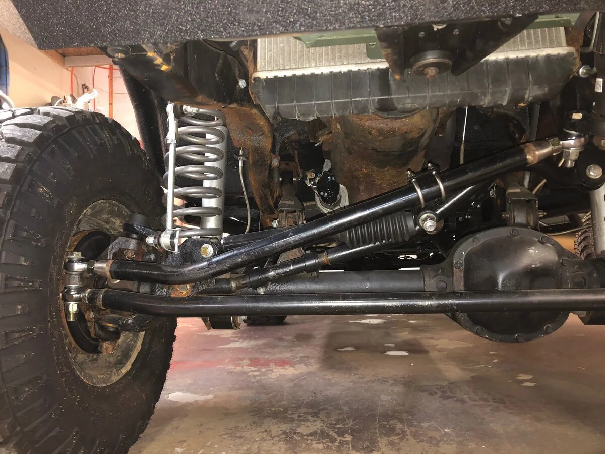

I have a 97 TJ that I have built, body off restoration/build. Installed a Rough Country 6" lift, running 35" Goodyear Wranglers with beadlock wheels. Since I finished the Jeep (back in April of 2020) I have been fighting a steering issue. At first when it got over 25mph it would bump steer. This made me nervous so I spent like way too much time underneath adjusting caster angle. It never really cleared up, so I took it over to 4WP in Charlotte, NC, They adjusted the lower control arms and set a 9 degree caster angle on it. Got it back and while it was improved it is still there, driving down the road and it wanders left and right, I suppose I could be overcorrecting, but it is still there, just doesn't feel safe....
Here is what I have done to thus far;
I have replaced the wheel bearings already.
The upper and lower track bar bolts are torqued to 125 ft/lbs.
I have a Steinjager Crossover steering kit installed with a single steering stabilizer installed (dual steering stabilizer is ordered)
I have installed 2 separate steering gear boxes (finally have one that does not wobble/wiggle)
I retained the factory pittman arm so the drag link and the track bar are as parallel as possible.
All bolts on the upper and lower control arms are torqued to their spec, as well as steering stabilizer bolt and the 5/8" bolts that hold all the heim joints on the steering kit.
We have done everything, including turning the steering wheel with vehicle off and on, no movement on the underside that we can discern.
I have been chasing this issue since April, trying to track down the root cause of this wandering. Could it just be that a 6" lift and 35's causes this behavior and I just need to learn how to deal with it or is there something I am missing? I am wondering if the ball joints are moving as I head down the road just enough to cause this issue, so I am replacing them with Alloy USA Heavy Duty ball joints upper and lower (as I am suspicious if the ones I installed during the build were cheap Chinese made ones)?
Any thoughts would be appreciated. This is starting to drive me bananas! I just want to get out and put some miles on this rig so I can think about hitting the trails!
Thank you,
Mike
