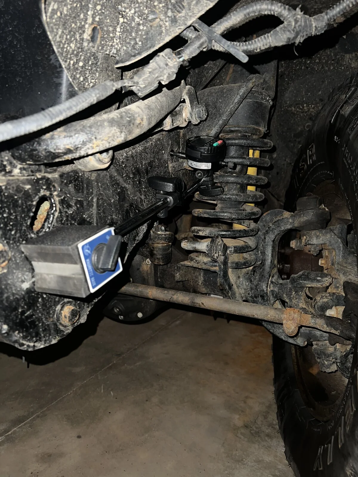

Hello,
I have a 2000 that has tj and the axle moves sideways while cranking the wheel. I have a brand new track bar. It doesn’t have movement. The bushing at the axle is good and snug. My ball joints are all tight. I see the motion most pronounced at the upper control arm axle side. Where would you look next? I can get dial indicators to monitor movement but I don’t know where to look. Thanks for any suggestions. I really don’t want to have to sell the Jeep.

My camera is sitting on the floor, engine on, wheels on the ground, moving the steering back and forth. The track bar to axle doesn’t show movement but the axle is moving. I am so confused. Thanks for any help or ideas.
Here is the other side of the track bar. Is it possible just frame flex? Does it need some gusset to stiffen it?
If your axle and trackbar are moving together (no play), it's probably just the way the tires are grabbing the floor.
Do you have offset wheels or spacers?

No wheel offset or spacer. Factory 15” rim with 31” tire.
Should I lift the front end and repeat the video?
I had to do a plate repair on the front end behind the steering gear. I am questioning if I need a gusset on the outside of the frame behind the steering gear to resist deflection of the frame. It appears in the video the frame is being pushed and pulled by the steering gear movement.
The only other idea is a steering gear brace that ties to the passenger side frame. I am not sure that will provide enough strength.
Thank you for your time. This thing makes me feel crazy!!!

Any other ideas? Sell the Jeep?
I did a custom taboo repair on the front frame where the gear box attaches.
I put a mag bas on the frame where the three bolts hold the steering gear. The other side has a dial indicator. When I crank the wheel, engine on, tires on the ground, I measure .03” movement. I am guessing the frame should move .000. Any ideas?
