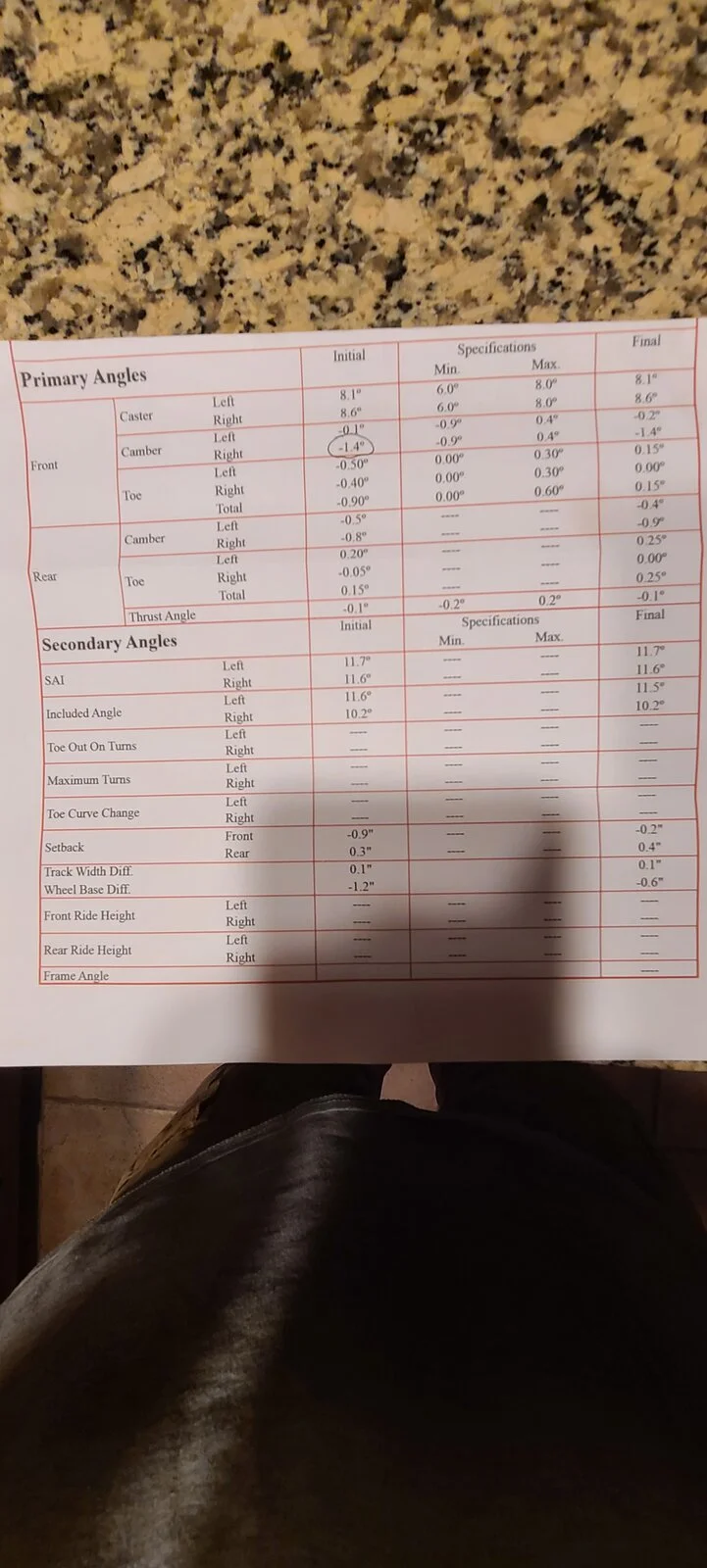

I'm having the same issues, I have a 1998 I bought it with a 4 inch lift already installed. I replaced the stock upper and lower control arms front and rear with adjustable arms, adjustable track bars, drag link and tie rod it has 31's on it and had it aligned. It drives straight but when you go into a slight turn the wheel stays there it won't return to center. If I go into a hard turn either left or right it will return to almost center I still need to help it the rest of the way. Is it possible that I need a new steering box? Everything has been replaced, here are the alignment numbers.
