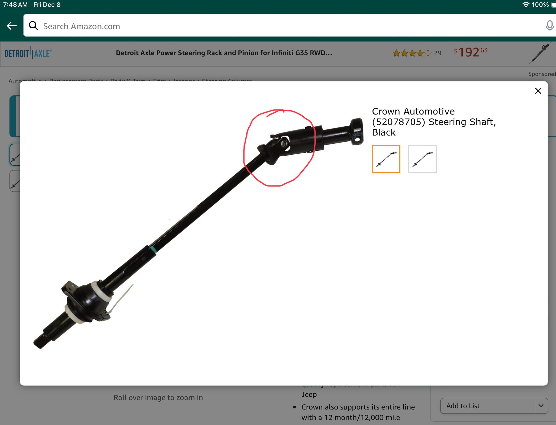

On both my 97’s the little u-joint at the end of the lower steering shaft, before it connects to the input shaft of the gear box, was wore out and had a very little play which equaled a good couple inches of play at the steering wheel… have somebody turn the steering wheel back-and-forth just a little bit and shine a light down there right at the input shaft of the gearbox and watch that u-joint… If there’s play, that could be your problem… it’s hard to see you have to look close…
This video was helpful in ID ing the very last part I need to swap. Ive replaced EVERYTHING except my shafts….and I still have something loose, so its gotta be this joint. $31 off Amazon VS $300+ for a new lower shaft
