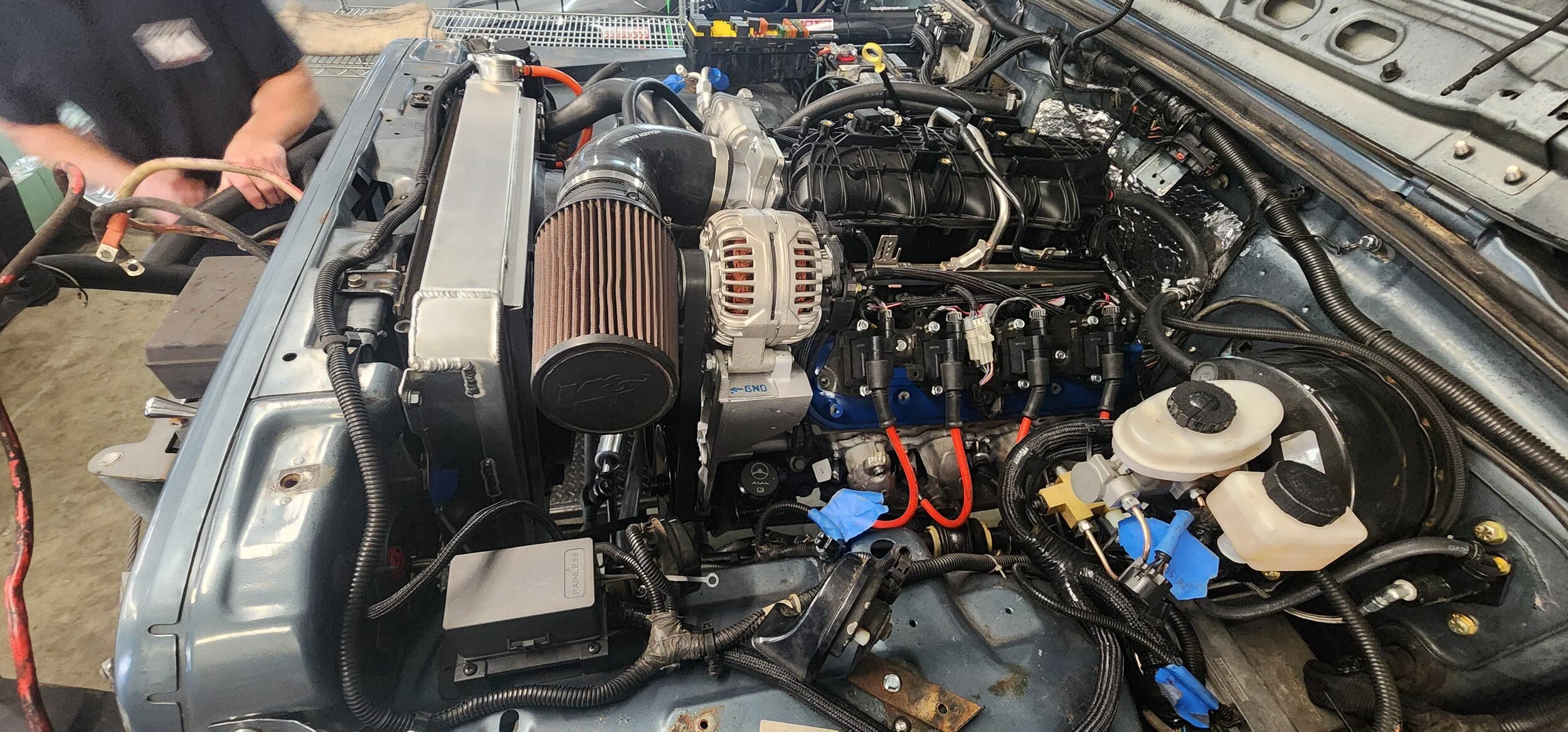

I just finished LS swapping my 98 TJ.
I have a LM7 5.3L LS with a TR6060 231np upgraded with upgraded dana 44s on 33s with a 4 inch lift It's a light off road/Street jeep and fun to drive.
About the only thing remaining from the jeep is the tub and the steering column and the climate control panel.

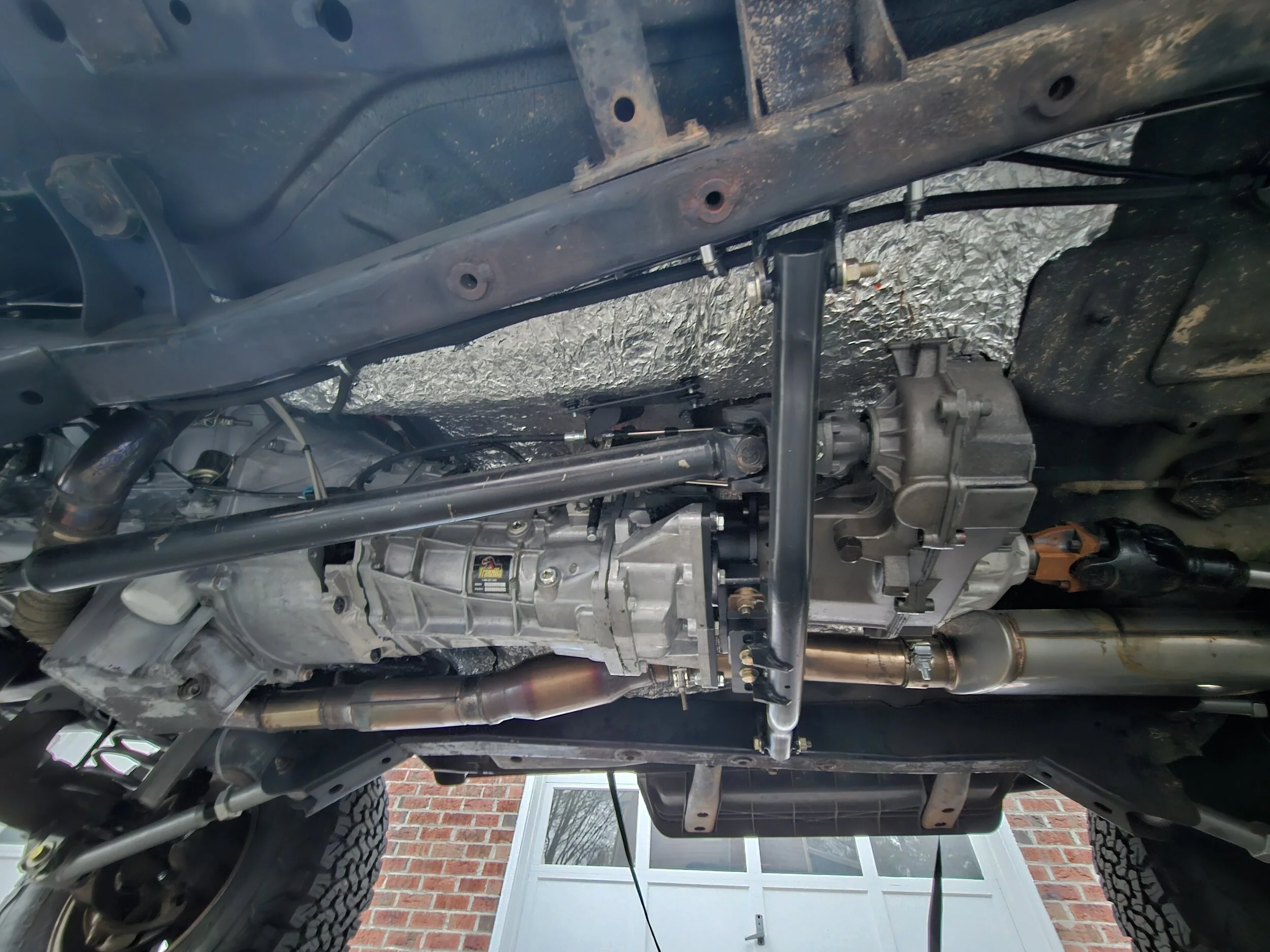

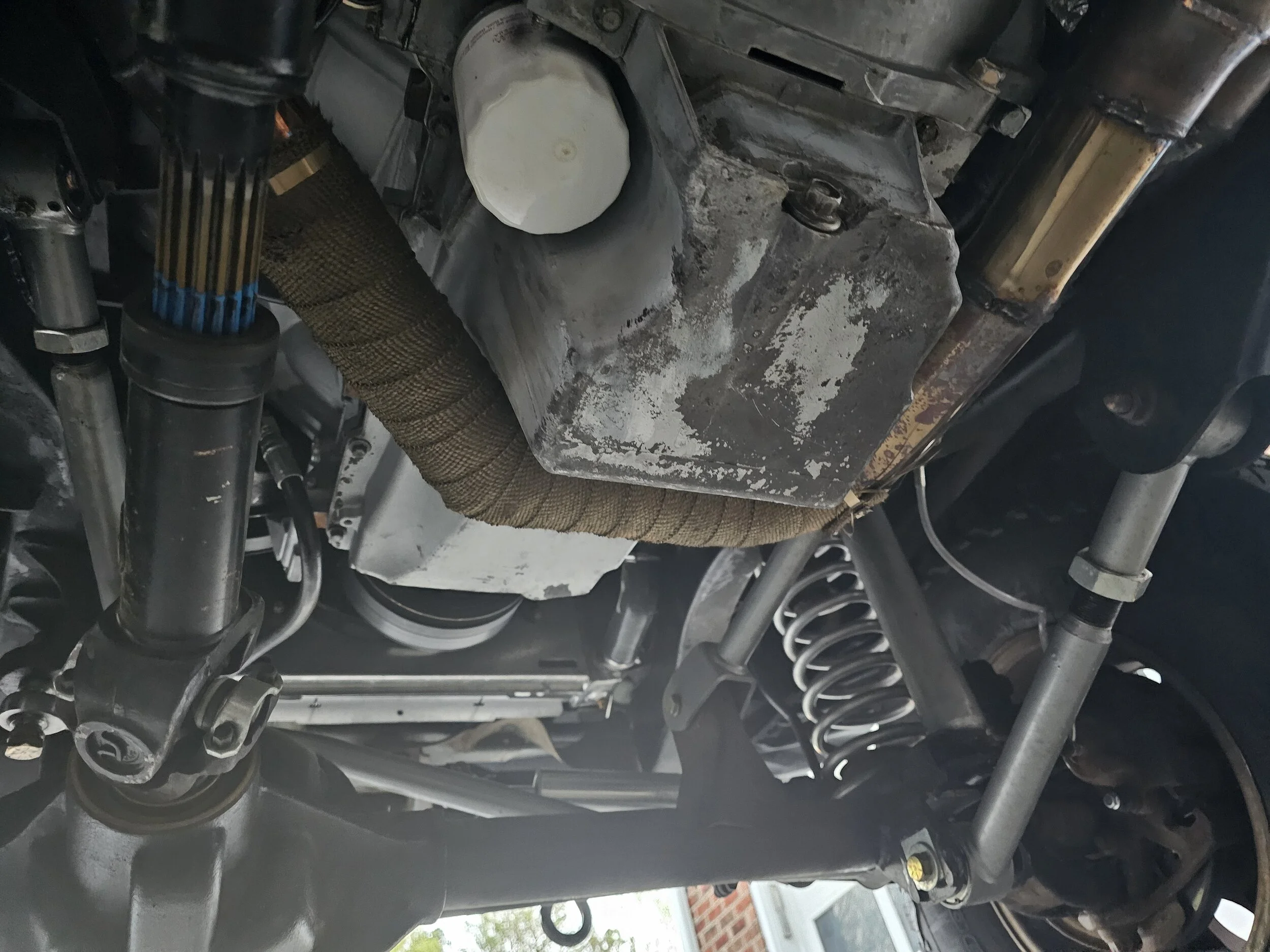

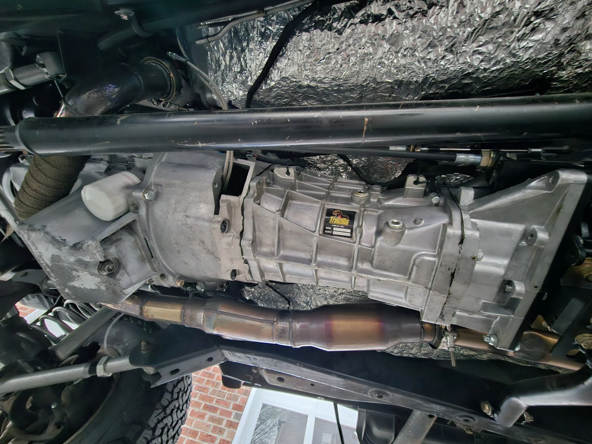

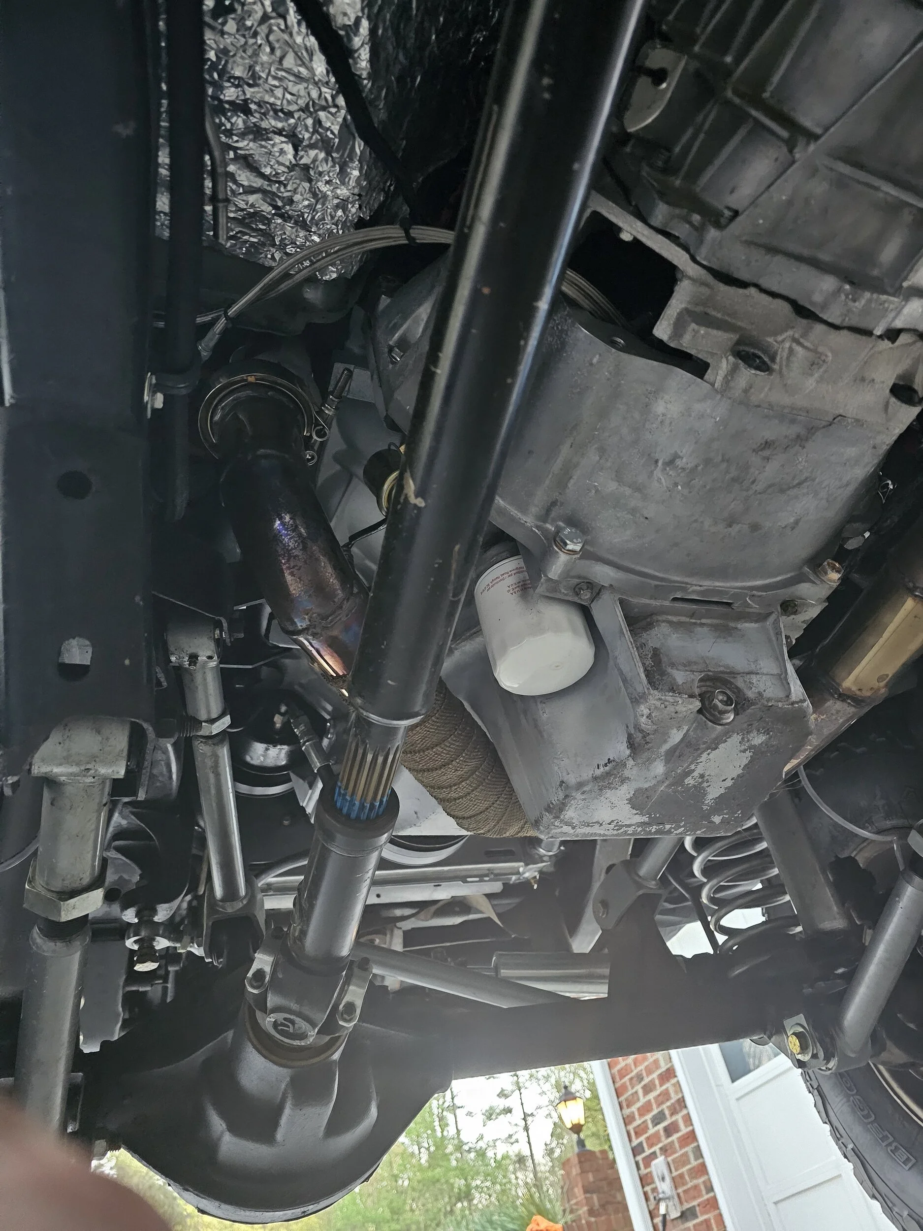

Let's back up a bit and talk about this TR6060. Any photos of that setup?
Sure thing....
I used a comp engineering universal transmission mount to get it off the skidplate... I got an upgraded 231np from a shop in NY ... Had to get an ls6 flywheel... to fit under the bellhousing. (4.10 yukon gear and pinion) Tom Wood driveshafts. they are just worth the money)
had to mount it about 3/4 inch forward ... motor mounts went in ...in the same factory position..
I'm getting ~20 to 21 to the gallon on the interstate... about 1700 rpm at 70mph... 15 to 17 in the city, depending on how street lights are.
