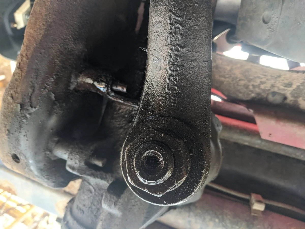

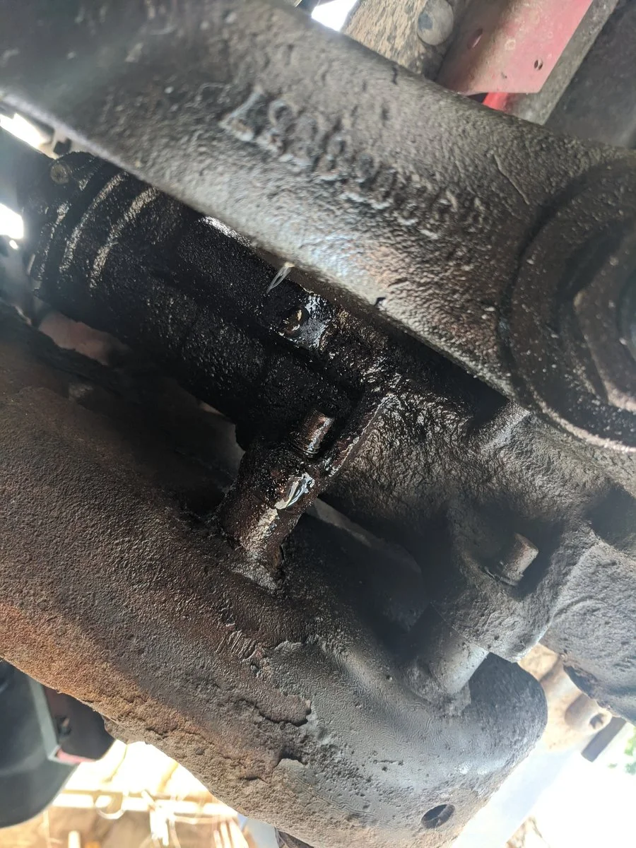

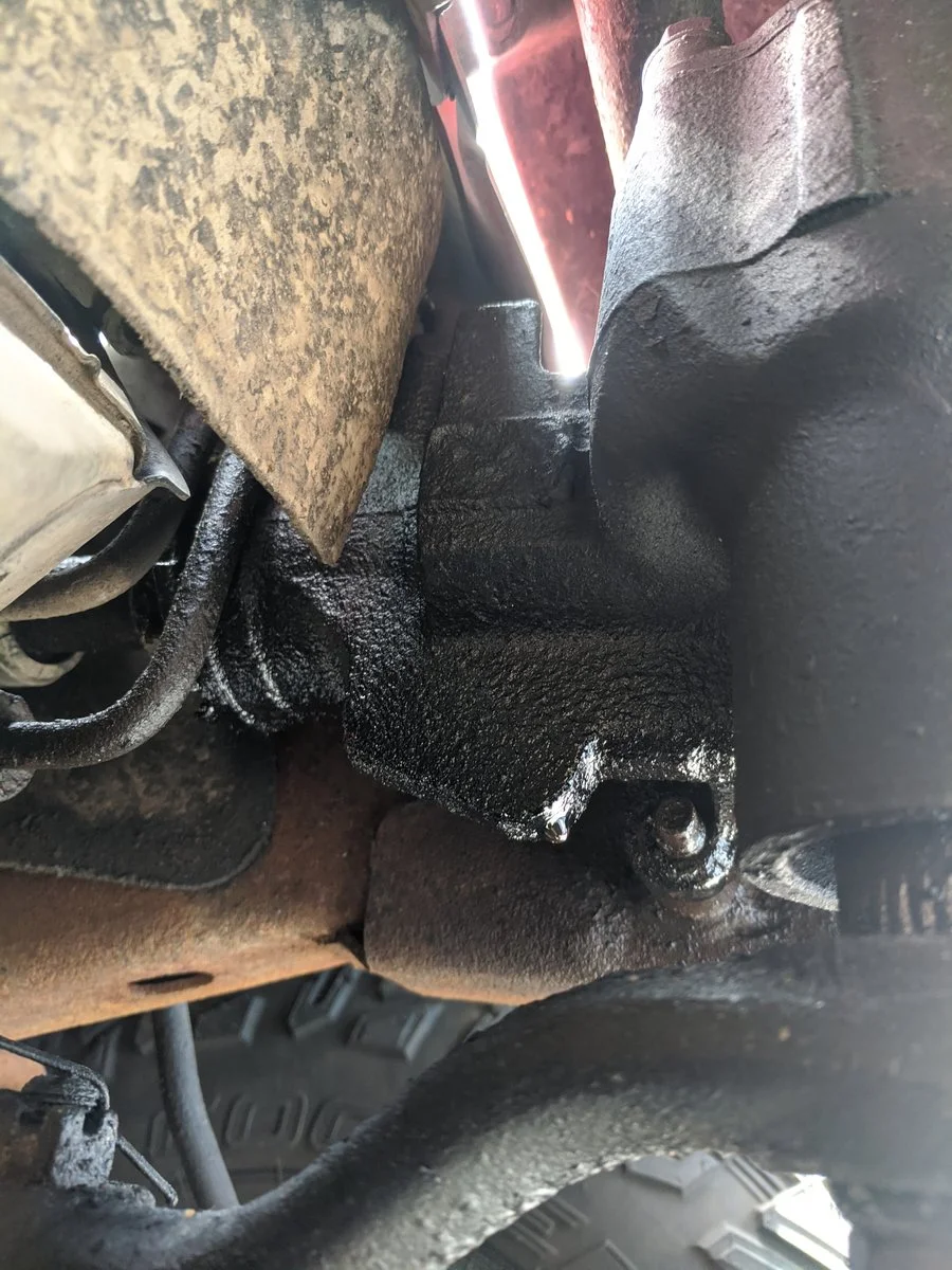

Also, I sent pictures of some type of leak to my mechanic via text, he said that it is a steering gearbox that is leaking and to check the power steering fluid, but the reservoir looks full. But the pictures I sent him (and will link) look damp, but with no puddles under the Jeep. So not sure what's up. Could I get some input?
Since the steering box is only damp in appearance; it's not the output pressurized line and probably just the return line wheeping. You should check both power steering lines and the pump to verify what is leaking.

And any leak, try and wipe it down real good and then take a look at it. In that case you could clean the area with solvent, wipe it down, start it up and turn the wheel back and forth then go underneath and check again.

As for the leak, get the whole area clean first. Use either some engine cleaner or some other type of heavy grease cutting cleaner and get the area as clean as possible. Leaks are often not where they seem to be. Especially with the fan blowing air all around. When the area is clean it will be much easier to correctly identify the problem. If you can identify the fluid that will help too.

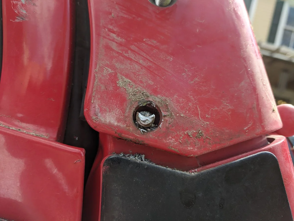

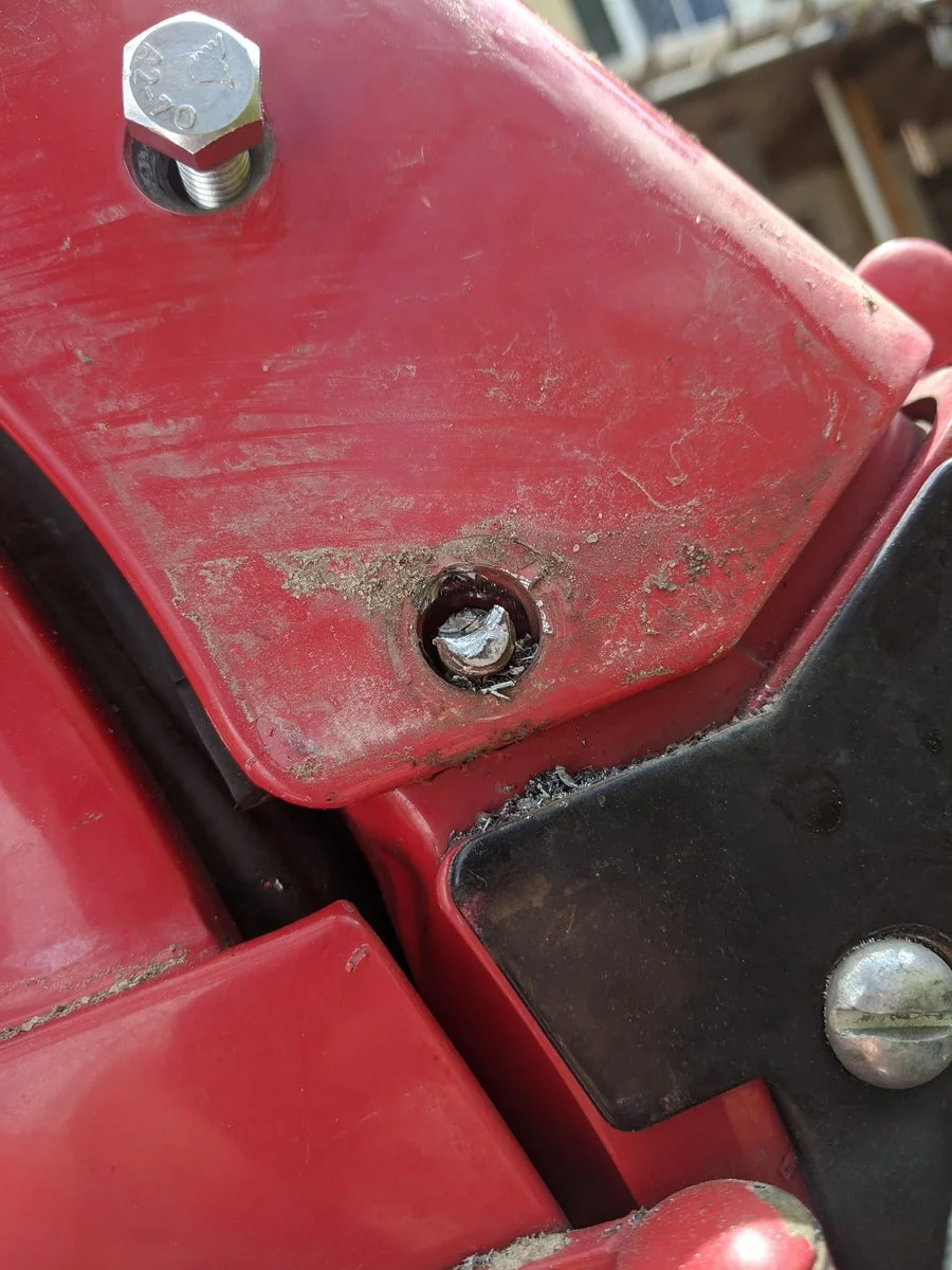

Also, I finally took off my lightbar that came on my Jeep when I bought it. Only problem is that one of the bolts holding the bracket on was seized on and so me and a friend drilled it out and ended up with the picture below. Any idea how I can clean this up? I'm sure I'll need to retap it but if not could I clean it somehow with an internal thread cleaner? Not sure what my options are, the bolt is still stuck in the hole.

The bolt is not for automotive, you might want to go to an auto store and get the right bolt for it.

The bolt was there when I bought my TJ, it was the one that came with the lightbar bracket apparently. But when I went to remove the lightbar bracket finally that one bolt was stuck. A friend and I ended up drilling out the head just trying to get the bracket for lightbar off. Now I have the thread end stuck in the hole. I need to find a way to extract it but this I am not sure of, then I need to find a way to clean the interior threads of the hole, I would think I would need to retap it but if there is another way then could someone suggest some options, please?

No need to re-tap. There is a tool kit drill-bit bolt extractor for that (I bought one in Menards).
