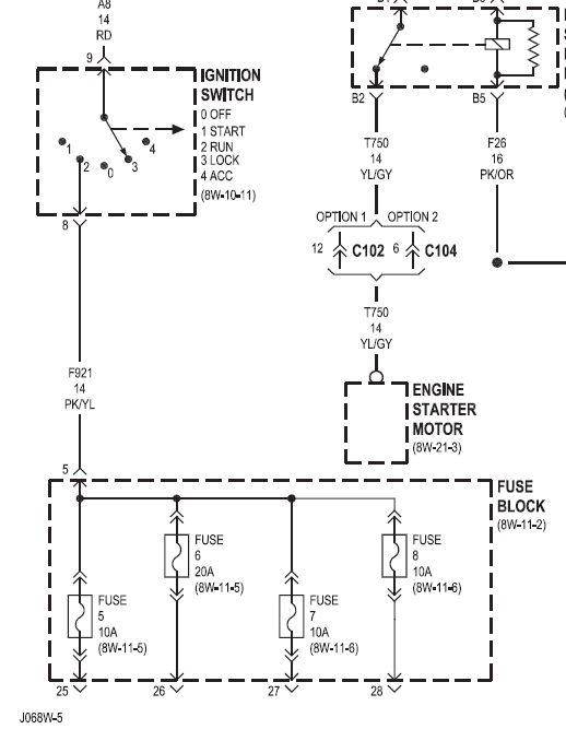

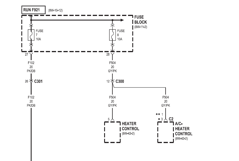

But with the engine running there is no voltage at the grey/ pink wire (this is where the override to the AC compressor switch is installed or any of the Grey/ pink wires}, hmm so I busted out the workshop manual Section 8 Wiring.
It is not your typical road map style wiring diagram.
So I had to sturdy it for a bit to see what is what.
Looking at circuit C
PDC The AC Compressor Clutch Relay has 13.5 volts with the key in the run start position engine running.

The problem is not getting any voltage thru the grey/ pink wires to the switches.
That is why I was hoping to have Mark explain how the ECU controls the AC system.

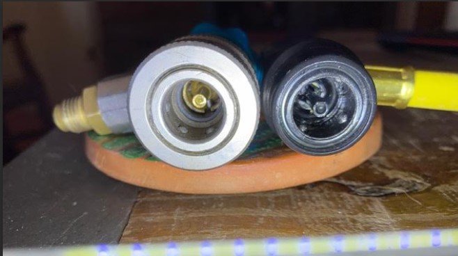

Ok I figuered it out.
My AC manifold which I have had for 15 years,the LPS fitting did not press down deep enough to push the schrader
valve down.
The one on the left is one for my manifold on the right is one that came with some freon I purchase off Amazon.
Hooked up the plastic one and was able to see that I only hand 5 psi in the LP line.
Then I put in a can of freon and the compressor kicked on,
