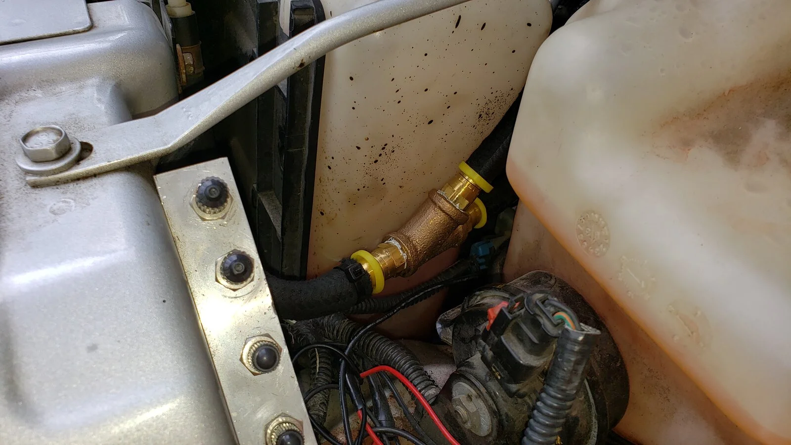

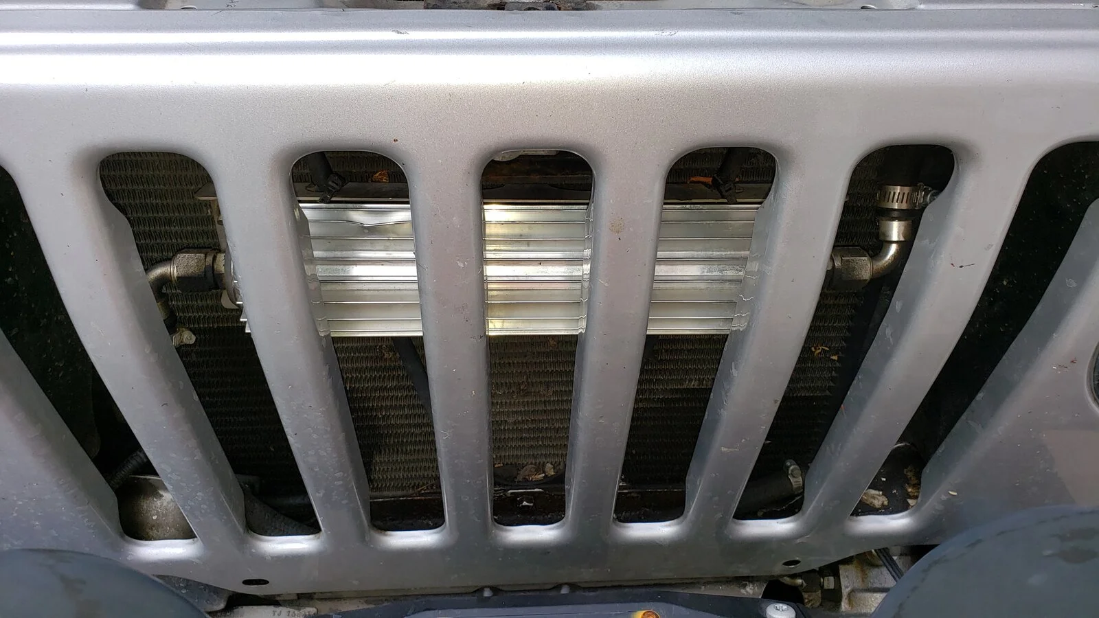

You can reuse the factory feed line, though you'll need to bend it a bit. You'll need some sort of return system and power steering cooler such as the one that comes with Blaine's bolt on ram assist kit.
You will also need some sort of tee or wye to split the return hose into two smaller 3/8" hoses. The reservoir has two inlets, as it is intended for use with hydroboost.

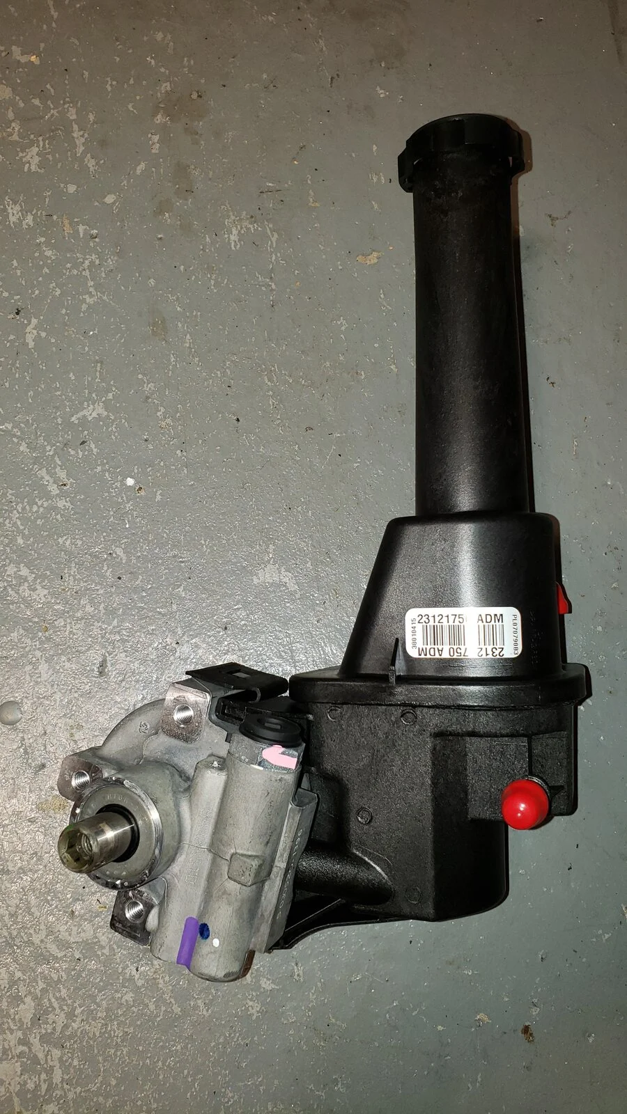

Here is the pump:
You will notice two immediate issues with this pump: First, the bolting is different. Second, the filler neck is too tall to fit under the hood. We can fix both of those.
Using a drill press, drill out the first and third (but not the second) holes with a 5/16" bit. These must be square to the pump face, and drilled through to the other end. If they are not square, you will have issues mounting it. Your factory bolts should slide through without binding.

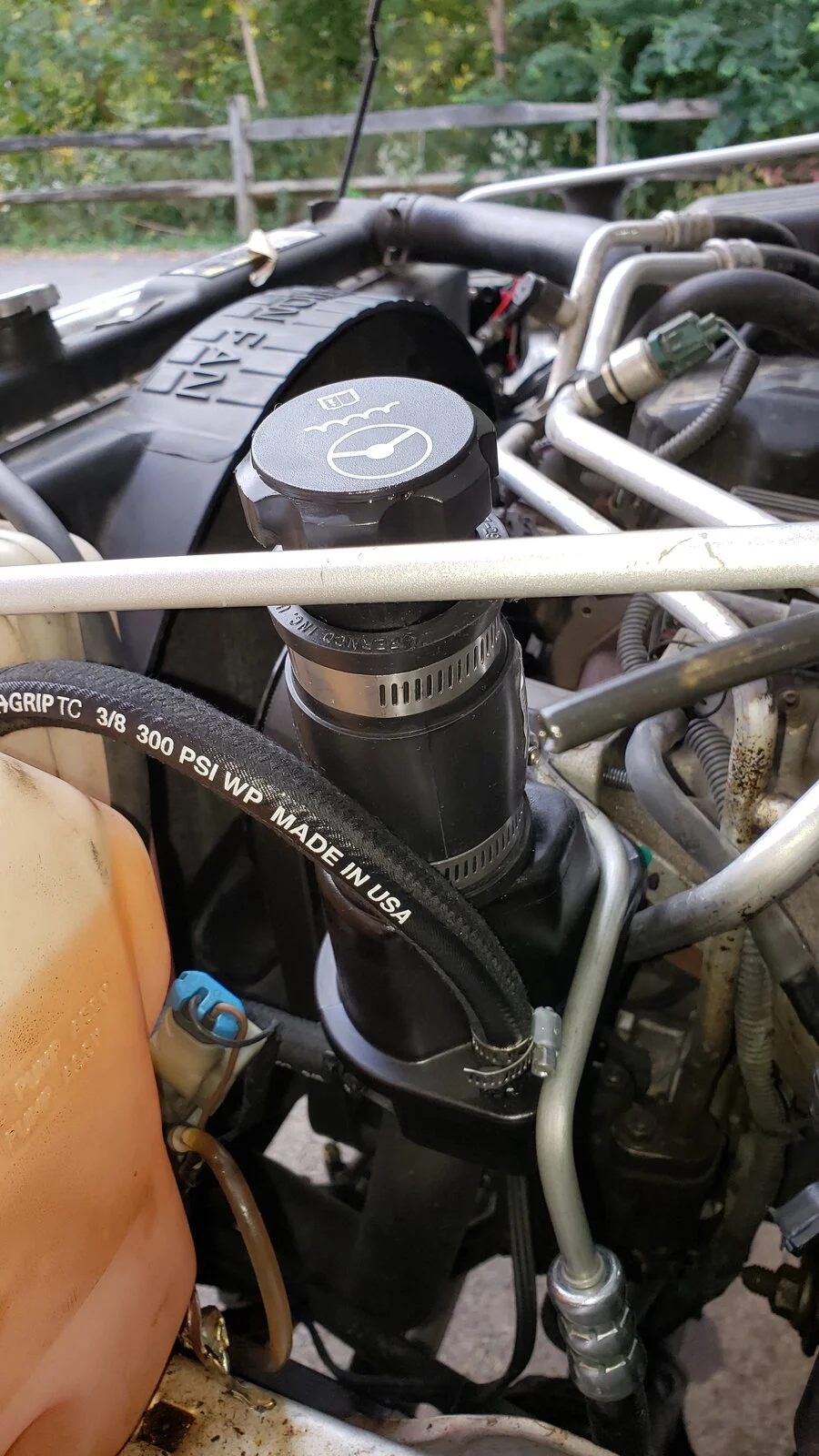

Take a saw and cut 1 to 1.5" out of the center of the stem, enough to clear the hood. Make sure no particles get into the reservoir, and if they do, clean them out with reckless abandon. Using a 1-1/4" pipe coupling and some oil-safe sealant, reattach the ends of the stem. Shorten the dipstick appropriately.

And that's pretty much it. I'll assume you can figure out the return plumbing. Be sure to add online filters somewhere in the return, as the pump reservoir only has a screen. Spend a lot of time properly bleeding the system prior to the first start.

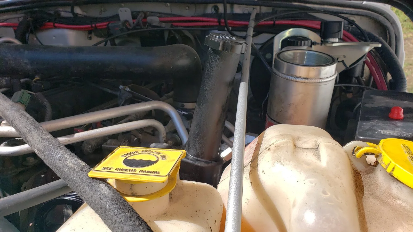

Here is my assembled spare pump:
This one I drilled out with 21/64 to try and more closely match the stock pump hole sizes. If the bolts don't line up, I can enlarge one or both holes to 11/32, which is just under the hole size PSC uses.
Ignore the bad countersink job.
This time I left the reservoir installed while drilling the holes, which made the entire process much quicker.
Be sure to use an inline filter on the return line, as these reservoirs only have a screen, and not an actual filter.
