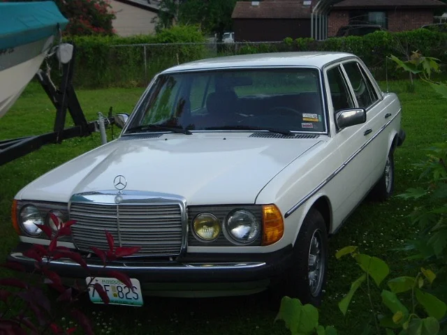

You have the 5 cylinder diesel benz 300D? Turbo? My first car was a 1977 300D, non turbo. 0 to 60 in 24.8 seconds, I kid you not, but that car pulled a horse trailer with 2 horses without an issue.
I grew up with, and learned to drive on, a '71 220D with manual. As an adult, I had a '74 240D auto, and now the '85 300SD auto (with turbo) that I've owned for the last 20 years. I've driven the non-turbo 300D, but never owned one. I liked the '74 the best, even with the auto, but it had a VERY bad case of cancer. But when I hear people complaining about this or that car being "underpowered", my response to that is "Pfffft!" Try 68 HP in the "uprated" 240D engine in a 3,400+ lb car - and I never really felt "underpowered", although you *do* need to know how to drive one of those old naturally aspirated MBZ diesels. My 300SD is about 120 HP, which is PLENTY, even with the slushbox.
