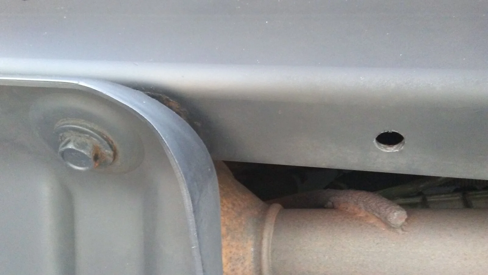

This stuff will take that undercoating off without scraping. A car wash hose alone won't take it off. I bought a Jeep that the PO sprayed that crap on. I dumped the Goof Off Pro strength remover on it and the undercoating dripped off. You would need a brush to spread it. My Jeep had slight rust at the skid plate from water sitting there between the skid and frame. I dropped the skid enough to clean it up and painted my entire frame with Walmart cheapo stop rust paint ($1 a can) and drilled 4 drain holes in the frame, so any water just drips out.
p.s. That rust didn't look that bad.View attachment 191598
Thanks Boogieman for the suggestion / tip and the detail. Much appreciated. Nice picture, btw. Frame looks great.

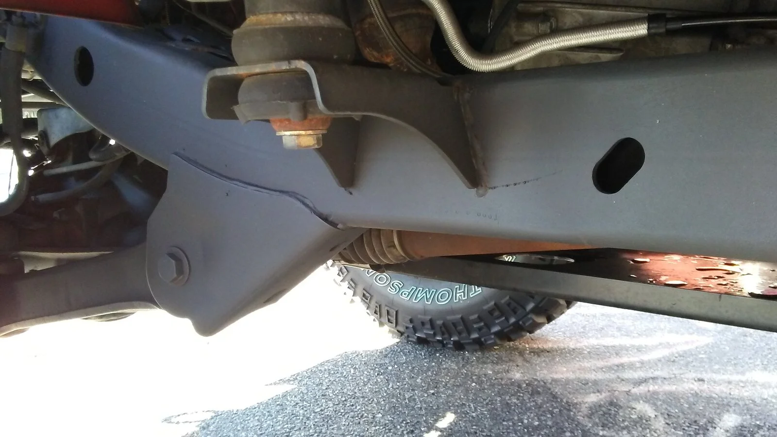

View attachment 191601View attachment 191602
