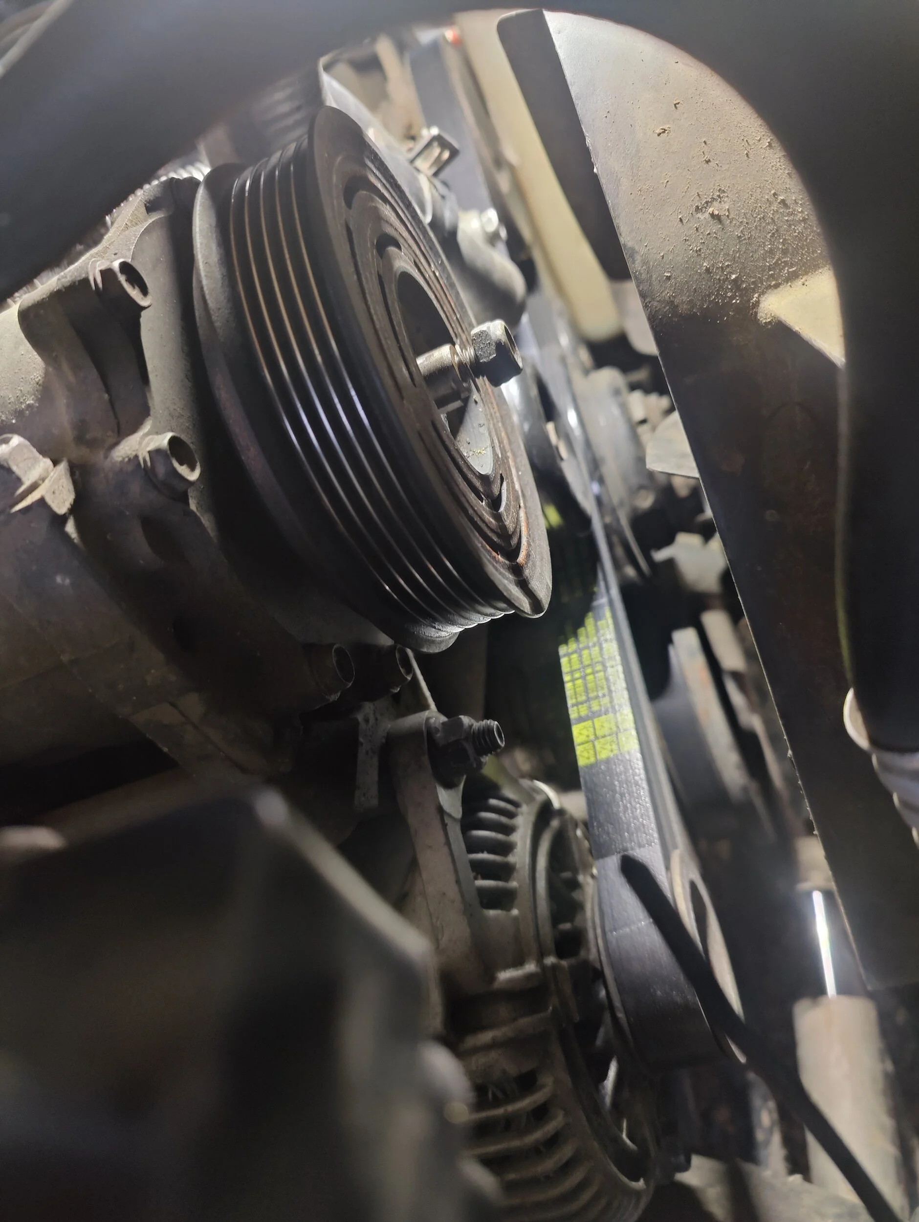

Either I burned up my alternator or the AC compressor for which I removed the clutch is making noise. I have a new compressor but not sure I'm ready to invest in charging the system. I believe the compressor came filled with the appropriate amount of PAG oil. Am I ok to swap it with the clutch unplugged without charging it for a while? Damn thing is expensive and I don't want to ruin it.
Or should I just pull it and get a shorter belt for my 97?
-Mac
Damn it's the alternator. Back to Zilkowski's auto electric on Monday.
Gotta be better about maintaining 2k rpm when winching. My pet theory is my Optima Yellow Top doesn't have enough ass to float high amp draws.
-Mac
