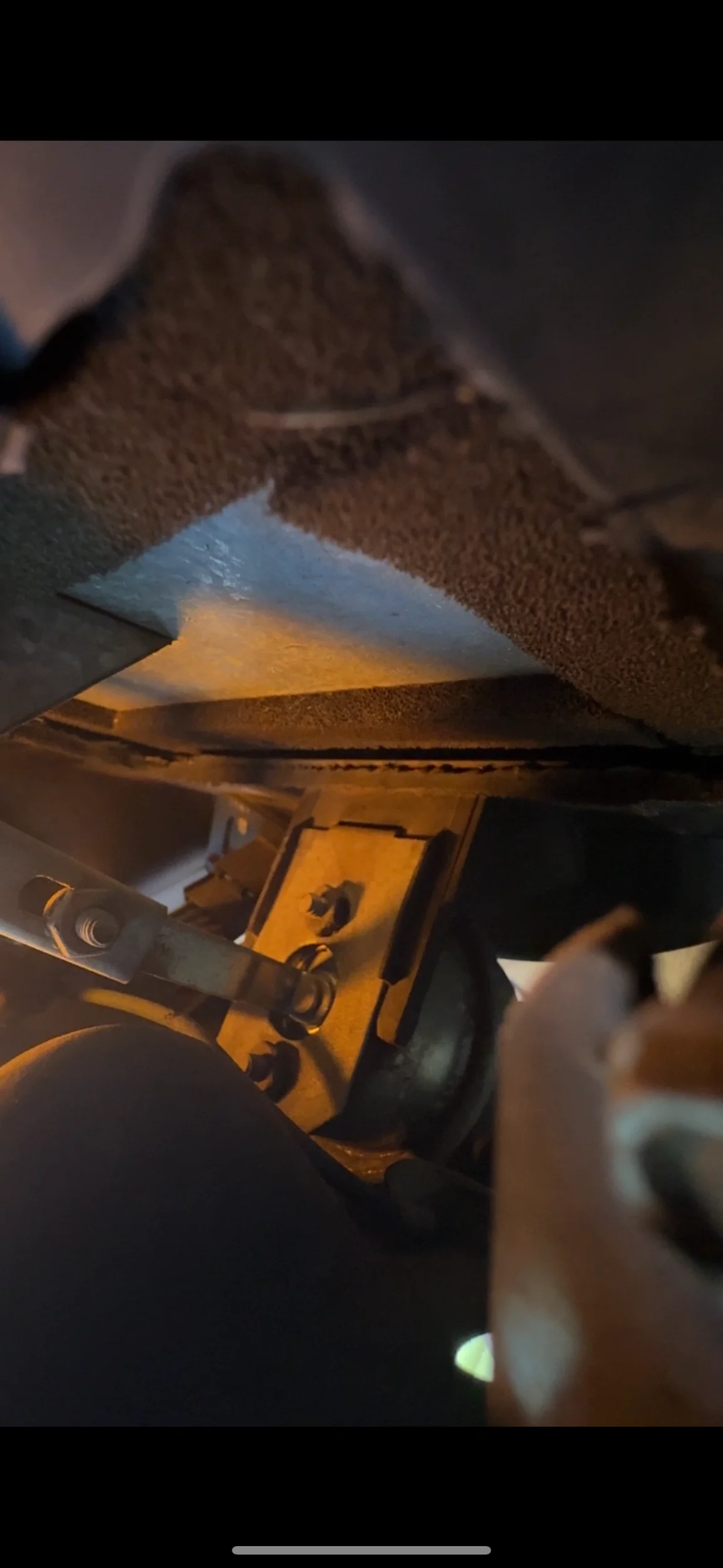

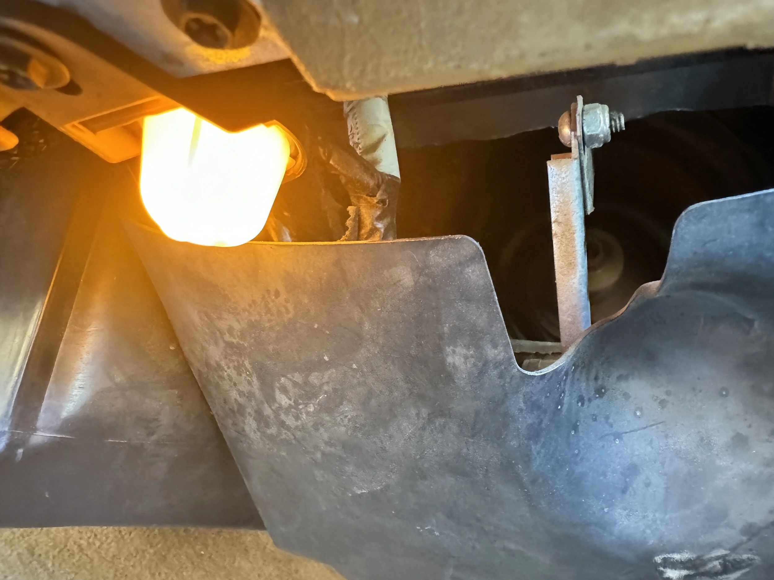

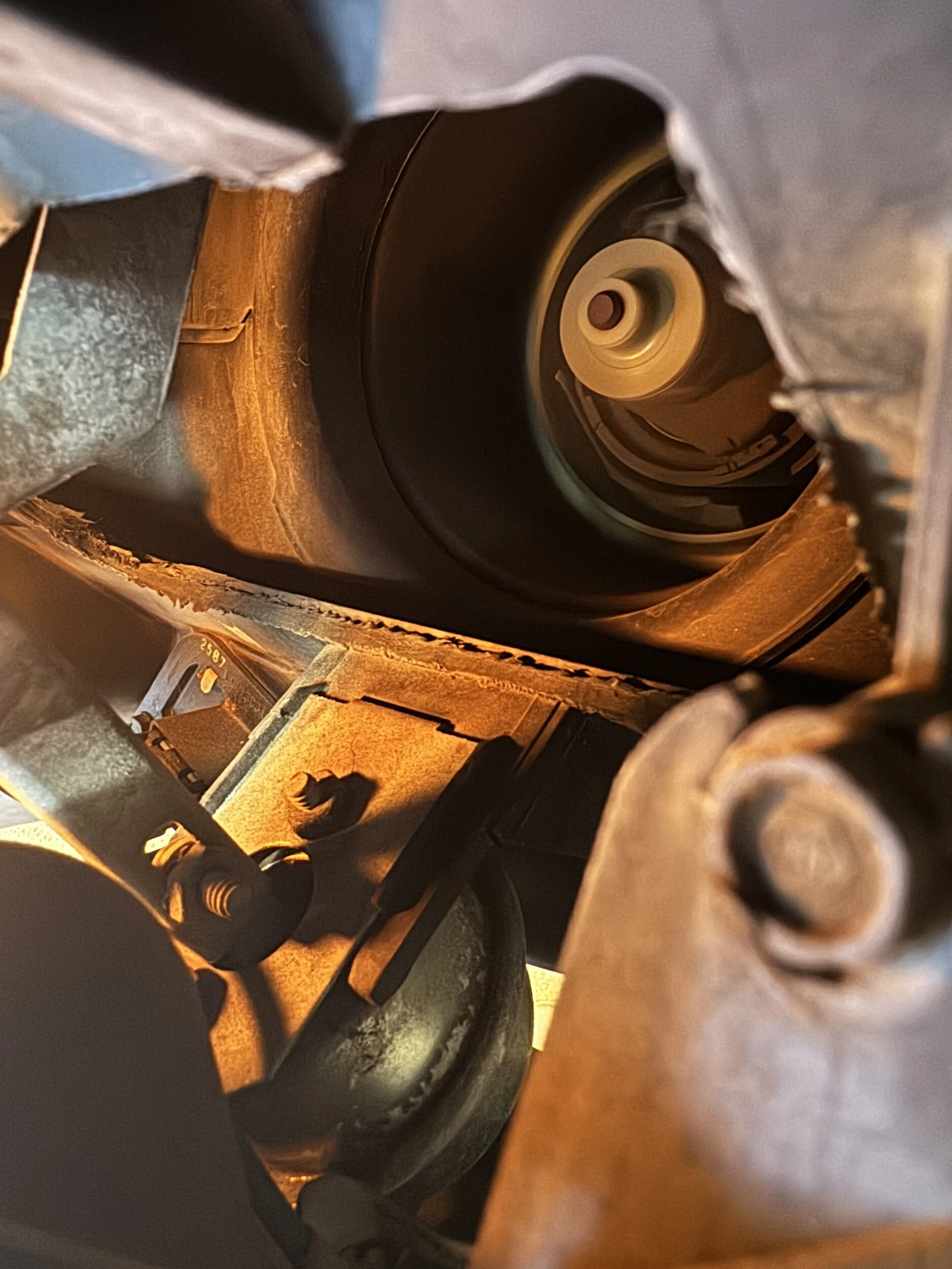

The doors don’t seal real well, but where the air come out has no relation to temperature. Temperature is regulated by the blend door. A picture of the hole in the air box would be helpful.
Easier to hook up a vaccum pump to the connector on the firewall, use the pump to generate vaccum...one...see if it holds pressure and two...see if you can accuate the doors.
Hole doesn't sound normal. Not on my 97.
Sounds like you might be pulling the HVAC box.

Here’s a couple photos. The hole I was talking about that looks cut in has a flapper, seems to only be open for the dash AC setting, I assume this is air re-circ?
