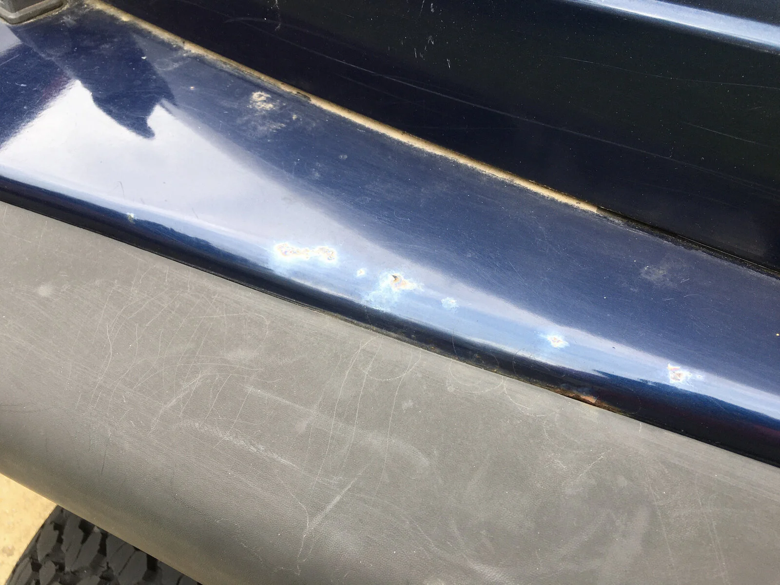

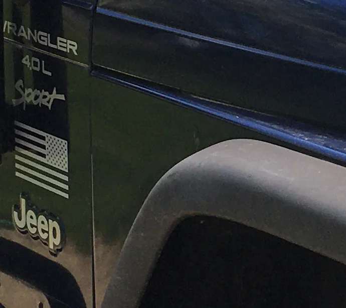

I had my 2001 TJ painted this past summer. Within about two months, I saw some rust spots coming through on the d/s fender, and p/s front quarter panel and rocker. This wasn't really a paint defect, but I brought it back to the shop anyway. The attendant went through the options such as replace body parts, repair body parts, etc. Anywhere from $900-$2000 in work. But his ultimate suggestion was to do nothing and see what happens. Suggested that, instead of replacing the fender with an OEM version, remove it and install an off road version. Kinda said that rust is like cancer: sometimes it spreads, sometimes it doesn't. Kinda gave the warning that I might go bonkers chasing body rust on a Jeep nearly 20 yrs old...
I POR-15 the frame nearly every year, so that's what I really care about. Sure, I can find a good deal on some body panels over the next year if it gets worse, but I'm not really sweating it.
