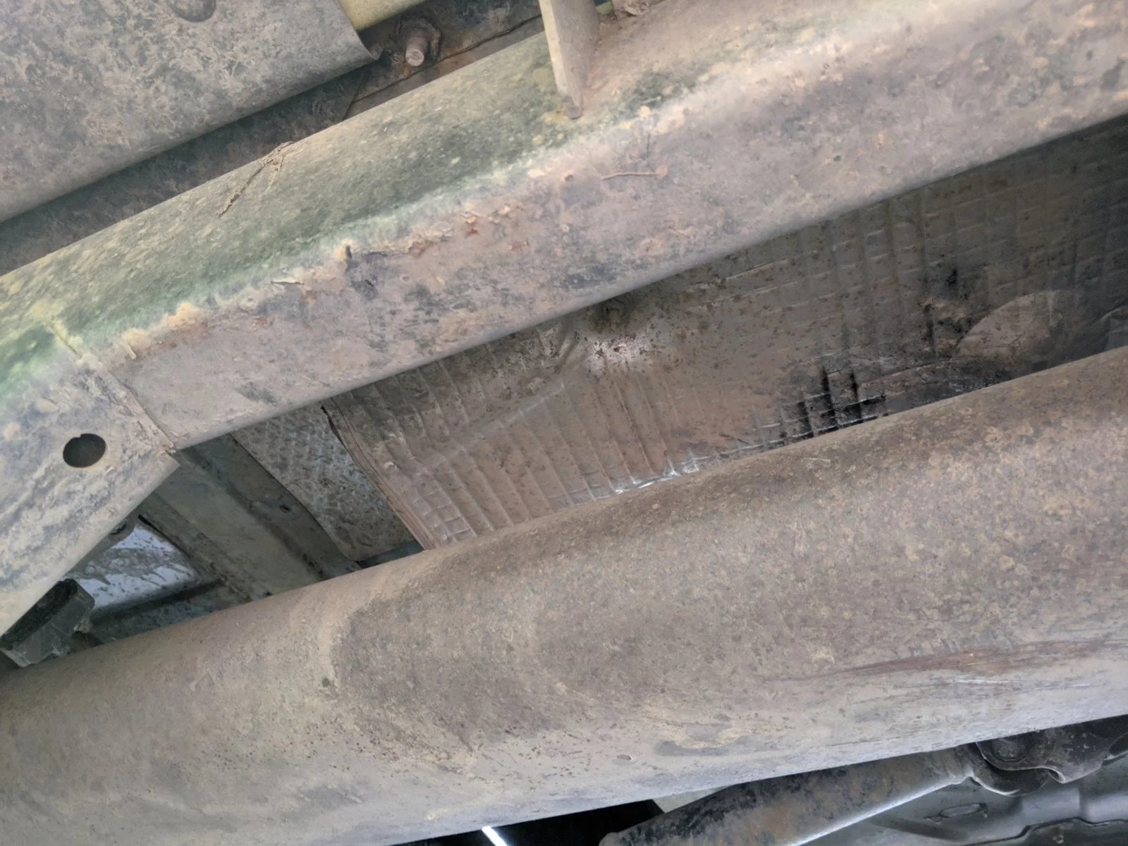

Based on those pictures I'd look for any flakes of rust sticking out from between the skid plate and the frame on both sides and stick my finger in every hole in the frame that I could to find out how flaky it is in there. Almost every TJ has some flakes somewhere but how much is what matters. I'd bet this one is probably fine.
I also noticed a JEEP GIRLS ROCK! sticker under the tailgate and a cute little puppy hiding the license plate. I'd say those are pretty good signs that it hasn't been abused.
If you don't have a camera to look inside the frame, a cheap $5.00 flexible/extendable magnet can really help you investigate a bit further than the areas you can only reach with your hands.

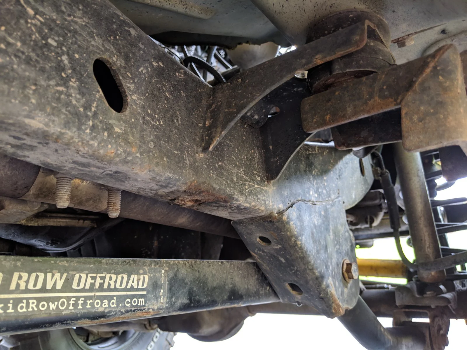

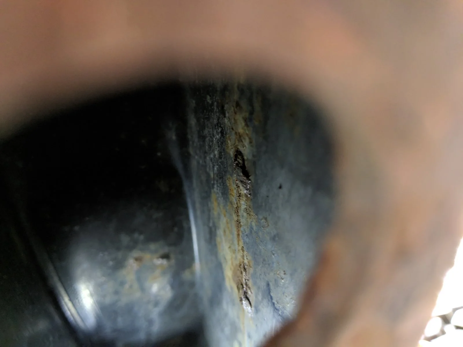

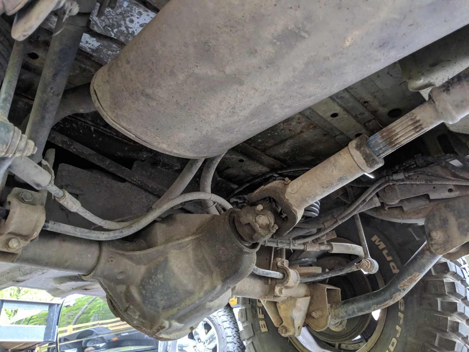

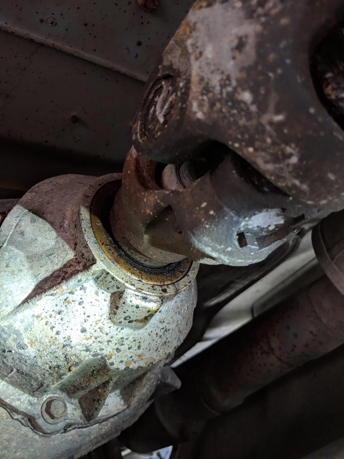

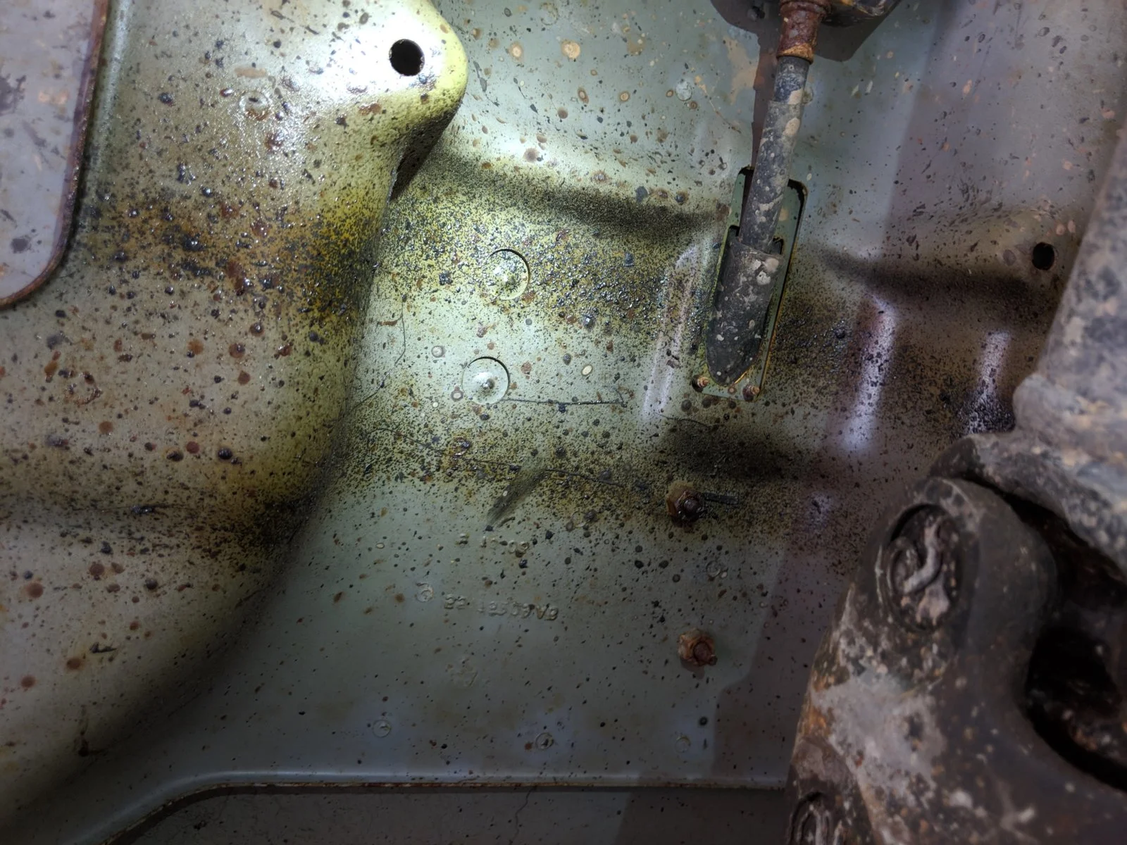

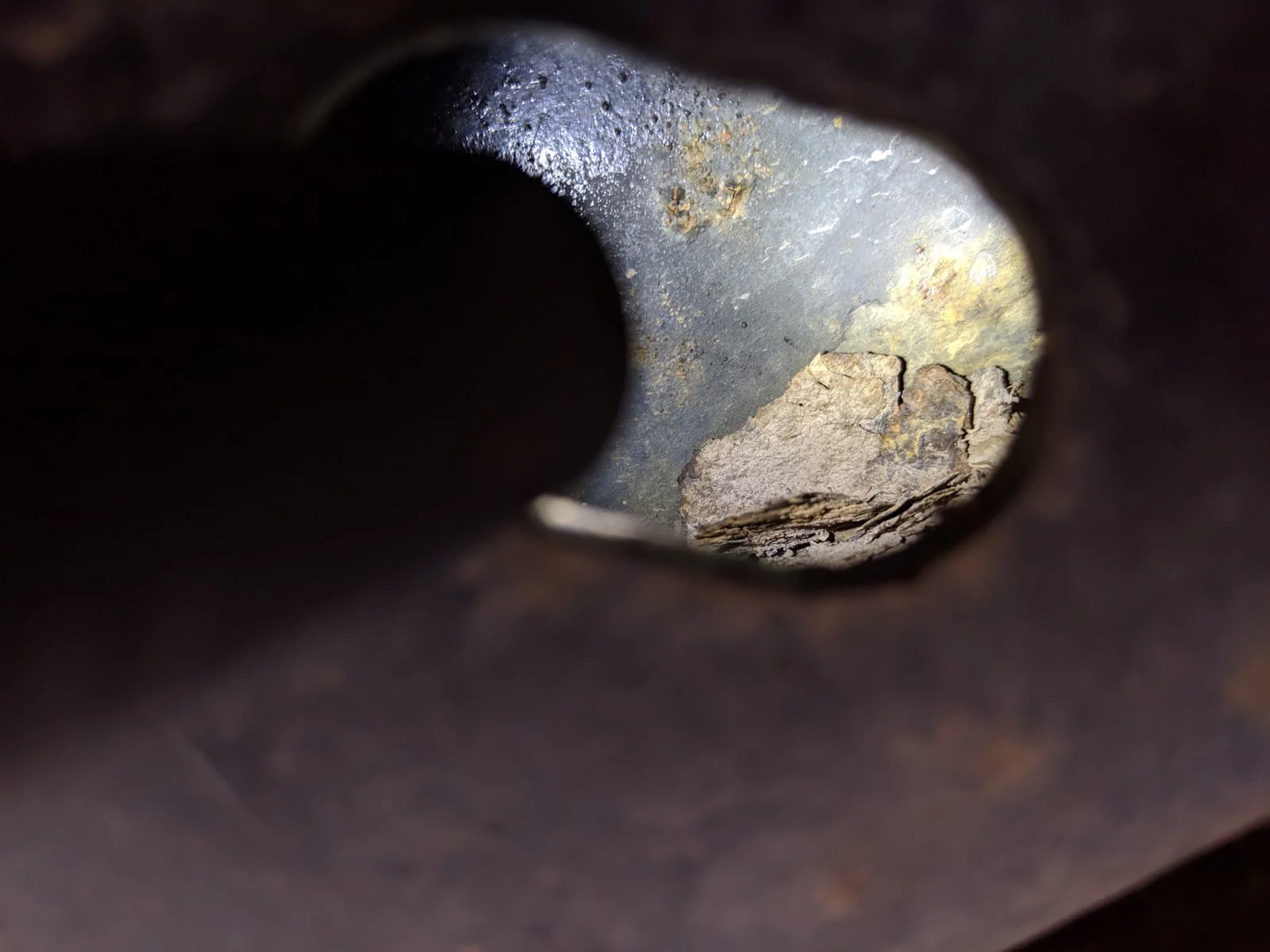

Here are some pics of the underside

Looks pretty good. Double check the insides of the frame where the skid plate attaches.
The fact the frame is not painted\doctored in an attempt to hide rot is a plus. What I see from the photos just looks like normal surface rust.

So the history of the vehicle is when the lady purchased it, it had 173k, had never been offroaded. She has offroaded it twice since getting it 2 years ago, the rest have been local/highway miles.
What do you guys think price-wise? Does $11.5k still seem fair after seeing the underside?
Also just to clarify, I expect to spend some money in maintenance, and I want to do my own maintenance I'm hoping to learn a lot from owning a Wrangler, I just don't want to get into a money pit situation. And $11k is pushing the limits of what I wanted to pay just to own the Jeep, I expect to put a few k's into it over the years in maintenance.
There's nothing wrong with communicating what your comfortable limit is to the seller. The worst that can happen is a no. Then you can decide if you want to stretch your budget, or keep looking. The best that can happen is you drive away with the LJ.
It is an LJ and that will cost you, if you don't need the extra space then a TJ will be less expensive. I don't think that this is a bad price for this jeep, as long as you accept that at 175K you might have a bigger ticket item to replace.
